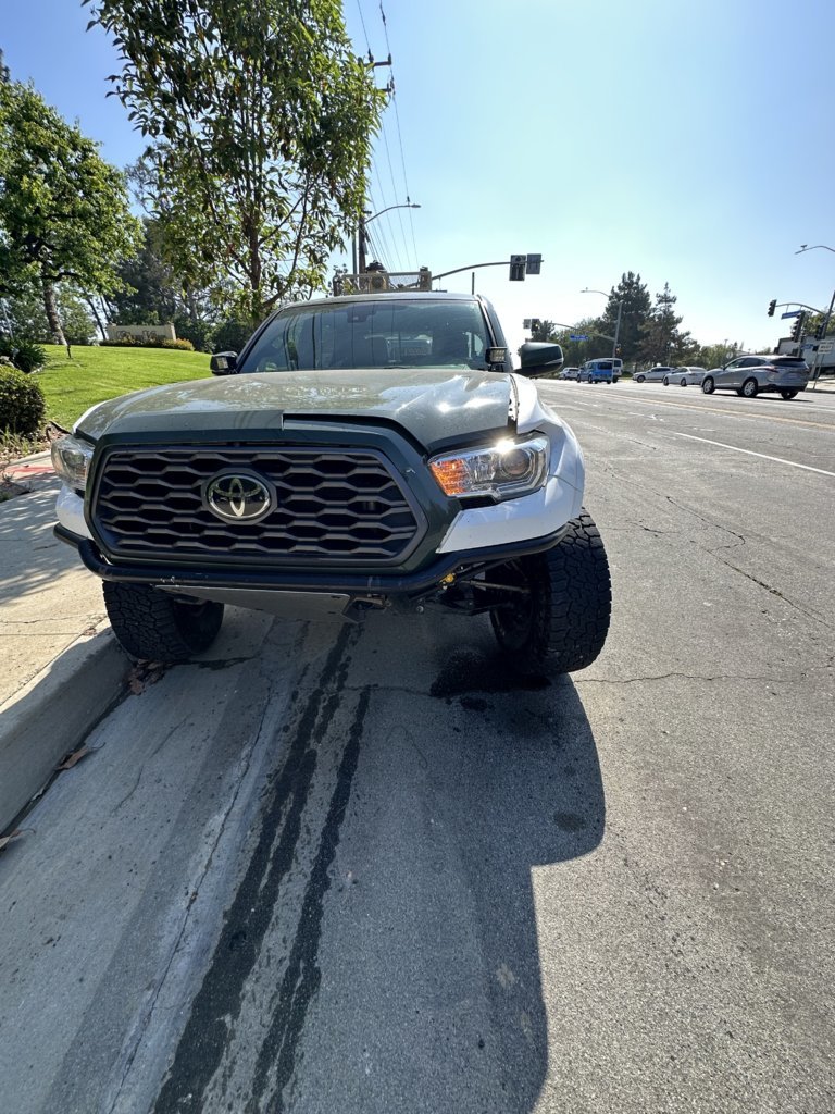

    Hello everyone I recently started developing a loud creaking / popping noise. The noise can be heard whether in drive or reverse and it’s most prevalent when turning the wheel. On top of this noise there is also a new squeak that has started and it’s noticeable when driving on flat surfaces.
    For some context the noise started a couple days after I received the truck back from a reputable shop. I rear ended someone upload_2024-10-24_11-12-3.jpg
    The damage wasn’t too extreme. The offroad shop was able to look over everything and fix all the issues. When asked they even advised me that my uniballs and UCA/LCA bushings still had some life in them and they didn’t need immediate replacement. They also performed an alignment and it’s been driving great.
    since the sounds have started I also went ahead and sprayed some tri flow lube on the upper and lower uniballs and hit the UCA/LCA/leaf spring bushings with silicon lube hoping it would do the trick. Unfortunately the sound did not go away nor did it get any less quieter after.
