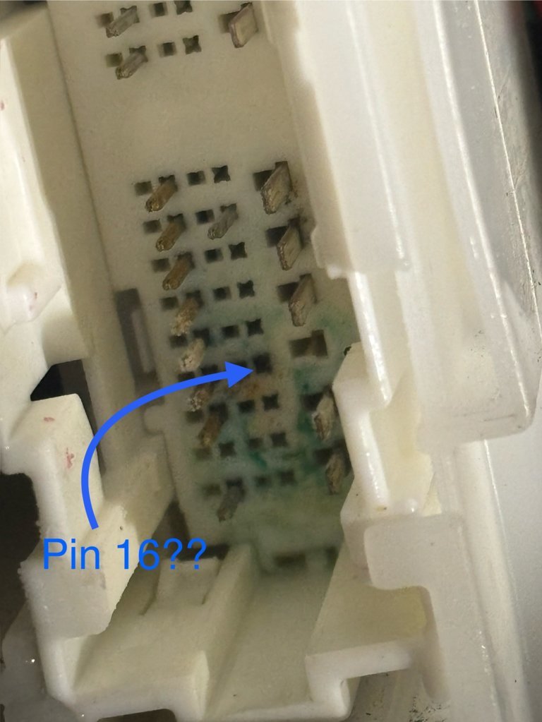

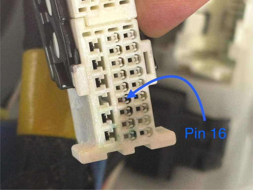

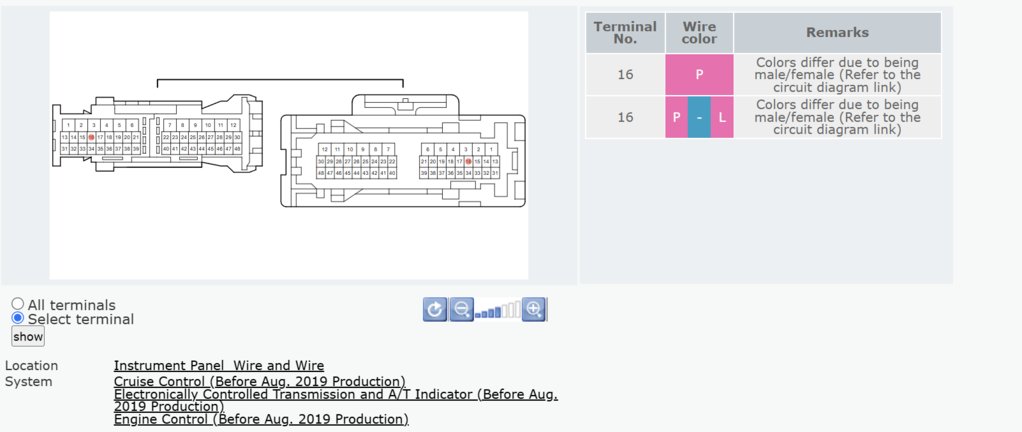

    Ok it is worse than I thought. Pin 16 is already broken off and after some light cleaning the surrounding pins look pretty bad as well. I've pinned my fair share of deutsch and weatherpak connectors, but I'm not sure how to proceed here. Pick up the proper pins and tools from a dealer? If that is the best course of action I can't figure out what P/Ns correspond to what pin.
    Edit: I imagine pin 16 is the smaller "0.64 II (Non-waterproof type)"?

  3. Jan 7, 2025 at 12:35 PM
    #23
    Dm93
    Dm93 Test Don't Guess
    Mar 3, 2015
    #150066
    14,000
    Texas
    2014 DC OR 6spd 4x4
    Predator tube steps, Ranch Hand grill guard, Magnaflow CatBack exhaust, Toyota tool box & bed mat, 2LO Module by @Up2NoGood, Rearview Compass/Temp Mirror, Tune by @JustDSM.
    Dang that sucks.
    @caribe makaira can probably help you with the pin part numbers, he's much better at figuring those out than I am.

    There is usually a number on connector.
    If you can get us that number. I might be able to find the connector in Toyota wiring data guide. If so, it gives pin type and size.
    See if you can find a number on the connector.

    See the file above, it lists all the pins and part numbers for that connector but doesn't specify which ones go where.

    1.5 for the large; 0.64II small ones...

  10. Jan 8, 2025 at 7:03 PM
    #30
    mtck
    mtck [OP] Member
    Feb 7, 2024
    #443346
    14
    Location: The PNW
    2019 Cement TRD OR /w 6MT
    The 4Runner runs again! Thank you @Dm93 for all the help, I think I'd still be trying to replace random components without your advice hehe.
    None of the dealers in western WA have the correct pins or pigtails in stock so I have some on order. In the meantime, I just bypassed connector FA2 with some 20ga wire. No CEL on startup and no codes after a drive cycle. Yay! My dad is elated rn, just have to put it all back together (and find the source of the water intrusion)!
