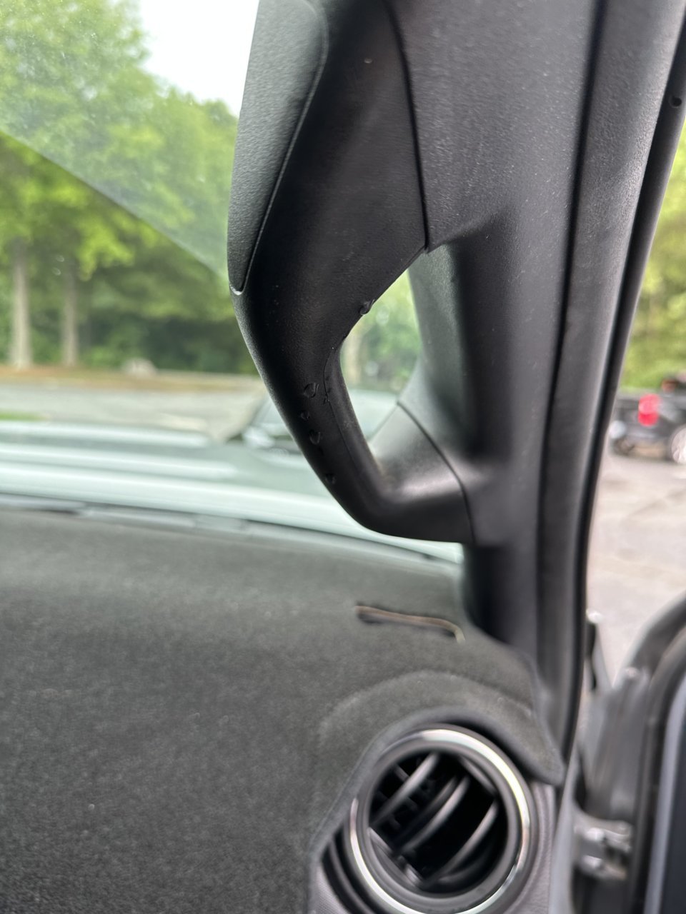

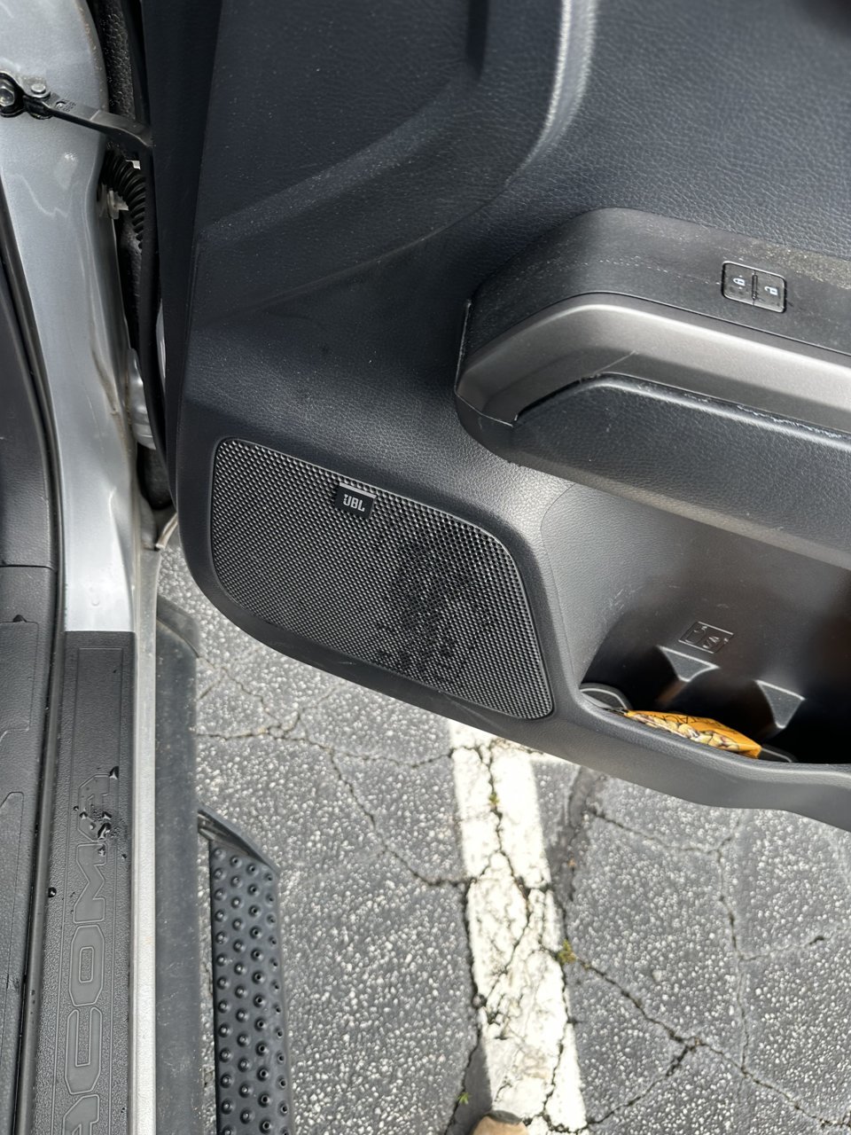

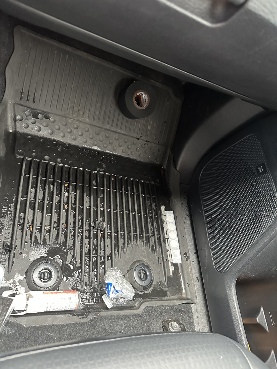

    Last night it rained heavy most of the night. I just noticed that my passengers side had a lot of water in it. I’ve never had water issues in the cab so I’m worried about it. The highest point I see is the handle having some drops on it, then a path going down. I felt the liner but it doesn’t fell wet anywhere. I do have a sunroof, and felt around but didn’t see anything. I do t have a roof rack, or anything attached to the cab. Any ideas or help would be greatly appreciated. Thanks in advance.

    Thanks for the links, I’ll check those out this weekend. I don’t think that’s the issue though, since I found water on my passengers side handle (o-sh!t handle). It’s higher than the window and recessed from it. I couldn’t tell if it was coming out of the screw cover though or was traveling down. I did check the sun roof drains and they seemed clean.
