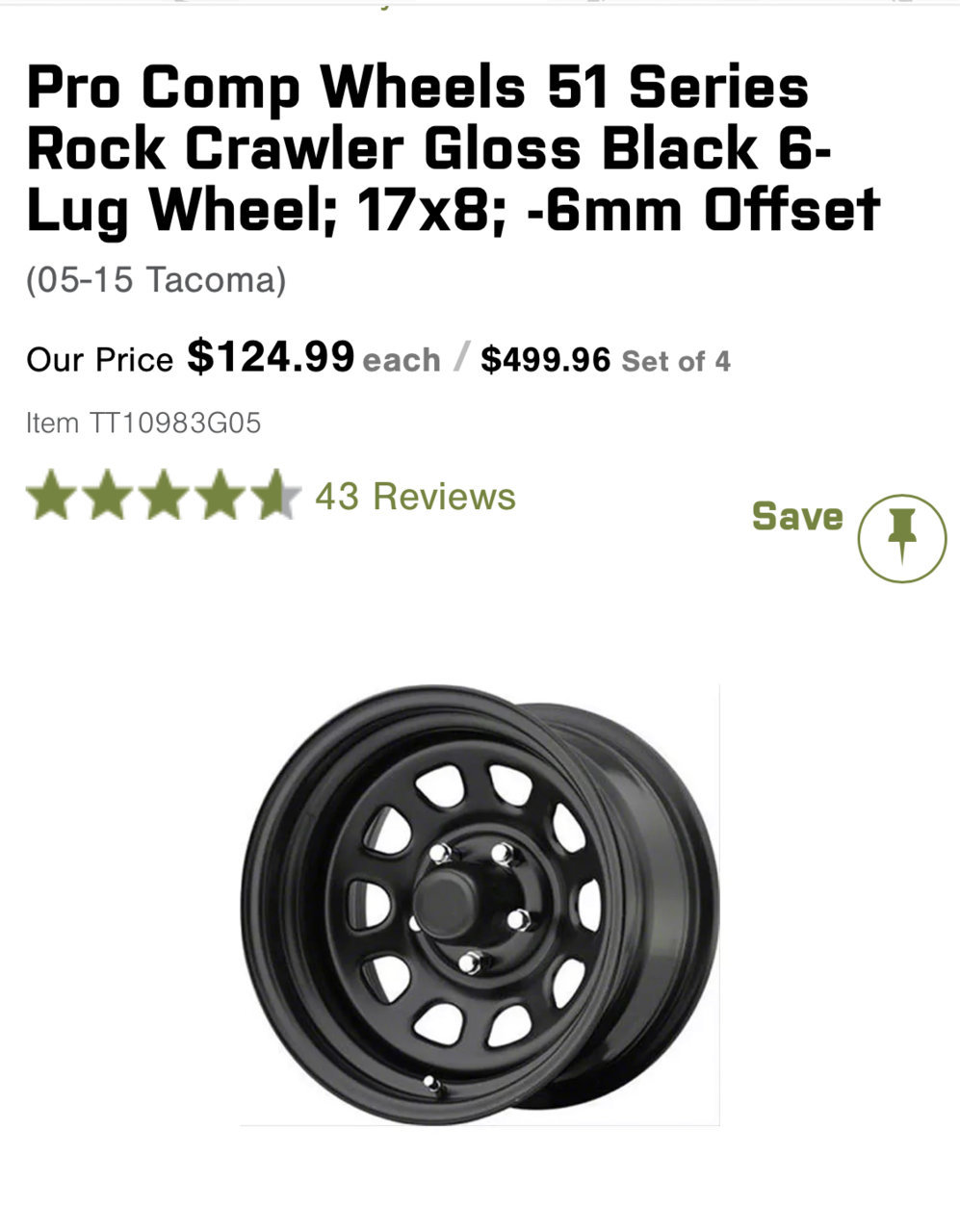

    I’m running 17x8 Pro Comp Rock Crawlers, and although Extreme Terrain claimed they would fit, they actually were compressing my calipers. I went out and bought Dorman universal spacers (just for the front) and they now clear.
    I’m not sure why some people rub with the D window, while others don’t.

    This makes so much sense! That’s exactly where I was rubbing. When you bought yours, did the listing claim they would fit. Extreme Terrain claims they fit, but in my experience (and apparently yours) it’s the lip that is the issue.

    I did the same thing. One thing I did notice was they came out of the box bent which could lead to rubbing when the fitment is so close. I just used some 1/4" spacers as well.

    1/4” exactly. I was a little worried that the mating surface on the steelie wasn’t completely flat, like an aluminum wheel, but the steelies are technically hub and lug centric in a way because it’s hub centric with conical lugs. I just made sure the lugs were evenly tightened to 83 foot pounds and there seems to be no issue.
    i was wondering if maybe the rims were a bit bent!
