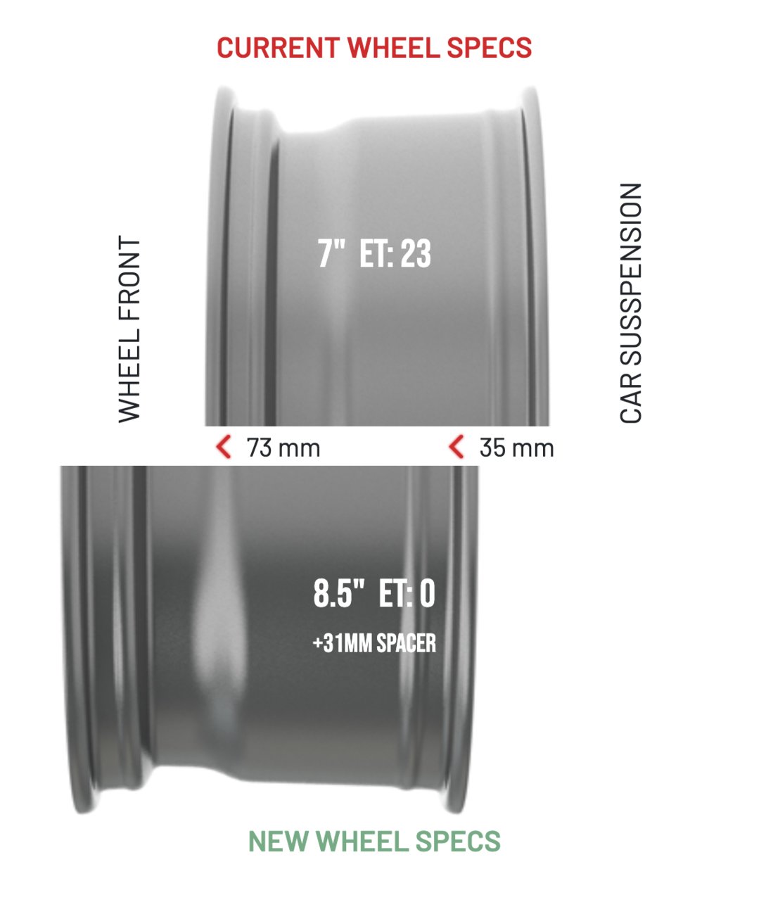

    No, it will be a wheel offset and spacer issue. I just didn't say it because he didn't tell us what the wheels are yet. ;) There's absolutely no reason he should be running a spacer on those wheels.
    If we assume he's running the +0's of the rhinos, check out the visualization of his wheel compared to stock for an example as to what's going on:

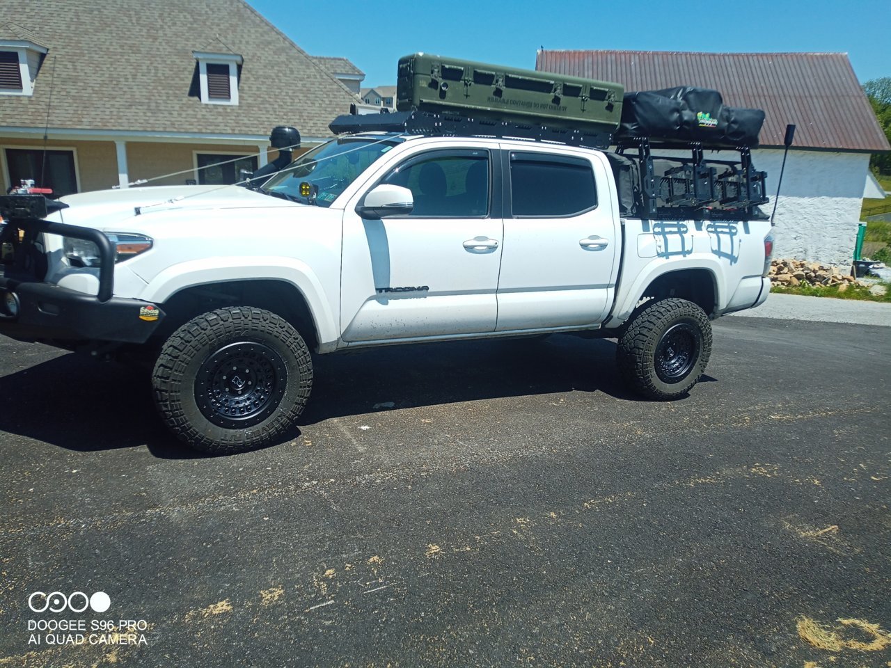

    Man your taco looks great!
