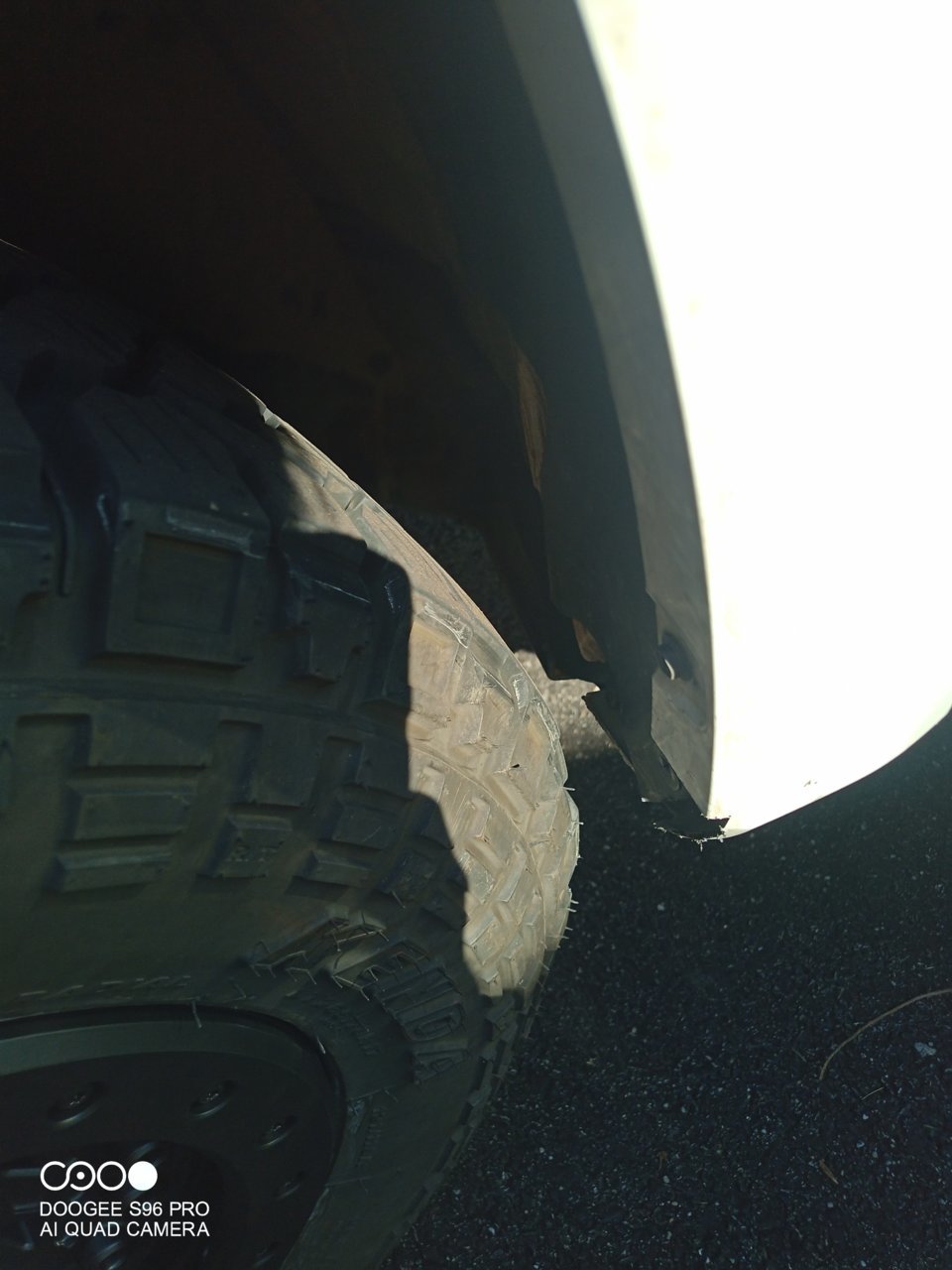

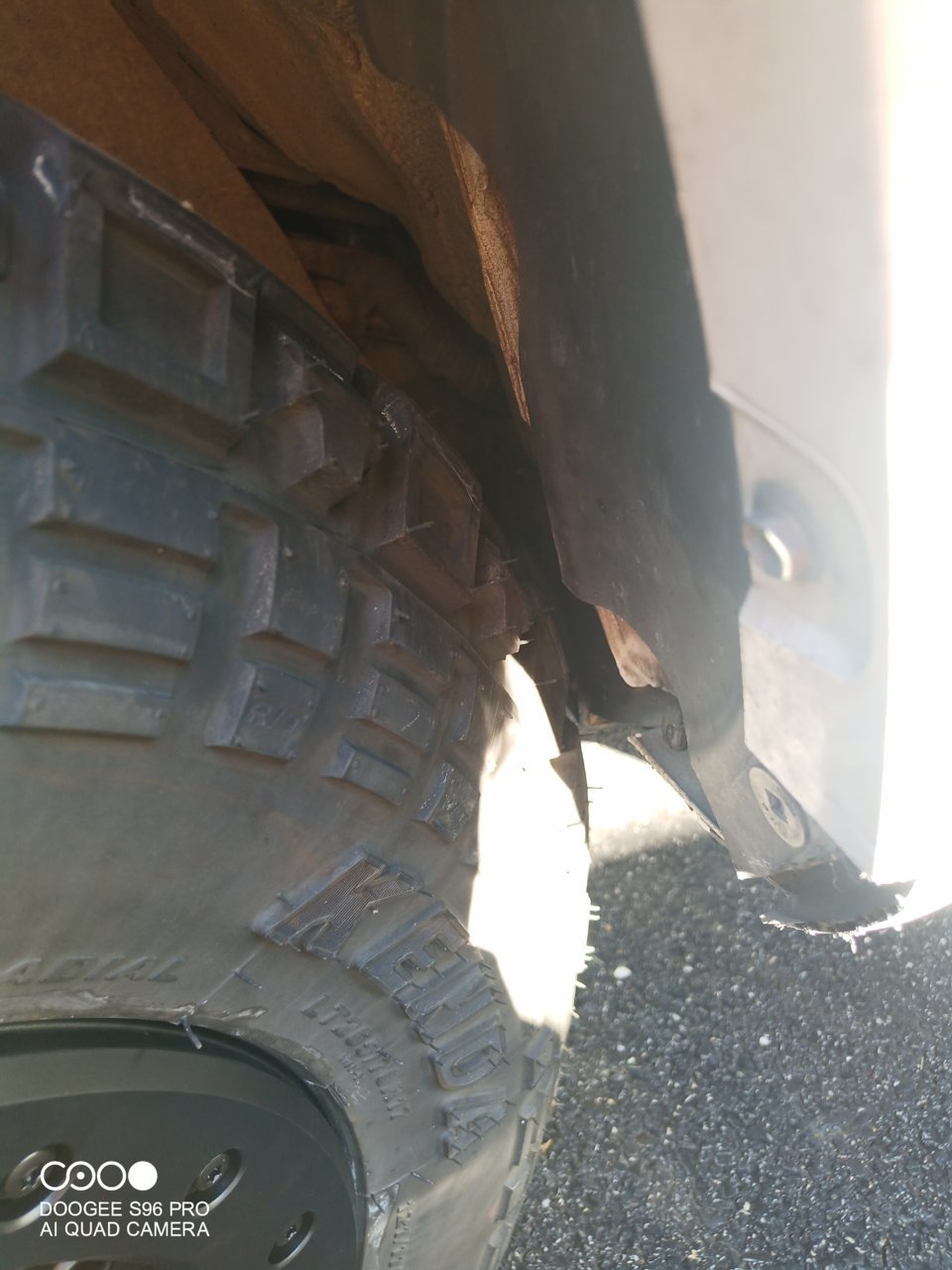

    The tire is rubbing the cab mounts or plastic area near the cab mount which I removed.. I'm about to remove the spacers. I'll start dropping pictures in a bit for a before and after. It only happens is I hit a steep angle with a almost full wheel lock. Just never been an issue before I had the new wheels (not tires) installed. Now the videos someone posted made sense that adding spacers increases my turn radius which I didn't even account for.
    RIX TUX[QUOTED] likes this.

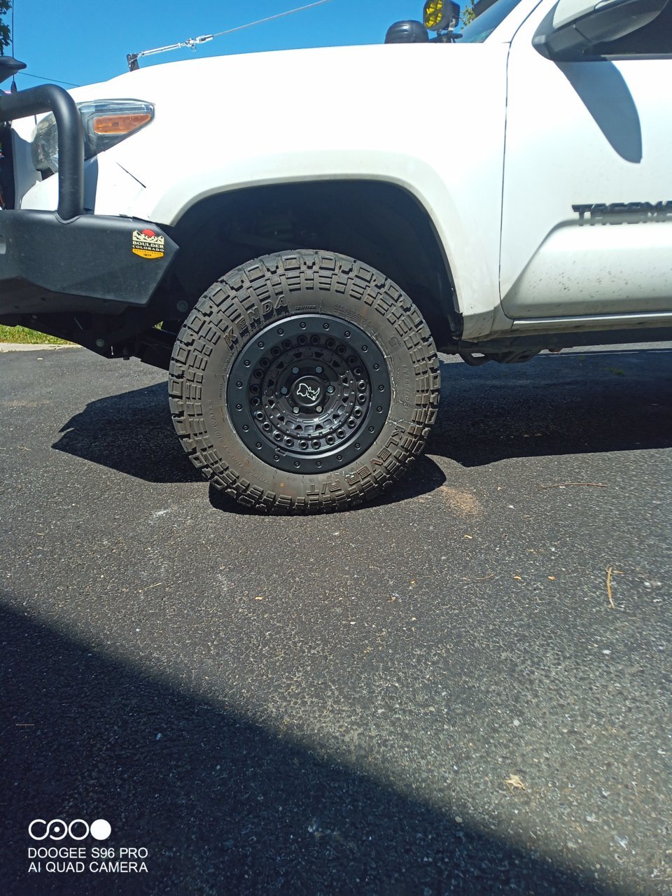

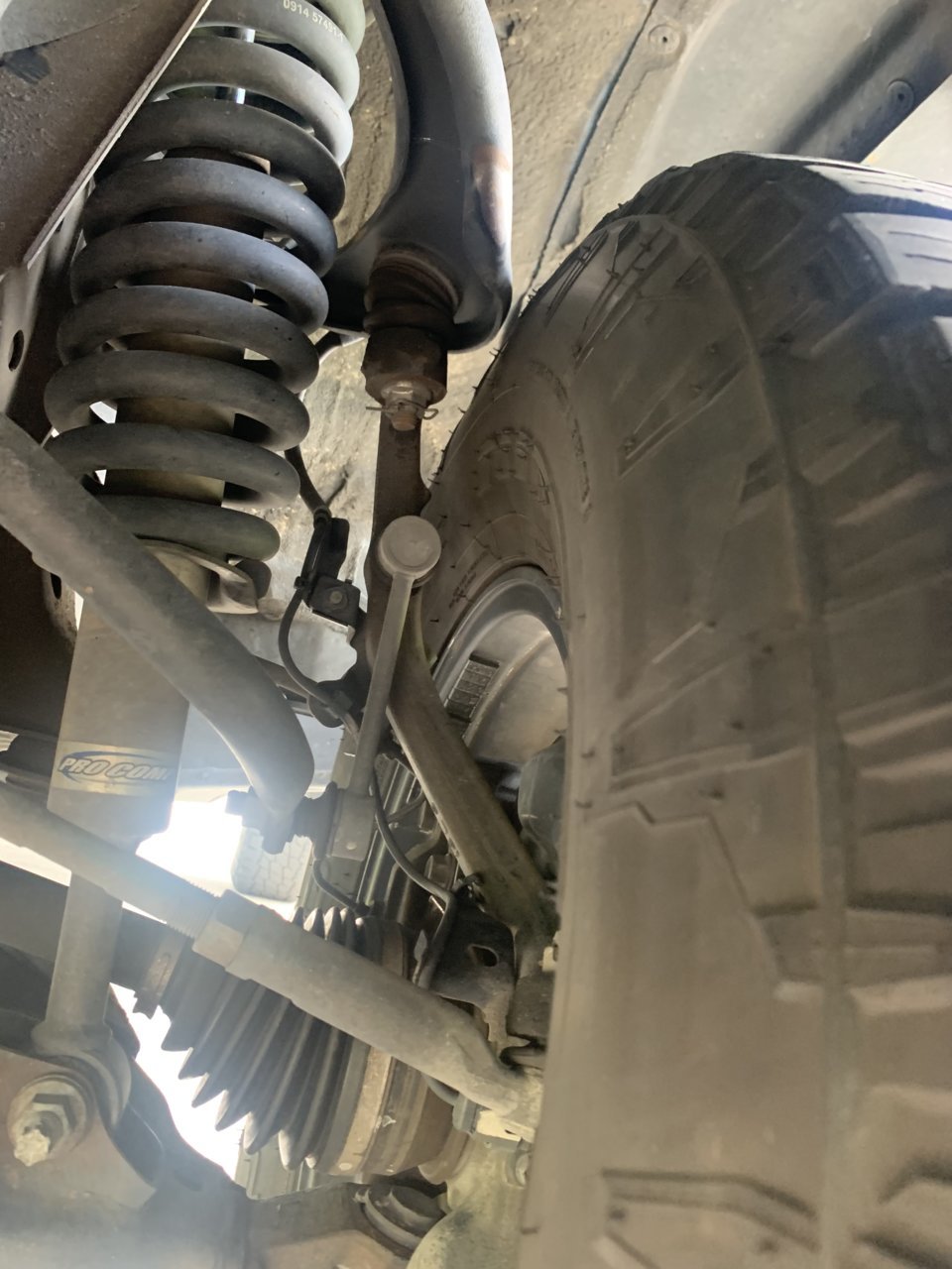

  12. May 26, 2023 at 6:28 AM
    #32
    Adventuretaco13
    Adventuretaco13 [OP] Well-Known Member
    Aug 21, 2020
    #338316
    130
    Downingtown, pa
    2020 Tacoma TRD sport
    Wheel at full lock
  13. May 26, 2023 at 6:29 AM
    #33
    Adventuretaco13
    Aug 21, 2020
    #338316
    130
    Downingtown, pa
    Wheel partial turn

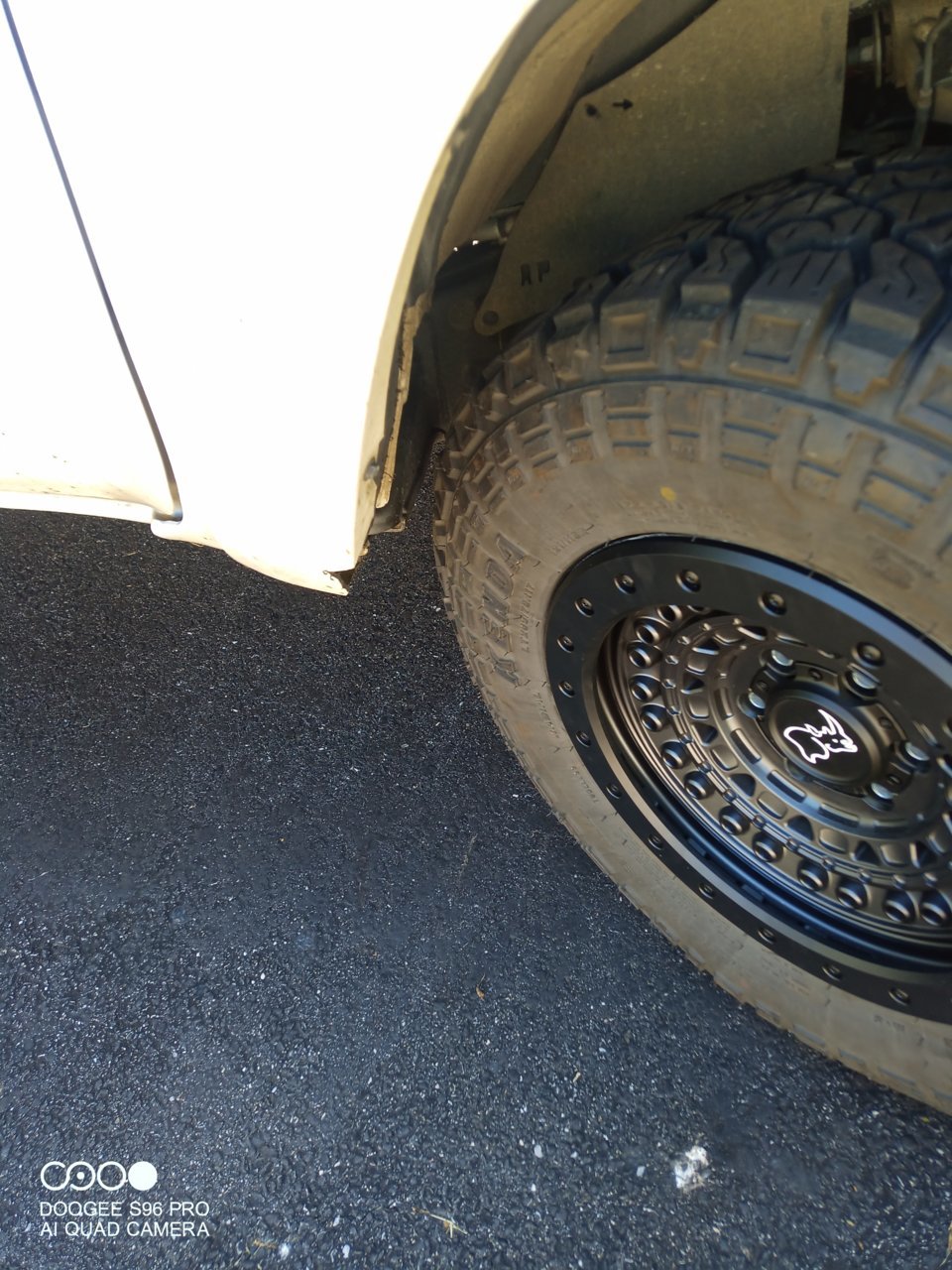

  14. May 26, 2023 at 6:30 AM
    #34
    Adventuretaco13
    Aug 21, 2020
    #338316
    130
    Downingtown, pa
    Wheel with no turn. Spacers are still on and they are about to come off

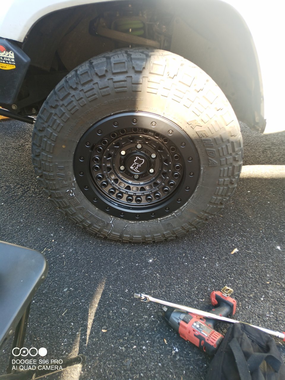

  15. May 26, 2023 at 8:02 AM
    #35
    Adventuretaco13
    Aug 21, 2020
    #338316
    130
    Downingtown, pa
    Update: I haven't taken it for a drive yet but from the looks of it it was the spacers.
    Ricardo13x likes this.
  16. May 26, 2023 at 8:03 AM
    #36
    Adventuretaco13
    Aug 21, 2020
    #338316
    130
    Downingtown, pa
    Full wheel lock. Looks better
  17. May 26, 2023 at 8:05 AM
    #37
    Adventuretaco13
    Aug 21, 2020
    #338316
    130
    Downingtown, pa
    Fender clearance looks better. Again thank you guys. But I'll take it for a ride to get a better idea.
