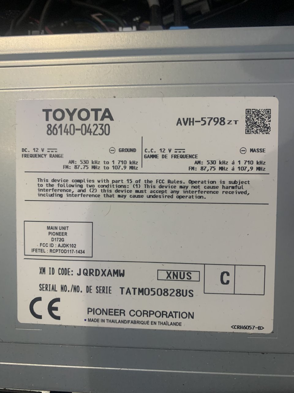

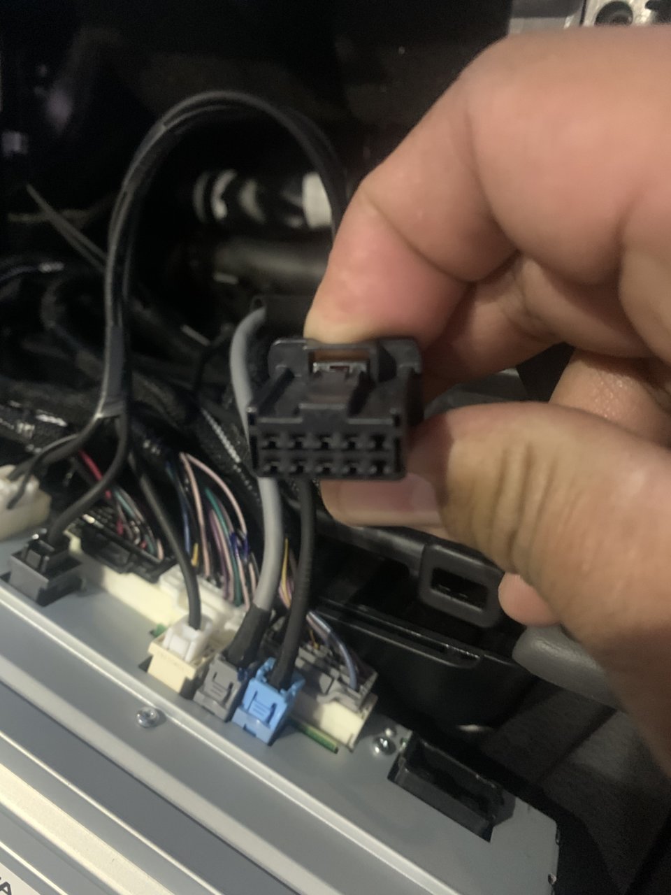

    9536E991-D9D6-4267-9F42-509BC912BB0D.jpg B7D290E6-F480-4B76-B190-89C54D78FA0B.jpg I’m stuck on a project and need help finding couple wire harness that will work with my 2020 Tacoma stock head unit. I search every where for them but can’t find it. I already bought the wrong ones on Amazon. I’m just needing the 10 pin I believe for the speakers male and female ends so I can run it to my LOC and amp. Plus I don’t want to cut the factory harness I just need a plug n play. Anyone got any info or whereabouts I can get them. Aloha

    The pin arrangement in the diagram looks different than the OP picture. Is this correct?
  5. Apr 5, 2021 at 1:22 PM
    caribe makaira
    caribe makaira Well-Known Member
    Feb 13, 2011
    #51121
    11,785
    Caribbean, Puerto Rico
    05 PreRunner TRD Offroad AutoTrans
    Hood Struts, My version Fogs always ON, Map & Overhead Light Mod,
    Yes, incorrect. Connector is R51.
    OP could look for the part number embossed on it...

    Yeah it’s the same as Amazon.
  8. Apr 5, 2021 at 1:26 PM
    Alohamadafakaz
    Alohamadafakaz [OP] Member
    Apr 4, 2021
    #361625
    16
    Model # R51?
  9. Apr 5, 2021 at 1:26 PM
    Alohamadafakaz
    Apr 4, 2021
    #361625
    16
    Where can I get a male and female?

    Connector R51

    You are correct, sir. I just checked Metra's site and they are definitely showing something different.
    OP, not sure I got the selections right, assumed a TRD Off Road Crew Cab.
    http://www.metraonline.com/vfgapi/vehicle/328241?

    Probably from Mouser.com
    But it's often very hard to find the correct connector in their listings. If you can determine the mfr of the connector, that helps a lot to narrow it down. Once you think you've found it, they will usually have links to the datasheets and you can confirm. The pins will likely be sold separately and they will be a bitch to install.

    Yeah, I realized that looking more closely at your connectors, they've just been using the same ones, either male or female, for so long . . . edited my post above to warn off others.
    Looks like the Metra 70-1765 kit might have the right one that you need.
