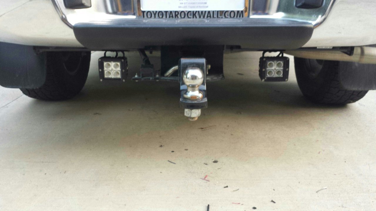

    I just recently bought a set of flush mount and installed them in my rear bumper. And i am now stuck with the wiring portion of the install. I want to hook it up too a switch in the cab and i do have a harness for it but obviously its too short. I want to know what size wire i need and how to hook it all up together. Sorry im just a noob with electrical work. Thanks for the help ahead of time.

    To calculate the wire size one must know the amount of load on the lights. How many watts are they each. Add them together. Find how many amps it is. (Ohms laws). Then find out how long the run is going to be. For instance 2- 55watt lights = 110watts total at 12.4 volt system that is 9 amps +/- (Ohms law). At 15 feet you would need 12 gauge wire your fuse size should be 10-15 amps. I found the gauge size by a chart located here. http://www.hifisoundconnection.com/...page/Car-Audio-Wiring_Power-Wire_Speaker-Wire
    Also for that kind of power i would consider a relay. To take the load off of the switch. If not the switch needs to handle the 10 amps of power.

    I agree with vanhornsky, however you're probably not running 55w lights just for reverse. I used some 18 gauge for mine and no relay for now. The switch I have is rated for 30 amps (AutoZone). I'm probably going to put them on a relay to be safe later.

    OP, did you ever get your wiring figured out? I just finished my lights last weekend. Hopefully my wiring diagram might help.

    Kilo, that diagram looks good. I see an issue with how RL-4 is wired. Im assuming you connected it correctly during install and were just limited in how you could make the diagram appear but if connected exactly as illustrated then RL-4 will cause issues for you in regards to functionality

    Yeah, it's tapped into the driver's side reverse light. The relay is tucked away behind the taillight.
    I should have clarified IGN and REV. IGN is an add-a-tap under the dash in a spare fuse plug, I believe it's actually tied to the headlights and not ignition like I originally planned, but that's fine for me. The RL-4 relay is there so that the lights can only be turned on if the truck is in reverse and I flip the switch.
    Also, I made the diagram using Draftsight which is a free CAD program that works really well. I can change whatever I want on the drawing. What would you change on it?

    Yeah the way I read that with ignition on, you hit switch 3, which trips relay 3, sending power to relay 4, which is tripped by the reverse circuit's power, then turning on the lights. So you'd have to have those three events to trigger the aux lights. You could back up without them on, but could only enable them when in reverse so you don't leave them on driving down the road.

    When I had the other set wired in that wasn't so bright I had an idea to wire it up where you could toggle the aux lights anytime, and they'd turn on in reverse, by setting the reverse lights and aux lights on a relay triggered by the reverse circuit, and a toggle switch wired in to the lights as well. Just to isolate the reverse circuit from voltage going back. The reverse lights would flip on with the toggle as well, but if you just wire a toggle and the reverse circuit to the lights when you flip on the toggle it will energize the whole circuit, turning on your backup camera and making the ECU think the truck is in reverse when the transmission isn't.

    Well finished the setup just now thanks to proforce. Will see what they look like at night
