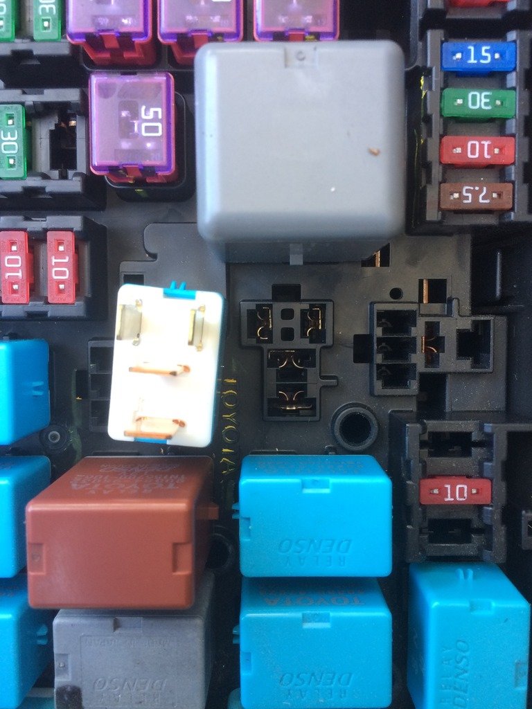

    I tried like the other threads said but my fog light relay in my 2011 has 4 prongs and 4 terminals. Not sure whats up because the other threads show only 3 terminals in the fuse block. What am i missing??

  2. Nov 6, 2016 at 9:22 AM
    Troyotasportrd
    Troyotasportrd Active Member
    Jun 27, 2016
    #190711
    28
    Troy
    2011 Silver Tacoma TRD Sport

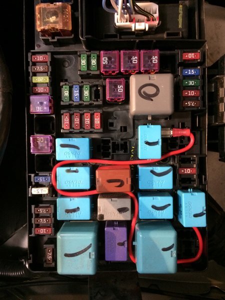

    That's the fog relay you are looking at, it does have 4 prongs. I think the trailer tow relay is the one that had 3 prongs. You are on the right track so far, pull the trailer relay next. This is the setup from my 2011 dbl cab trd sport

    Nooooooo, not that easy. That is the relay that you bend pin 1 so you can connect your jumper and run down to the trailer relay and connect to pin 3. At pin 3 i just pulled the relay, slid my bared jumper wire lead into the pin 3 slot and re-iserted the realy, no need to try to get a connector in there. See in my image that red wire running from the fog realay down to the trailer relay.

    so bend that fog light relay tab outwards so it will not make contact inside the fuse box? then jump it to the #3 tab on the trailer relay?

    Also note that the #3 pin on the trailer relay is the bottom one

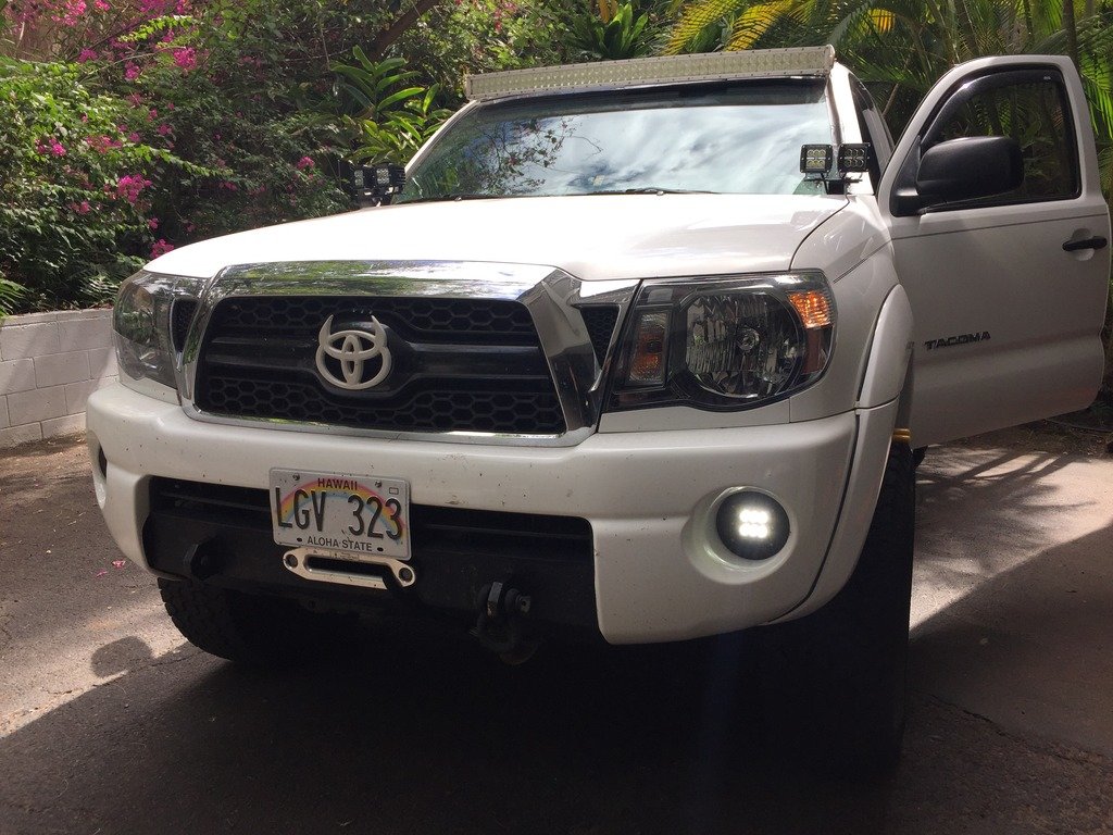

    F2FD26F0-FD6D-4DD1-81A1-908D07CD355A_zps_9af8fb954d940c9829b7952b16c2a1f0995d620f.jpg

  11. Nov 6, 2016 at 2:34 PM
    Troyotasportrd
    Jun 27, 2016
    #190711
    28
    Troy
    Awesome! Now tell me where you got that grill emblem!
