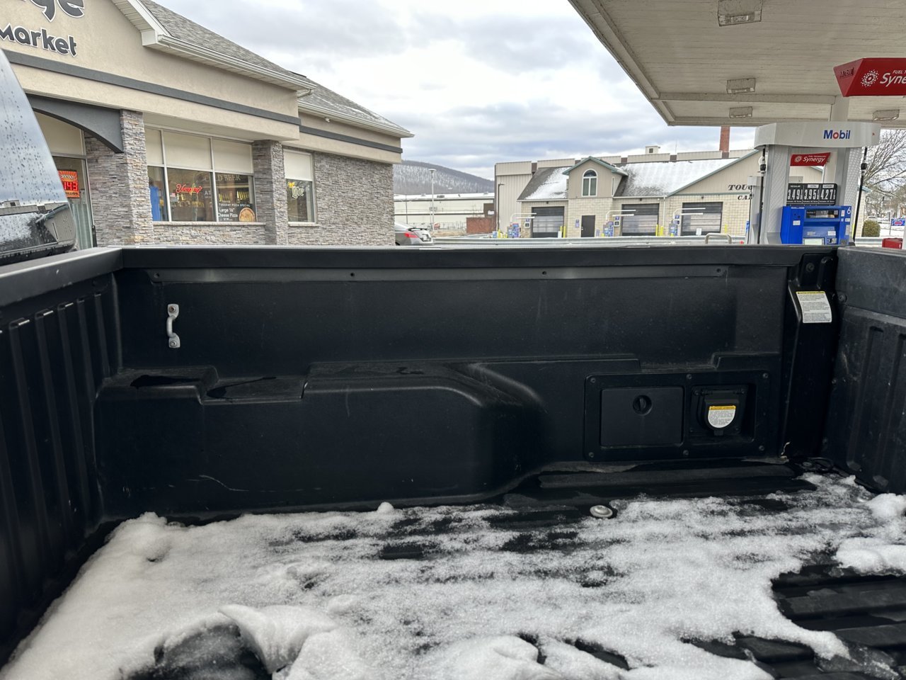

    The bar that would go across these holes. Someone removed it previously and all caps/toppers clamp to the rail. I can’t install one without it as there’s no where to clamp.

    Alright so after some digging I can say I’ve figured it out. The above mentioned parts were actually the plastic trim cap for the bed side. Toyota does not show the correct part anywhere in the oem parts diagram. I did some digging and came across part number PT278-35100-sb which stated it would fit 2nd and 3rd gen tacomas. Toyota only stated it fit up to 15. I was quite certain they had to be the same part. I ordered them through my local dealer and sure enough they are correct. They don’t come with any hardware so a quick run to Home Depot solved that. Good to go now! If you have a long box the part number would be pt278-35100-lb
