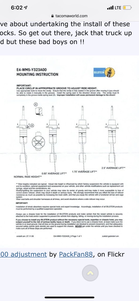

    i recently bought the ome 881 and bilstein 5100 and they came with the adjustment on the very top line. My question is why do my shocks only have 3 adjustment lines when all of the graphs I’ve seen are 4 lines? I bought the shocks specific to my truck on bilsteinlifts.com I want a 2.5” lift in the front, how can I achieve it with this combo?

    You may have gotten an older version. I know some models like 2nd/3rd gens have 4, and maybe the newer 1st gens have 4, but mine had 3.
    THe top line, whatever it is, though, should be 2.5"...

    If you can't get the proper alignment, dial it back down to 2" or buy aftermarket upper control arms!

    You have the ome springs which means the bilsteins get set at 0. If you want more lift, you need a different spring...

    Do you have an aftermarket bumper and or winch on the front? If not, the 881s should give you close to 2.5" on the front end without any help from the bilsteins...

    Shoot, yeah forgot you have the 881s... The top ring would be 2.5" for a stock spring...
    with the 881's you should be on the bottom or *maybe* the middle, but do NOT use the top clip setting with the 881's. You shouldn't ever go more than 2.5" overall lift, you run into several problems that way.
    When you have 2 different things that offer a lift, in this case your 5100s and the 881, that's stacking lifts, and that's generally a bad idea, because you over extend what each lift is designed to handle, plus you over extend what the truck's suspension can handle without other mods, too (diff drop, aftermarket upper control arms).

    According to: the 881's should give you 1.5-1.75" lift. Depends on if you have a v6, plate bumper/winch, etc... The 882's are what would get you closer to the 2.5 you want. So you may be able to set the 881 on the middle setting, but ideally you'd get springs set for that height. When you mess with the clips on the 5100's you increase the spring pre-load (makes them stiffer).

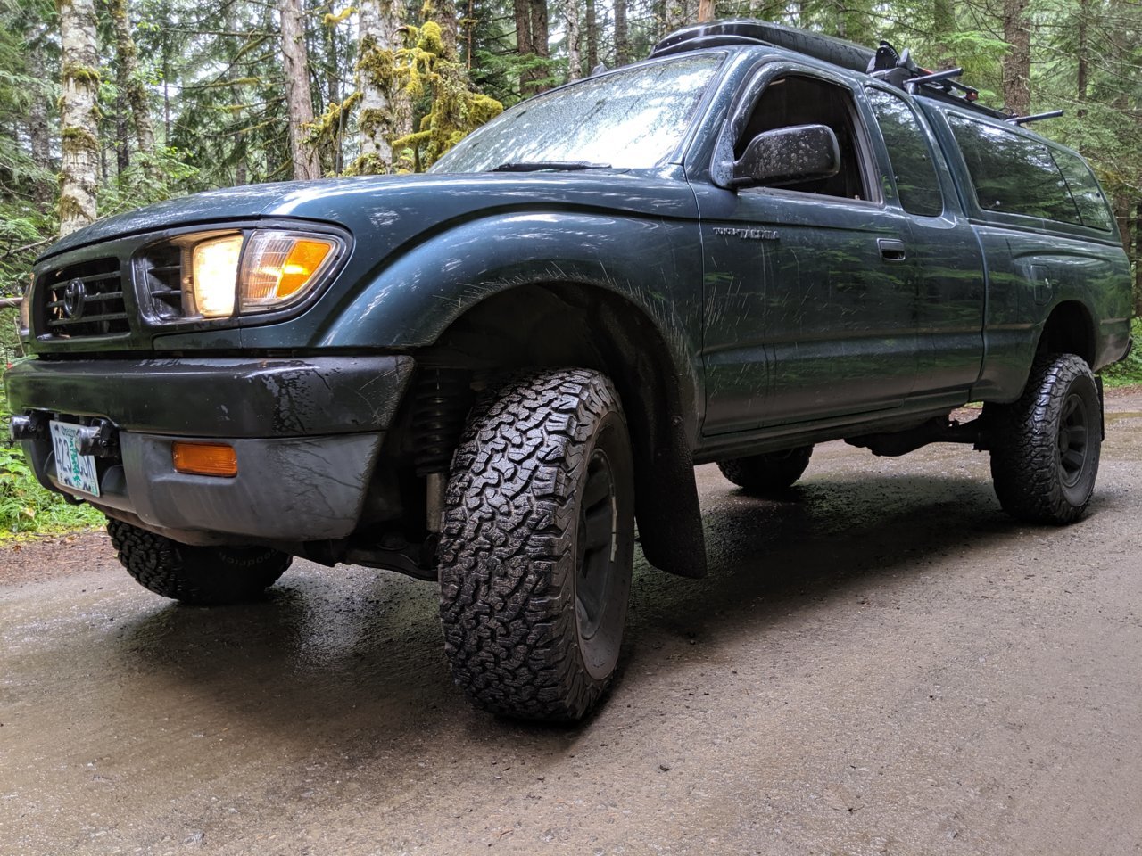

    Haha sounds good, any pictures of yours with that setup?

    Here's one from today
