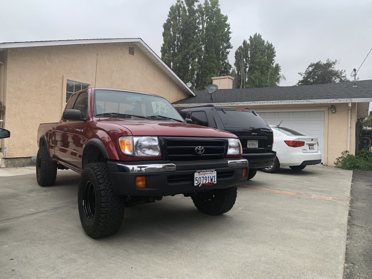

  8. Aug 13, 2019 at 9:53 AM
    #28
    MamaTried81
    MamaTried81 Well-Known Member
    Jan 24, 2019
    #280434
    189
    Oakland, CA
    '02 TRD Tacoma 4x4 V6 XtraCab SR5
    I just put the same setup on my Tacoma. 5100s all around, OME 881 coils, and the rear has General Spring standard duty leafs with Wheelers 3-leaf progressive add-a-leaf. I set the 5100s to 0" and probably got close to 2" lift in the front. I was considering using the middle 1.25" notch, and might still if I add a heavier bumper.
    I left the overload leaf in place and I actually got 4" of lift in the rear when I added the Wheelers progressive AAL. I measured it before and after- it was 20.5" from the center of the rim to the edge of the fender skirt, and after install it was 24.5"
    I went wheeling this weekend and it settled down just 0.5" so it does have the stink bug look, but I like it. And when I go camping/wheeling the truck gets loaded up with tools, water, fuel, gear and sits (and handles) just right.
    You appear to have a double cab but it's a prerunner so you don't have the 4WD weight up front. You'll probably get close to 2" of lift with your 5100 set to 0", especially if you have 4 cyl engine. If not, you can always go back in and set the 5100s to the middle 1.25" setting.
    *if you do any wheelin', do yourself a favor and remove your sway bar. It takes 15 minutes. You don't need it at all with those fresh OME 881 coils. You'll hardly feel a difference on the road, but you'll get an extra 1-2" of travel from your front wheels, which is real handy while negotiating off road obstacles.
    **265/75/16 tires shown below (31.7") fyi
    71tattooguy and LuisRomoSR5[OP] like this.
