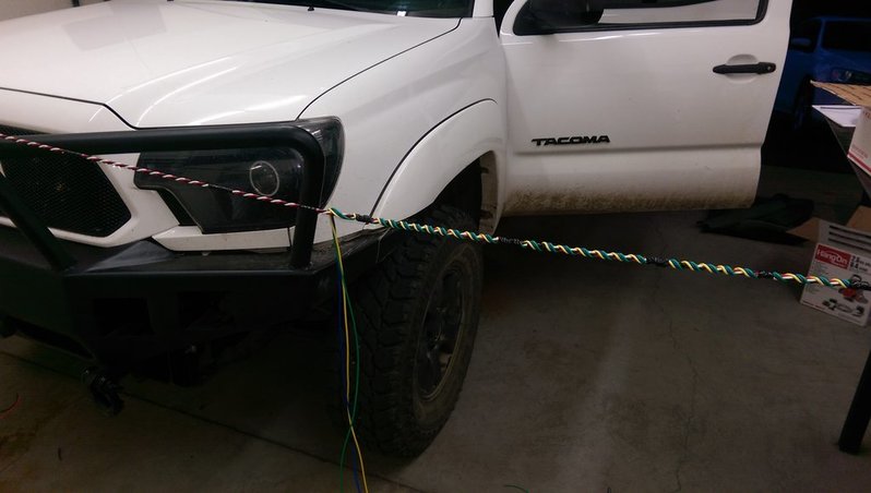

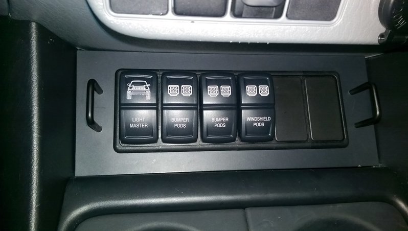

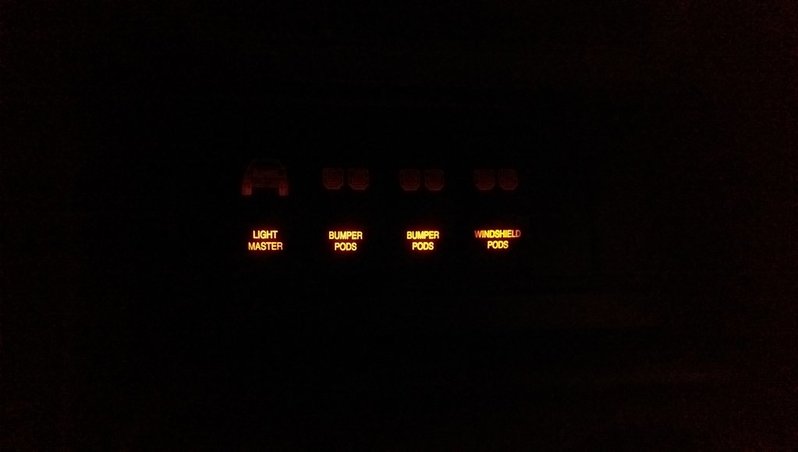

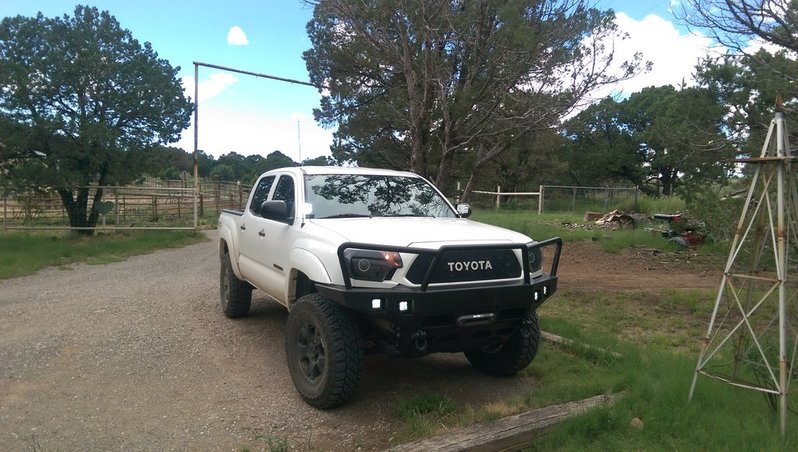

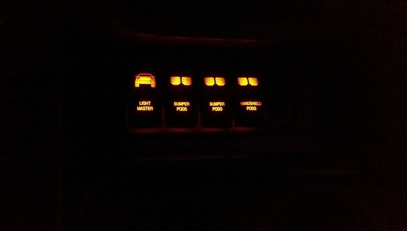

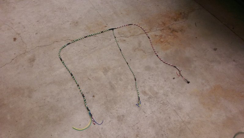

    Update for everybody. I got it all wired and working well. The master switch works perfectly and I didn't have any issues other than getting the wrong diagram with my switches.
    IMAG0663.jpg IMAG0664.jpg IMAG0665.jpg IMAG0666.jpg IMAG0667.jpg IMAG0679.jpg
    Thanks for all the help.
