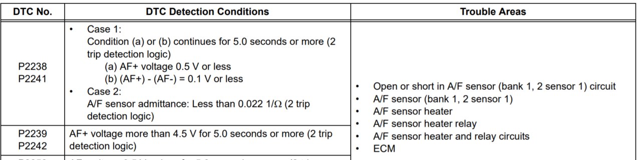

    Just to give you some expanded information from the FSM
    p2238 Oxygen (A/F) Sensor Pumping Current Circuit Low (Bank 1 Sensor 1)

  5. Oct 8, 2017 at 8:24 AM
    Sandman614
    Oct 26, 2010
    #45273
    35,985
    Tim
    Garner, NC/Boone, NC
    '06 SR5 Off Road
    *similar drawing, Bank 1 is Passenger side

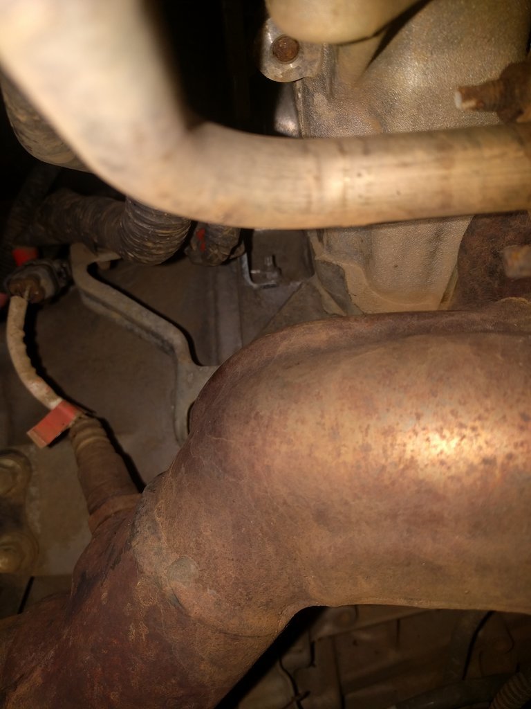

    2013 tacoma
    This is very helpful . just so i understand this is the passenger side sensor just after the manifold. I guessing its that sensor rather than wiring. would you use a Toyota sensor or after market? again thanks for the help IMG_20171008_121010.jpg

    '06 SR5 Off Road
    I would use a Denso(OE) bought from Amazon or rockauto after looking up the p/n at http://densoautoparts.com/find-my-part
