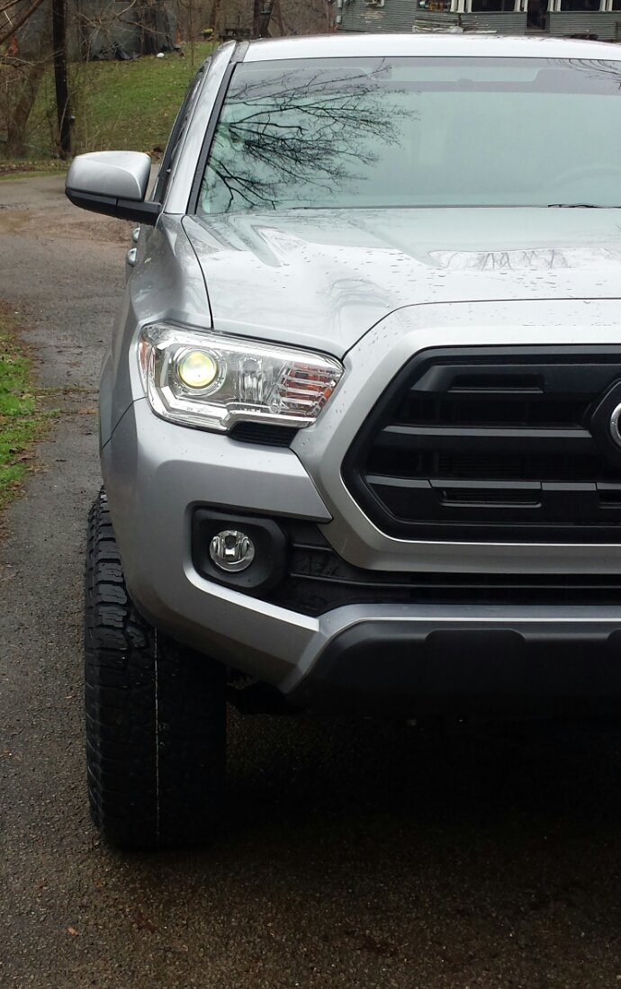

    Heres a tip on your wheel size choice.
    The bigger the rim the less sidewall your tire will have which means rougher ride quality.
    I went with 17x9 -12 offset with 265 70 17 and if I had it to do over I would have went 16" wheels with 0 offset and 285 70 16 tires

    2018-02-24 16.37.02.jpg heres -12 offset with no flares

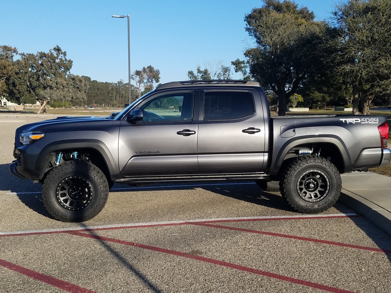

    3in all pro lift W/king suspension
    20180224_164332.jpg I went with kings set up paired with an icon AAL in the rear. Adjusted the coilover for about 3in up in front and put me at about 2.5in in the rear. Truck sits perfectly level and ride quality is great!
