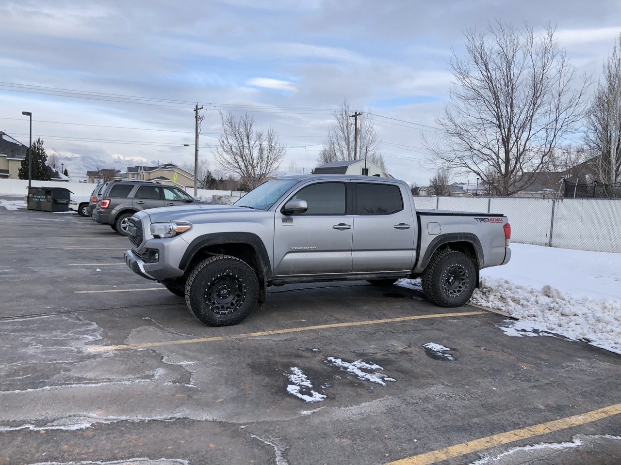

    885 coils with 5100s all around.

    @Technique I like your set up, are you having any issues with rubbing on the upper control arms?
    Also what size tire are you running? Reason I ask is I want to try and put 285/70/16 on my truck without having to do a massive lift. I'm looking to achieve 2'' in front and level out the truck.

    My tire size is 265/70/17 and I don’t have any rubbing on my upper control arms but I do on my mud flaps for sure when reversing and maybe up front also - this will heavily depend on your wheel. 2” lift up front with nothing done in the back will not be level. Mine is lifted 1.75” and it squats in the back a tiny bit.
