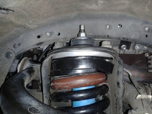

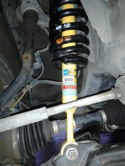

    Okay so I'm happy to say I fixed it. I got new top hats, bushings and washers and put in my OEM shocks. I added a 3/4" poly preload spacer (goes in place of the isolator = 1" lift) Then a 1/2" top plate spacer (1/4" on passenger side) to at least give some lift in it. Now it is quiet and smooth again. I'm super stoked that's what it was. It actually rides pretty good seeing as the shocks only had about 4K mi on them when I replaced them with 5100's. Also because I only used small spacers split between preload and top. I lost about 3/4" of lift. I went from 2.5" to 1.75". It's really only a temp solution as I will get another set of 5100's or maybe shell out some $$$ and get some Icons or Fox coilovers? Loving the quiet cush again. I went over the infamous dip that always caused a clank the last year or so 6 times and it never made a sound just cushhhhhhh! Love it. Now I have to go back for alignment #4 on my lifetime policy. Highly recommend that for anyone that wheels and mods their rig.

    Glad you made a change and solved it. I read your description, but I'm not sure I understand exactly what it was... Was it the bushings /tophat making noise or the 5100? Did you use the same coil?
  8. Mar 13, 2016 at 9:31 AM
    #28
    HB Taco
    HB Taco [OP] Well-Known Member
    Apr 10, 2011
    #54683
    1,240
    Curt
    Huntington Beach, CA
    2019 F150 FX4 S Crew 3.5 TT
    I guess I wasn't too clear. Basically what's in there now is the OEM shock assembly with new hardware. Since the Top Hats, bushings and hardware looked good with no obvious damage I'm guessing it's the shocks themselves unless somehow the springs were shifting or something? The springs looked good too. When I compress the 5100's manually they seem ok. Weird :confused: but that's why I think I'm just going to drive it like this for awhile while I contemplate what shocks I'll go with next. I'll just take it kinda easy on the stockers when offroading. Thanks
