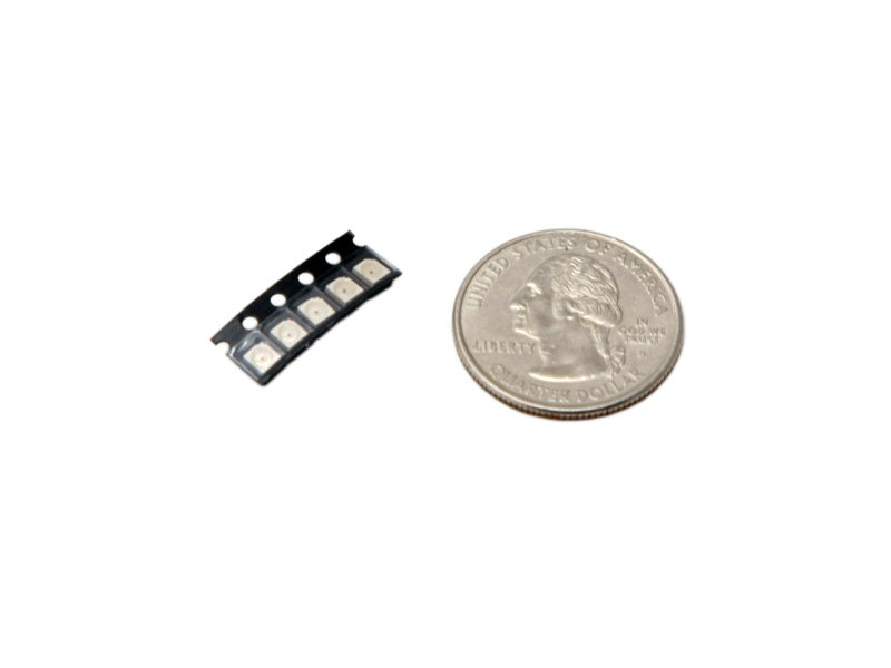

    Or better yet, can anybody just show me a picture of what the actual bulb and size is/looks like please?

    LEDs are Plcc-2 bulbs...
    http://www.oznium.com/plcc-2
    I get all my LEDs from there and as well as all the members I swap the lights for

    They are small
