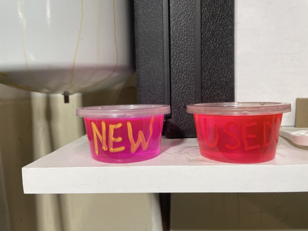

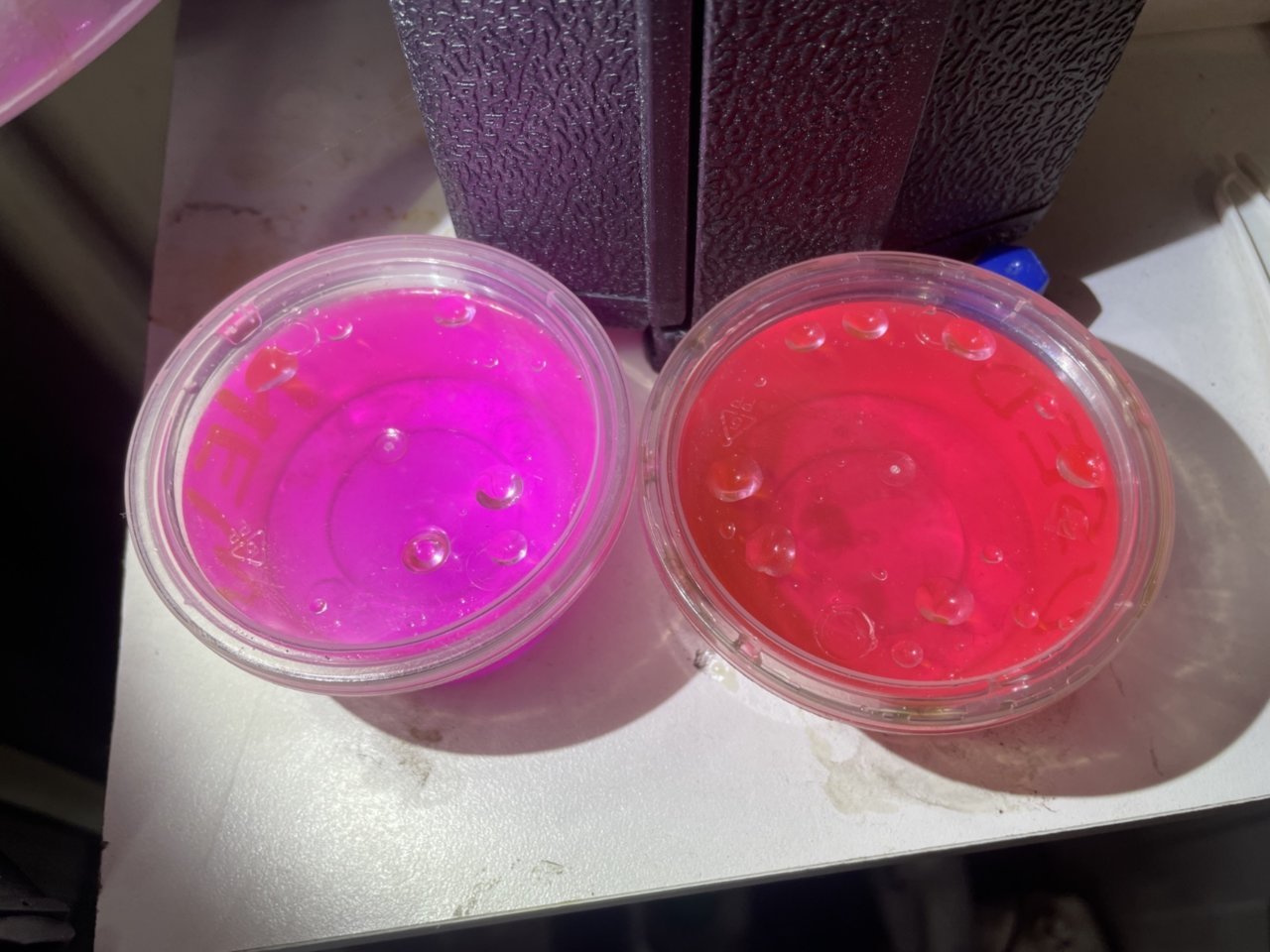

    I did the coolant flush, 2nd gen V6 4.0 / 1GRFE. ~2.05 gallons came out, 2.05 of Toyota SLLC2 50/50 pink pre-mix went back in. I am not certain but I think the old coolant had the truck's full 68K miles on it. I was amazed how good it looked -- almost as clear as brand new coolant. Or, maybe the coolant was changed previously but wasn't in the full paper service history I got w/ the vehicle when I bought it.

    New/used coolant comparison:
    Some take-aways:
    - Opening the block drains is a must do for a coolant flush, at least on any vehicle that is young enough that the drain bolts have a high chance of opening normally, rather than being seized. Over 60% of the used coolant came out of the block drains, not thru the radiator.

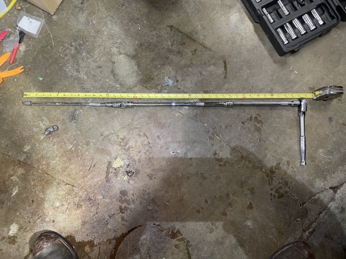

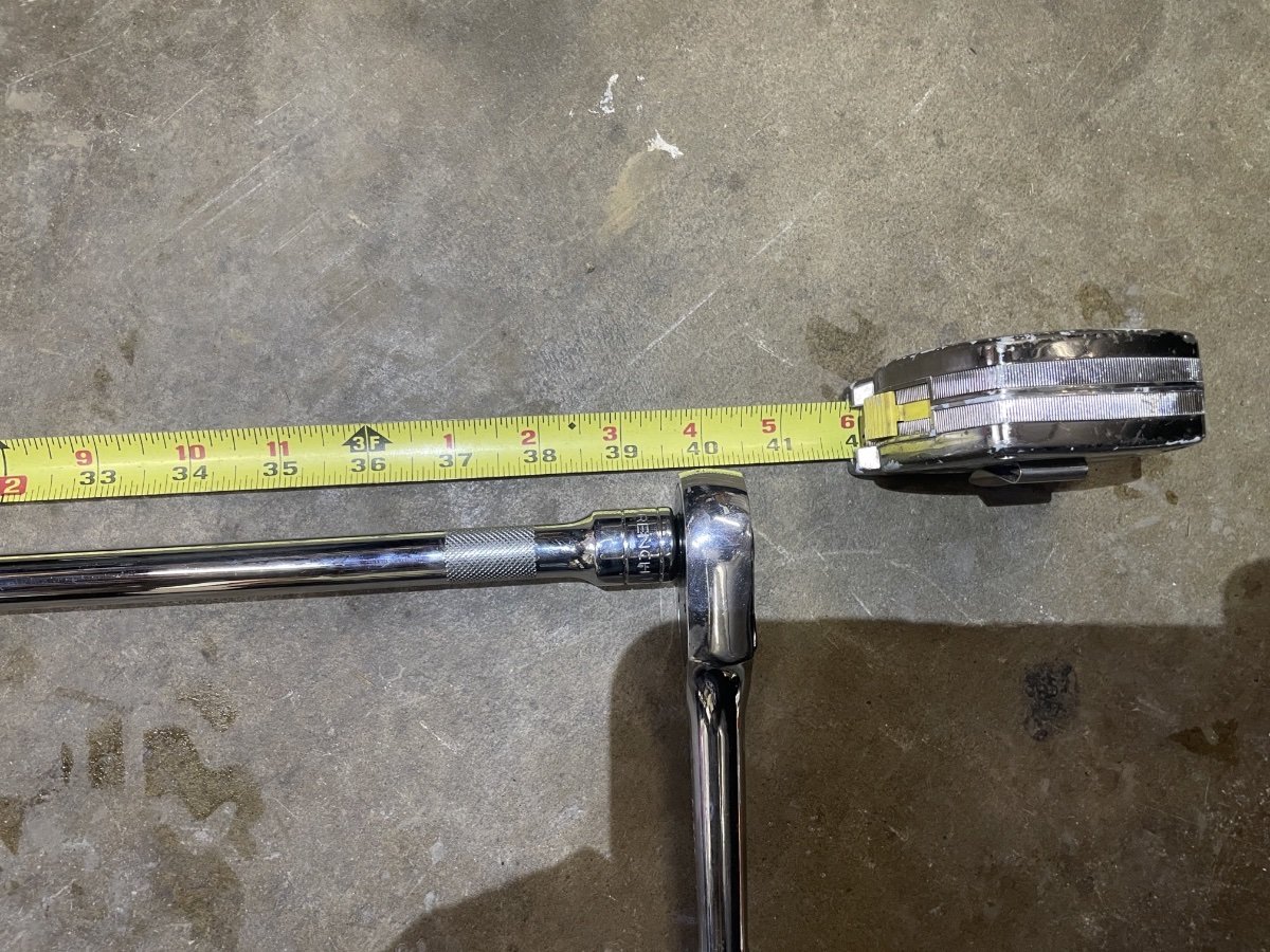

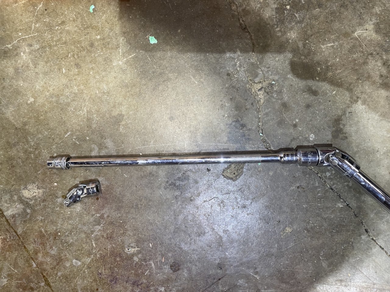

    - Block drain nuts are 10mm. Torque spec for this nut is 9 lb-ft on the 1GR-FE engine but due to the angles involved I didn't use a torque wrench. 9 lb-ft is "some, but not a lot," or "about as tight as needed for a 10mm bolt going into aluminum threads." NB for less-experienced people: if you aren't confident that you can work these bolts without damaging them, probably best to leave well enough alone. They do not have to be fully removed for the drains to open fully, so don't take them all the way out. W/ the driver's side in particular, if using a mega-long stack of ratchet extensions +2 separate elbows, you want to control your torqueing very carefully. (Some people on youtube claim to be able to get their fist up in the engine bay from underneath & just use simple 3" straight extension. Maybe I'll try that next time if I lift the truck for the work.)
    When closing them, they should be, you know -- just ratchet-snug. No ugga-duggas! I closed mine with minimal torque until they stopped, and then went maybe 1/8th of a turn beyond that.
    Stripping the threads on a block drain would be a PITA to fix. Seized threads more likely to be an issue w/ high-mileage engines. (I'll see how my 185K '99 Tacoma 2RZ-FE 2.4L fares with block-drain opening in a week or two.)
    - I managed the block drains by using an absurdly-long 40" stack of extensions & elbows. See photos. Note, the passenger side is pretty easy to get to and can use a straight socket at the end of the stack. The driver's side needed wheels turned full left, and an additional swivel right at the tip of the stack. Took so long to get the socket on the drain nut that once on it & loosened, I carefully left the whole stack attached to the nut so I wouldn't have to re-locate the socket on the nut again when closing the drain.

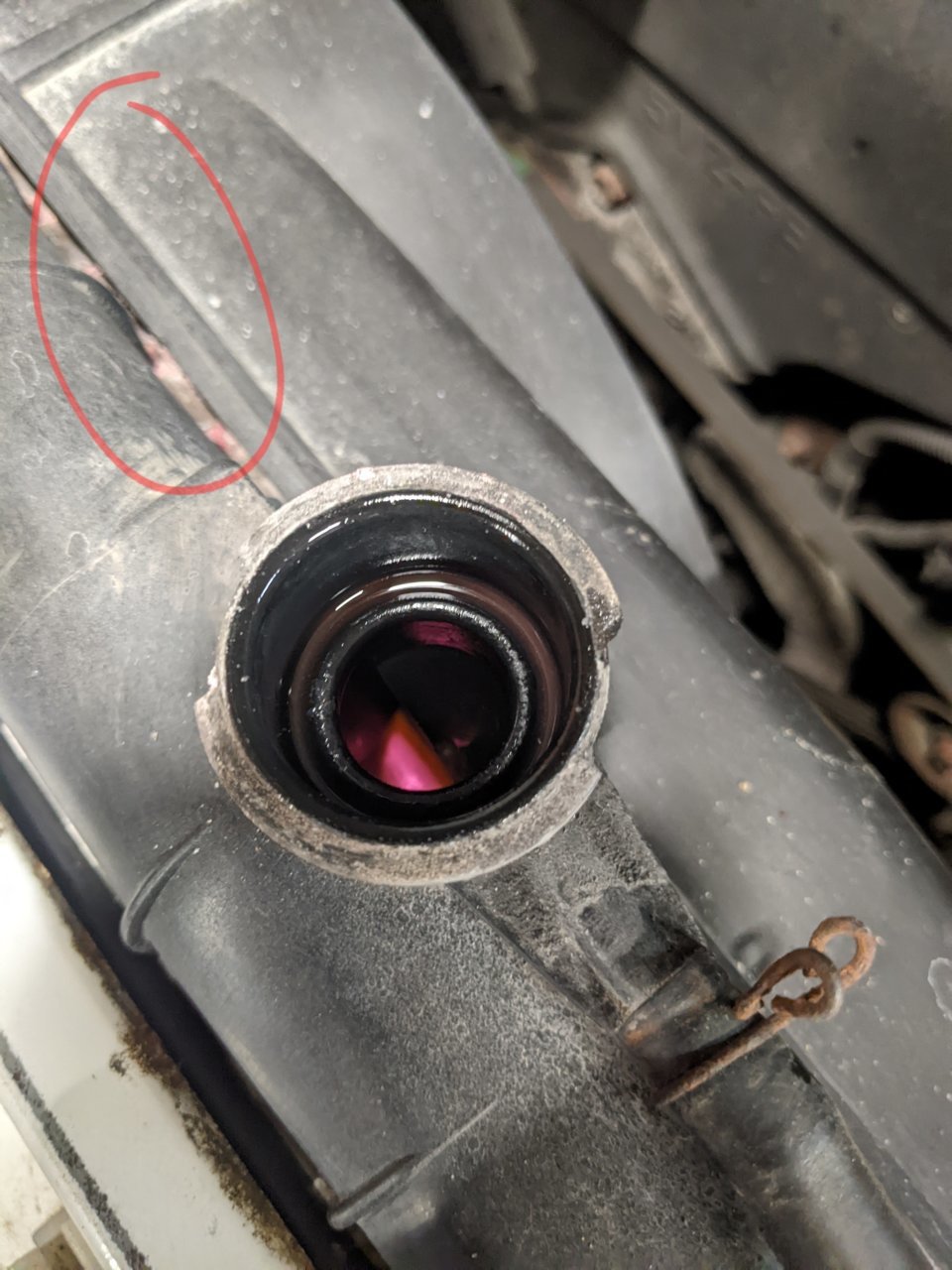

    Is that coolant crust at the seam? Is the cap leaking down onto it?
    A new radiator might not be a bad idea anyway. It's 20 years old ..
