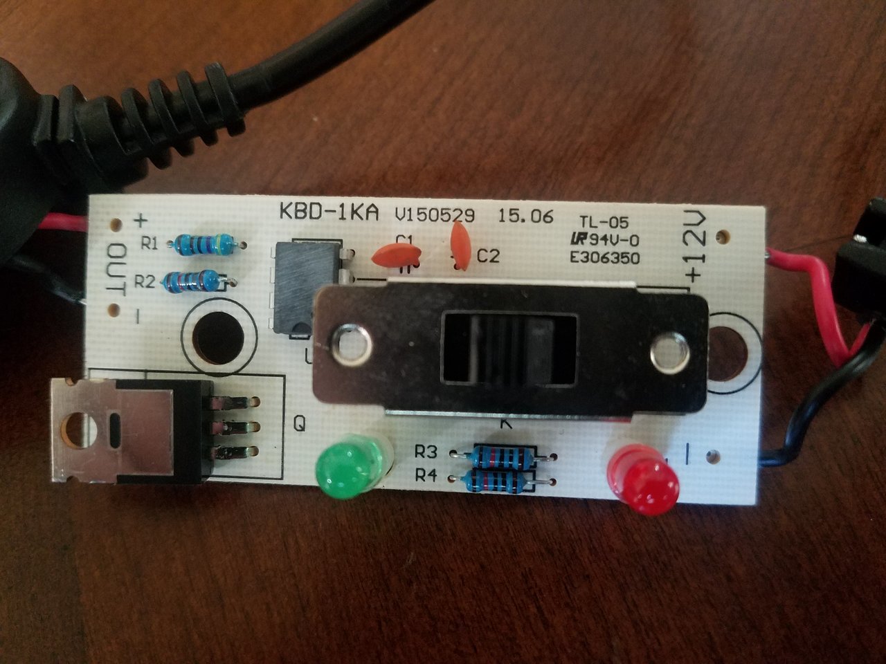

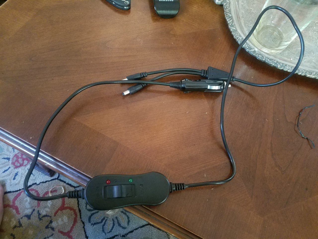

    i just got my new seat covers installed, and now I'm looking to get the seat heaters hard-wired. The wet okole heaters have a 12v cigarette style plug with and inline hi, low, and off switch. I'm wondering if I'd be able to get a switch like this https://www.amazon.com/Sunautobuy-U...1507416229&sr=8-3&keywords=seat+heater+switch and cut off the existing 12V plug and switch assembly. From what I've researched each seat heater draws 10amps. Will I need a relay? Here's a picture of the switch assembly.

    and a picture of the switch assembly pulled apart

    That board is controlling the high and low settings. You can try measuring the voltage output in each switch setting to see what it's doing.

    That makes perfect sense. I'll do that when I get a chance. Right now, I'm thinking of detaching the switch from the board and wiring one in like the one I posted. I just hate the look of the controller WO uses. Once I get it all figured out, I'll do a write-up so the people who get the seat heater option will have a good idea how to hard wire it all in.

    Like you, I purchased the same type of universal switches and was just going to bypass the WO switch, but i learned that the WO controller actully switches the ground, and that was going to render the hi/lo LEDs on the new switches inoperable w/o some additional wiring and components.
