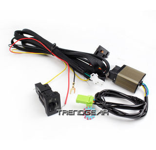

    If I could get a hand. I'm wiring heated seats and each seat has it's own separate harness set up. Each one also has a 7.5amp in line fuse on their power wire. I was going to splice those two together after the fuse and then run to the main fuse panel with one wire. Question is, do I need a 15amp tap or only a 7.5?
    I bought one of those "add a fuse" taps from the auto store but it says they are only good up to 10amps. If you've got a suggestion on where exactly I should go on the fuse panel that would be great. I also need to tap the yellow wires to a light source. Anything you have for that would be useful too. I was thinking to splice into the light source for the heater controls but the wires back there are pretty confusing and thin.
    Thanks

    This is what one of the two identical harnesses looks like.
    Black is easy. Ground
    I thought the yellow was for the switch light
    I spliced the 2 reds (which both have their own in line 7.5 fuses) and ran to the fuse box. Installed an "add a fuse" with a 7.5 in it. Inserted into the fuse panel and the switch light works. Left it on for a few minutes but wasn't feeling any warmth. Maybe the "add a fuse" size I used is inadequate causing the no heat. Could the yellow be for the heat pads? Thanks for replies

    Does the switch light turn on and off with your dash lights, or is it always on? If it's turning on and off with the dash lights you know you have the correct wire.

    Black is grounding for the illuminated switch. It has nothing to do with the heating element. See me previous post about where it attaches. The yellow is the positive side of the illuminated circuit.

    I have the same style for my heated sets I am currently installing. I tested them out directly to the battery in the engine bay and yes, the yellow wire is for the amber and green LEDs inside the switch and the red is power. I did wait about 15-20 seconds and felt the pads warming up.
    as for the fuse goes, since there is already one in the wiring harness, doesnt that protect you? why go with a "add a fuse"?
    I plan on tapping one yellow and one red wire together to each cig lighter hot wire and grounding under the center console area.

    I'm just trying to establish that OP didn't mix up the wire for the switch light and the wire for the heating element. It sounds like he has it correct.
    OP, the 7.5 amp fuse in the add a fuse is fine for testing purposes for one seat heater. If the fuse was inadequate it would blow. Do you have a multimeter? I would test for 12 volts at the inline fuse in the wiring harness to ensure your power is getting that far.
    EDIT: Also, @EdinCincinnati, if the seat heater elements aren't getting their ground from the black wire, where are they grounding to? The reason I ask is if they are actually grounding to the black wire, putting the black wire to a ground that is controlled by the dash light dimmer would be a bad idea. I'm not familiar with the exact seat heaters OP is using but it seems that you are, so can you clarify? I'm not doubting, I'm just asking.

    I didn't check that. Will do. It probably would have as I used the "add a fuse" in the same fuse that's used for the dash lights. Maybe not. I don't really care about dimming the switch. Can't say I use that feature. More interested in the light coming on and heat getting to seats. Right now with only the black wire grounded to the body, and the Red wire to the fuse panel, the switch light comes on.
    That's what I thought about the inline fuses, but saw other posts, and I thought it would be nice not to T splice existing wires behind the dash. Homeruns are nice and it was pretty easy to run the wires. Any guess why my red is illuminating the seat switch. I don't have the yellow connected to anything yet
    Will do, but isn't it weird that the red (supposed heating element wire) is lighting the switch?

    Ok so I understand why you're confused OP. When you say the "switch light" is working even though the yellow wire isn't connected, do you mean the backlight that makes the switch visible, or the indicator light that actually tells you the heater is on?

    Yep, my kit has a separate ground wire from the heating pad side, it is a larger gauge black wire and you can see them both landed on the bolt to the right of the airbag module. Then there is a smaller gauge black wire just for the light in the switch - which is the one I assumed has been the point of focus in this thread.
    Additionally for your info, I ran a larger gauge fused wire from the battery that powers the two pads, you can see it on the left side of the module (largest red one) then I have a smaller power wire for the ACC switched feed that comes from an add-a-fuse in the fuse panel.
    If you're wiring harness is different, then disregard all my previous post.
