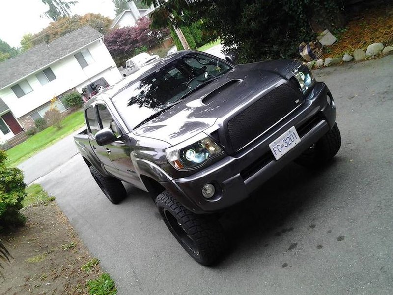

    Grillcraft,novakane rims nitto grappler tires,rough county lift,bestop,weathertech,retro headlights, led halo,blacked out emblem plastidip,show n go retract licence plate
    here is a great method
    take a piece of copper wire and pull a couple strands out
    drill a couple holes and feed the wire around the halo
    worked like a hot damn
