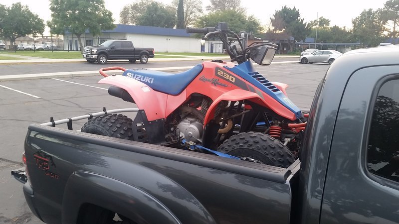

    Hey everyone I just bought a 1991 suzuki lt230 quadrunner last night for very cheap, like 200 bucks cheap. This is a 230cc overhead cam 4 stroke engine with semi auto trans.
    previous owner states that it has no compression, hence the cheap price of 200 bucks. This quad is a pull start, and electric start. I pull the spark plug, and yank the cord. Engine spins freely. I seal my finger over the plug hole, pull the cord and what do you know, engine spins freely! Ok so no compression
    Next, i yank the two access plugs out of the valve cover that allow me to do a valve adjustment and see the valve springs. So, i pull the cord again and wait to see the valve springs go up and down and guess what?? they magically do not move at all, perfectly still while the piston is going up and down!
    This cam has a gear on it that is driven by the crank with a chain connecting everything. I HOPE that the chain is just broken which is why the cam is not spinning and actuating the valves. My question is what are your all thoughts on this? Can the valves be open based on whatever position the cam is in, causing no compression?
    heres a few pictures of the disabled beast...

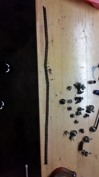

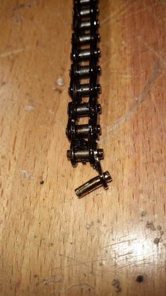

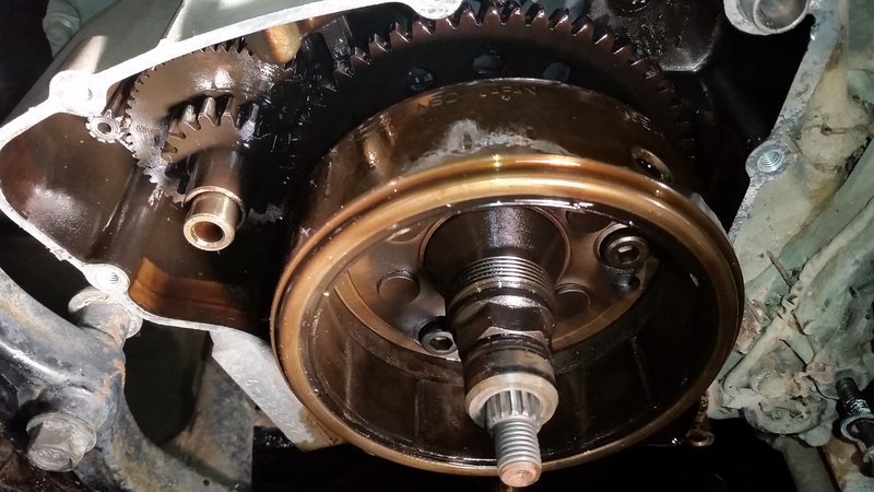

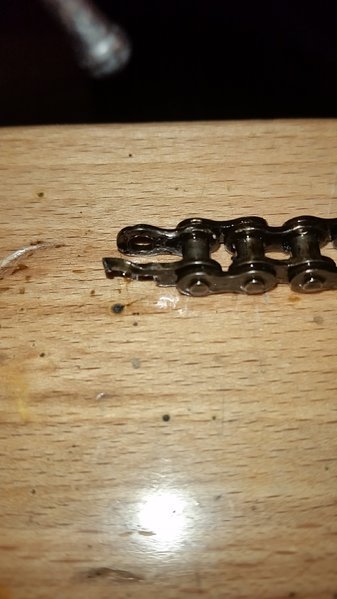

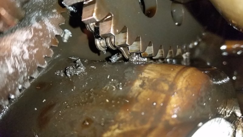

    Ok guys I got the side cover off the engine. The timing chain was laying behind the flywheel. I was able to pull it out with needle nose pliers. It is all in in one piece beside one small sleeve one of the links goes thru. I will need to remove the flywheel in order to put a new chain on, any ideas on how to get it off?
    Also, why exactly do you guys think the chain snapped?

    I used a chain breaker/press on the cam chain when I rebuilt my KTM 4 stroke. I had to remove the fly wheel for some other maintenance and it required a special puller. My guess is the chain stretched beyond spec or the tensioner is worn. It derailed and got jammed behind the spocket and that's what broke the link.
