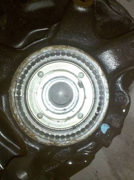

    i need help tearing these apart

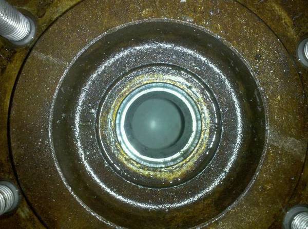

    these are off a 99 4runner but i cant figure them out ugh i just want to drill everything out of this damn thing

    Looks like they are pressed in.....

    If i understand right you are trying to replace the bearing. To get it out you have to put it on a press. or if you have the right tools they make a press that you can use with an inpact gun. Both ways are sometimes a biatch. But that is the only way.
    Oh and be careful not to mess up the abs ring or your abs light will come on.

    if your changing the spindles to camburg or tc you dont need to tear those apart. the drums comes off and then there are 4 bolts behind the hub that connect the hub assemble to the spindle. a wrench and hammers will do it for you. masada and myself did this a couple weeks back
    edit: just realized this was a first gen

    oh and to take it apart if your trying to do something like the wheel bearings...you need a special service tool :p
    edit: 2nd gen would need a sst idk about you. sorry i just jumped to the 2nd conclusion :(

    Your would still need an sst with that model

    just fab something up real quick that fills into those 4 holes (not even necessarily all 4) on the backside and gives you leverage to turn it free

    also, if your just trying to get the bearings out because your going to replace them, use a trick i just learned...weld a bead around the outer race fo the bearing...therefore when the weld cools, it will bull the metal in just enough to no longer have an intereference fit and will pop right out...well, at least thats what the mechanics at the local oil refineries say as to how they get bearings our of some of their pumps in the refinery! use at your own risk!

    Find you a nice 20 Ton Press and have at it. Just make sure you know what your doing first, or you will tear some shit up like you never thought was possible.

    ok thanks guys so much. so basically i need to press all of that out and it should be good
