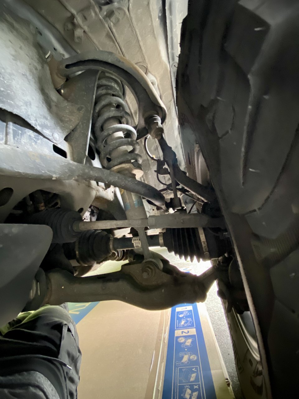

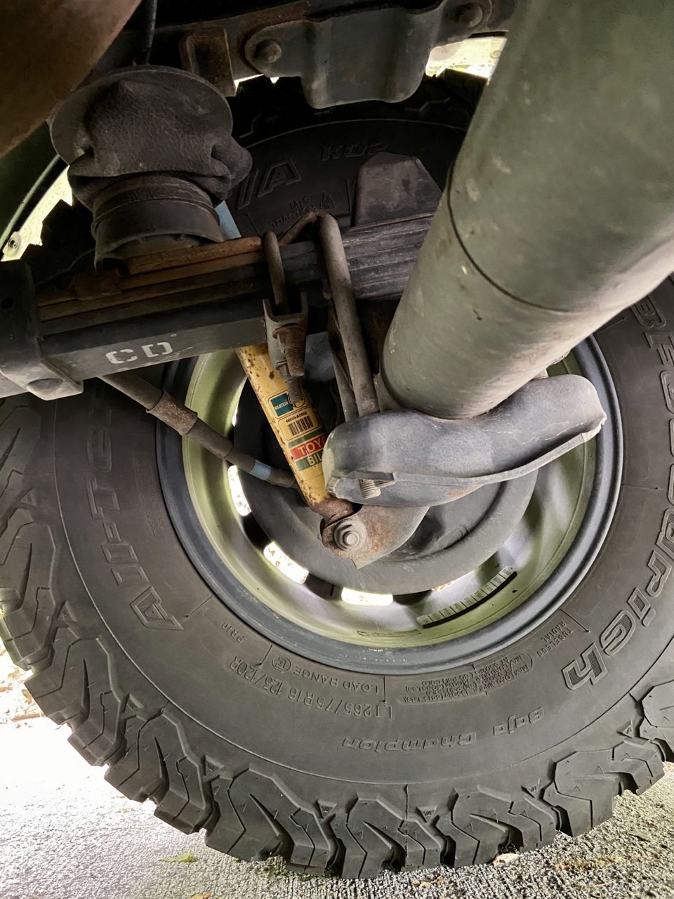

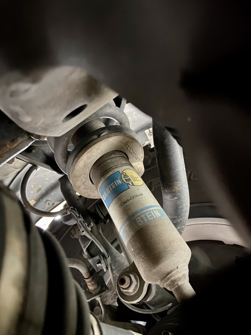

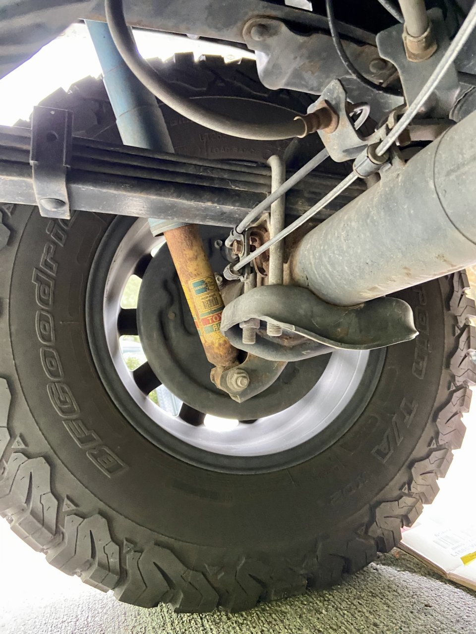

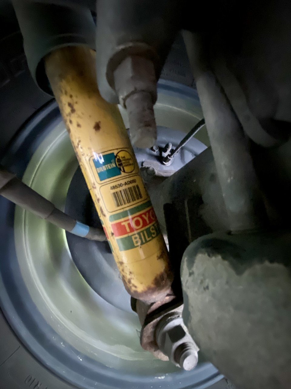

    Hey guys, I'm new to TW but have been searching this site for years for advice and tips - so I really appreciate all the insight! I've been researching this specific subject, and "think" I have a good idea of what to do, but wanted to see what people thought. I haven't made any changes to the suspension, so not sure exactly what I have based on what the previous owner has had done.
    Current Set up:
    - 2006 TRD Sport Double Cab w/ Diamondback rear cover (use RTT on bed)
    - Tires: BFG K02's 265/75/16 Load Rated E, 40psi
    - Front Suspension: Bilstein 5100 set at the 3rd notch (see photo)
    ** Not sure of Coils
    - Rear Suspension: Bilstein 4600?? (48530-AD050), Unsure of Leafs (see photos)
    ** The previous guy also had some airbags installed that are empty (see photos)
    The biggest issue is the rear suspension especially is SO STIFF! Like when I hit a small pot hole it just hits. People riding with me go "Ooof! What was that!?" Not exaggerating..
    So, what can I do to soften the ride?! I would love to get a lift on it as well, and have been reading about doing 5100's all around with the OME 885's up front. But do I need to replace the existing set-up up front? I'm not sure how old it is. I've had the truck about 3 years. Or should I just replace the rears with 5100s and see how that goes? I don't want to spend a ton of money to not fix the problem.. Do I need new leaf springs too?
    Again - I will have an RTT on the rear bed, and also will be installing a new Prinsu rack with the option of RTT up there. So I don't want it to not be able to hold that weight.
    Hope that makes sense! I'm not really sure what to get, so any help would be great!

    The leaves look like stock TSB leaves, and the offset airbags look like they have cradles under them and are not riding over the axle. I bet you are bottoming out on the airbag mounting hardware, and personally if they are not holding air and you are not using them, I would remove them. It seems the leaves have very limited take up. Load range E’s can be aired down a bit- 40 is pretty high for no load, but I bet the airbag setup limits your upward axle travel. If you are going to use the airbags, they should always have a little air in them- 5lbs each ish.

    Thanks so much for all your help! I went ahead and removed the airbags (good thing too, they both had cracks in them and didn't hold air anyway) and that helped tremendously! Muuuuuch smoother now. Thank you!
    However - now I'm still intrigued with the idea of lifting the truck AND I don't want to lose the capability to tow or to sag much when loaded down with the RTT and gear and such. So my question is should I keep the front Bilsteins, order new OME 885's for the front (re-adjust them back down to 0 with the new springs), get new Bilstein 5100's for the rear, and a new leaf set to level out the back with the front? I've seen a lot of discussion back and forth between the Dakar set and the 3-leaf AAL set from Headstrong. Is there a big difference?
