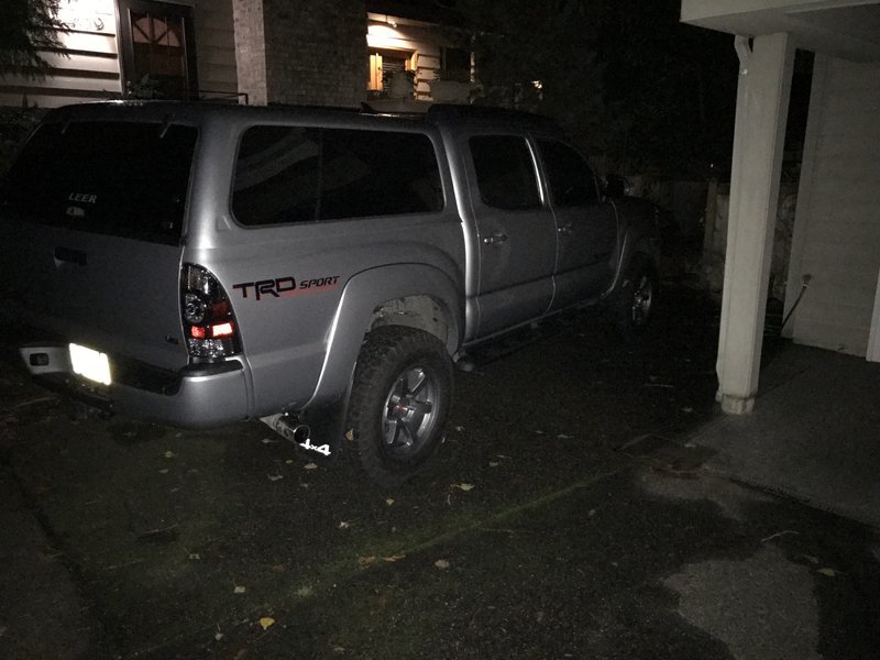

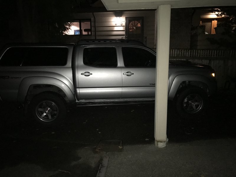

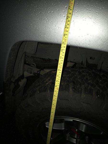

    Really hard to see because its dark, but it is what it is until the morning.

    It's hard to see but you definitely have a rake. My fronts didn't settle too much. You're probably in good shape up there but give it some time for the rears. What is the expected lift with the aal? 3.5 seem like a lot

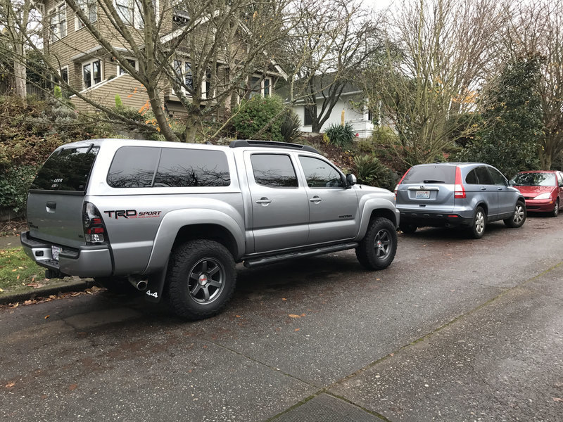

    Well, as it turns out, the back did settle quite a bit (1.5 inches) only after driving it around for 20 miles in the bumpiest, pot hole riddin' town of Seattle. Now it has the stock natural rake.
