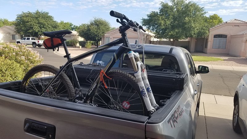

    The Rocky Mountain I just bungie the rear tire to a cleat, and the specialized fits without sitting on the bed rail.

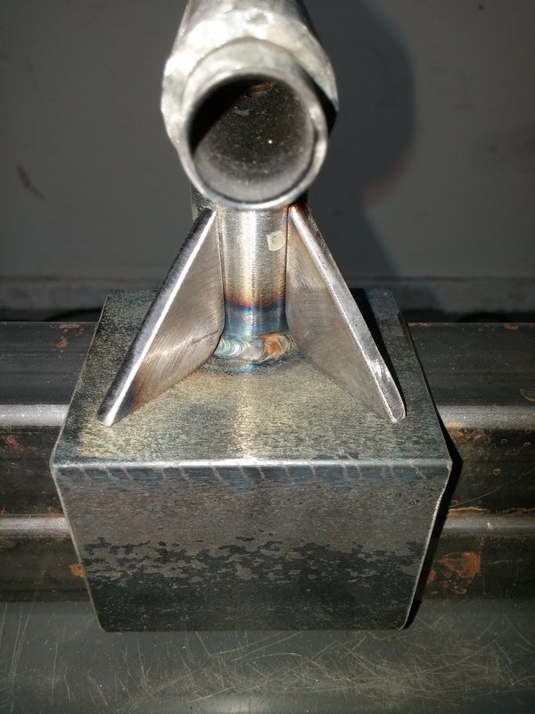

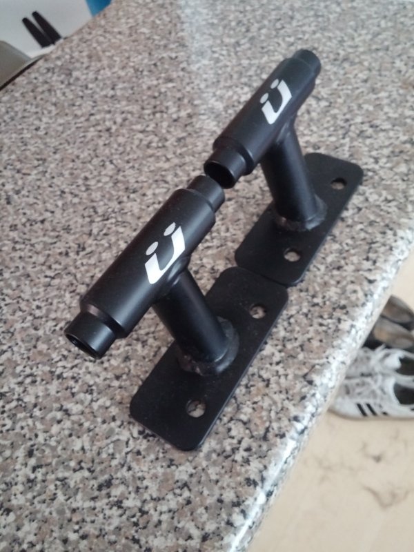

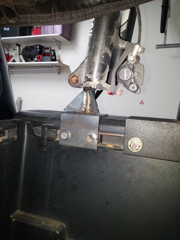

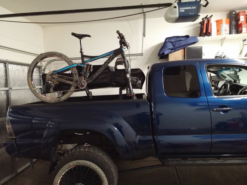

    Continuing from @virvak2 setup. The "OrikasaGarage mounts" are 15mm Kuat Dirtbag mounts modified to sit on side rail. Would work directly into the front rail without modification, but i have a tent so space is of the essence. Rear tires for the bikes on the rail are strapped to my rear bed bar. Could easily strap to the sliding D-mount instead. Mounts are surprisingly stable with only about 1" side to side sway at handlebars. Pair of these coupled with a 1Up and the tent as a platform, i can carry 6 bikes and 6 people with a tent and fridge in the truck.
