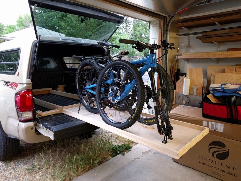

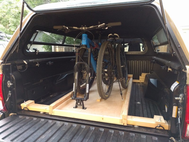

    Currently just in prototype phase, but this is my setup. Holds two bikes. Overflow goes on a T2/T4 pro. I need to make a rakattach copy (only better) for the T2/T4

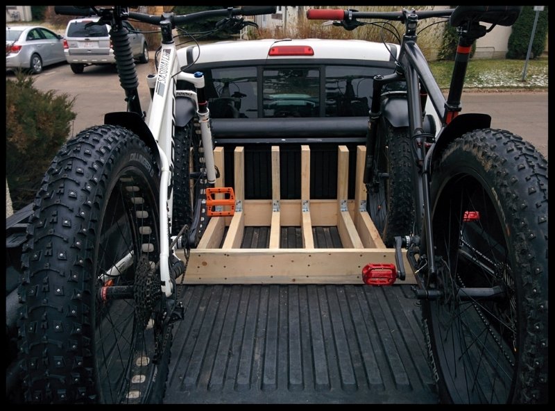

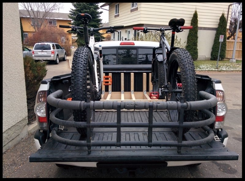

    Canada
    07 TRD Sport DCSB 6MT 4x4
    1" lift from 3rd gen suspension, 265/75/16 ATs

    I think I bought six 8 foot 2x6s and some angle brackets and screws. Total about $70CAD. Just need to paint it in spring once it warms up.
    I have the slots set up from left to right for 5", 2.4", 5", 2.25" and 5" tires. It should fit 3 bikes at the time and I still use a cinch strap to hold the bikes down. Keeps them fairly free from crud and slush in winter. For camping or overnight trips when I need bed for gear, I use Swagman XTC-4 hitch rack.
