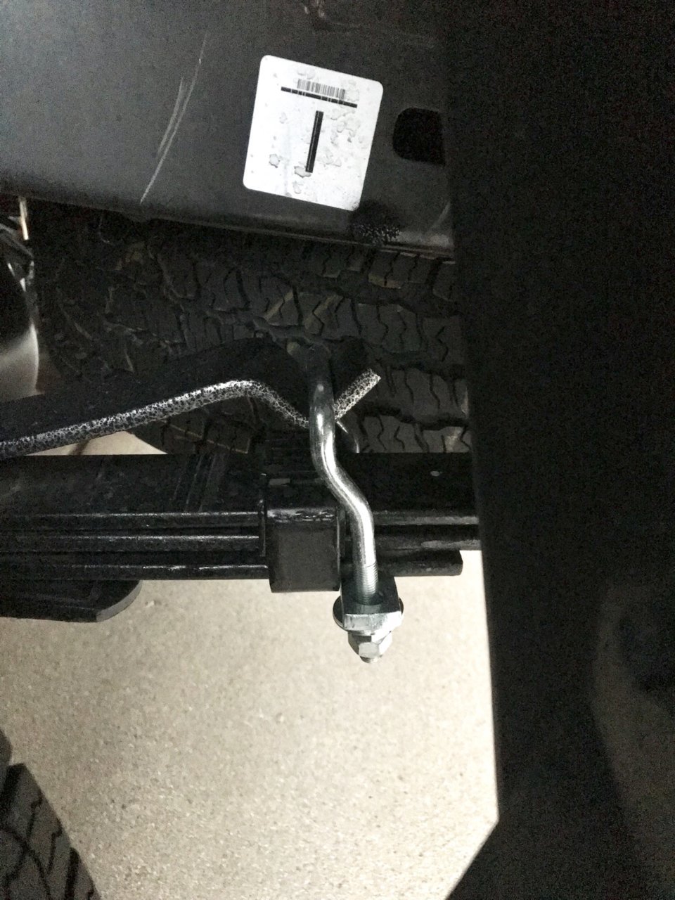

    The ride is fine on pavement but on rough fire roads it felt like I was bottoming out.

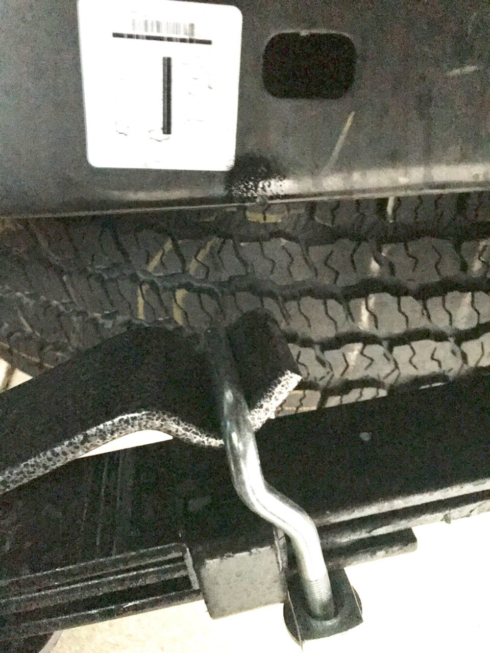

    I’m also not to happy about the fit. The u-bolts for tensioning the helpers didn’t fit perfectly and the back corner on the driver side was rubbing the frame so I had to sand it down.

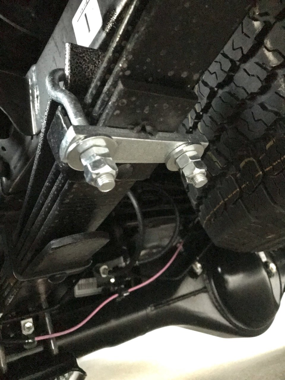

    Here are some pics. The black paint on the frame is where it was rubbing. The u-bolt didn’t fit great it’s slightly angled.
    On the bottom the bracket crushed that plastic thingy.
    Another side view
