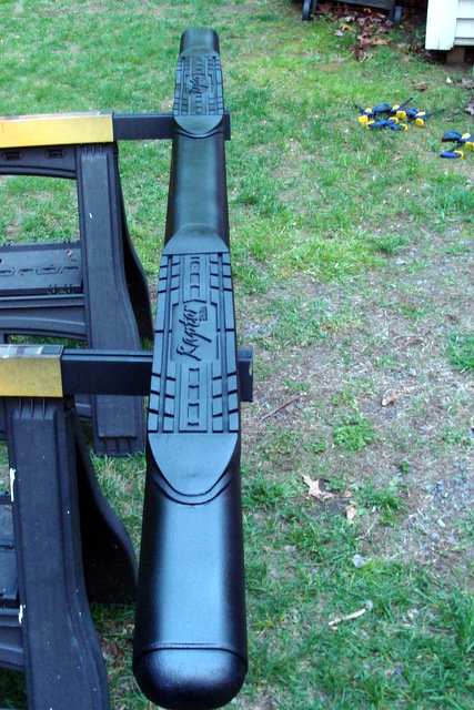

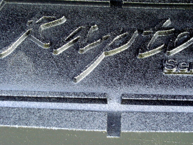

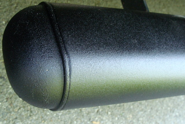

    I prepped & sprayed my raptor bars after one winter in Vermont.
    Originally they were black powder coated.
    I used Rustoleum Bed Coating spray (two light coats) after sanding them down & using a rust inhibitor primer.
    I also scuffed up the plastic steps & sprayed them.
    No chips & I can touch it up anyway with a brush if it does.
    They still look really good & have held up well after almost 7 months.
    Here are before & after pics.

    That looks pretty good! How easy do they chip or scratch now? Think they'll hold up to winter chemicals? Haven't thought about rustoleum...

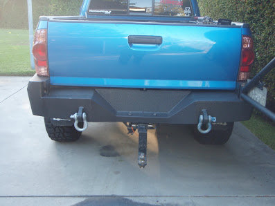

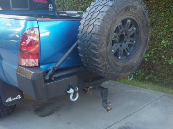

    Put 3 coats on my front bumper and on my skids...this stuff isn't going anywhere. Also put a coat of paint over it to hopefully prevent/resist fading in the Florida sun

    They haven't chipped or scratched whatsoever. Really not much fade either.
    I have used a powerwasher in DIY car wash w/o any problems even on the plastic.
    one light coat of the rust inhibitor & two light coats of the bed coating.
    I bought this little nifty hand spray gadget that pops on top of the can so it made it easy stay easy on the trigger.
    It was hanging in Lowe's paint section for like $6 & 4 cans of spray, 1 can of RH & military discount less than $40

    Man that bumper is sick! I want one :spy:

    just did my rear bumper in line x
