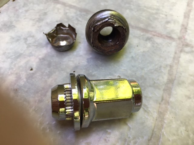

    So my '06 has been through many lug nut install/removal cycles. Some by me, some by dealer shops, tire shops, etc. Yesterday during a tire rotation, I noticed several nuts were dented, with damaged corners on the flats. A couple were so damaged I could not get a socket to seat. Finally I tore the top off one of them, trying to remove it! I wasn't using an impact tool, only a 21mm socket and an 18" breaker bar.
    Come to find out, there is a thin outter shell over the actual lug nut! Who knew? I was able to remove the damaged top and use a 7/8" multi-point socket to remove the remains.
    Needless to say I have replaced all the lug nuts with SOLID longer flat aftermarket 21mm nuts.
    http://www.ebay.com/itm/390841758304?_trksid=p2060353.m2749.l2649&ssPageName=STRK:MEBIDX:IT
    Top: old torn nut
    Bottom: new longer solid nutsIMG_0346.jpg

    They are a stainless steel cover over a steel nut. Some have reported of the inner nut corroding and swelling to the point where the socket wont fit over the nut. Toyota cheaped out to save money and weight.
