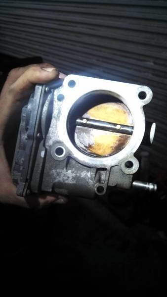

    soooo has any one ran into my problem ?

    Does anyone else have this problem when they go to pass anyone . Could it be that I never cleaned the throtlebody . coud it be a filter . Id like to fix this if anyone knows

    Check out the sticky on here about cleaning the MAF sensor and the throttle body.... I did mine at 85,000 kms and it made a very significant difference in throttle response (not that mine was bad).... It's a preventative Mtce. thing..... Yours needs it BAD if it has not been down yet..
    Good luck

    it might just needs cleaning then since I have never done it . Ill get back to you guys after I do it

    I took my TB off and forgot to take the pic of how black it was. Ever took your finger and stuck it down a diesel pipe . Well that's how black it was . It couldent get anymore black and gunky. I think theres still a little hesitation but not as bad as it was before .
