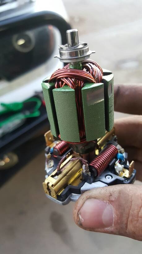

    One repair:

    Nice find! Burnt comm wire acting as a fuse could confirm why the pump fails first and i have only heard of 2-3 blown pump fuses. Other failures have been shorted windings from overheating and corrosion/degradation of the brushes and comm. The over current damage is usually because the pump vanes are deteriorated and causing drag and the motor draws more than its rated current.
