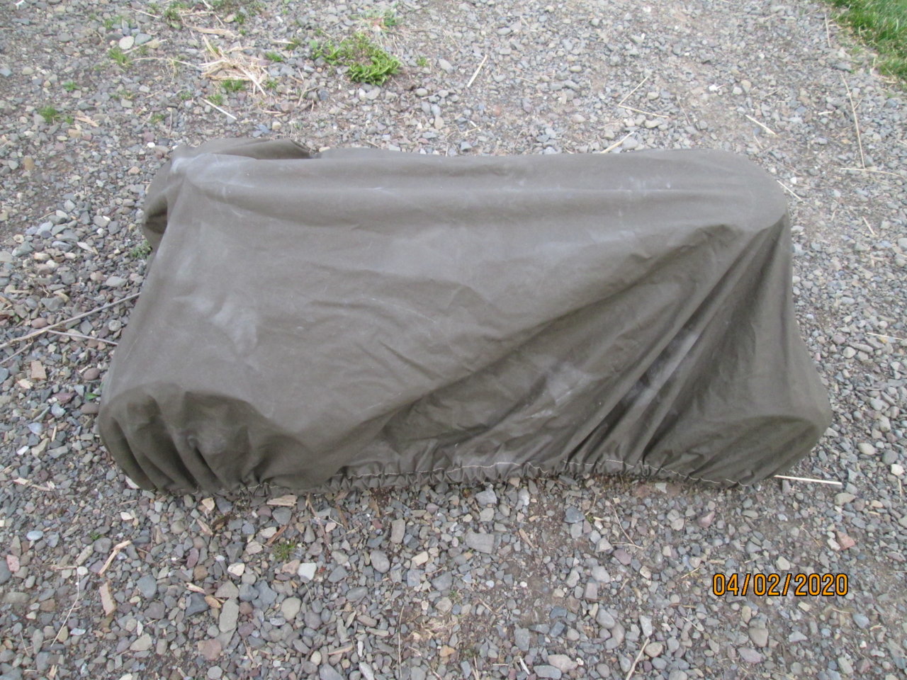

    Finished.... And a cover to keep it clean and sporty made from an old Bundeswehr poncho...IMG_3853.jpg
