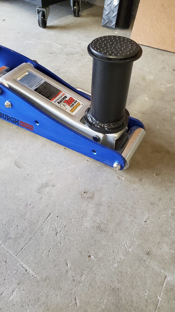

    And the skid plate. DIY as well. :cheers:

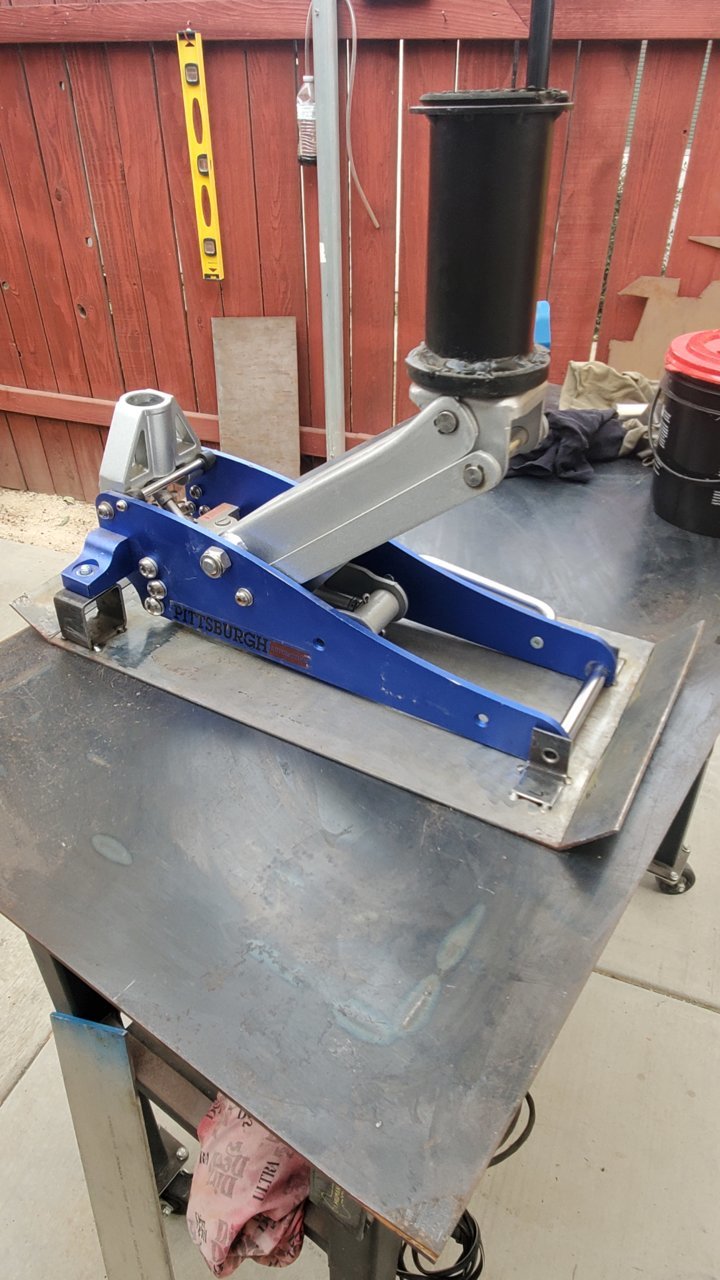

    can you please explain the process of making that skid plate? I'm about to try making my own as well but I'm not sure if I should use a self-tapping screw, or maybe just jb weld the plate to the bottom of the jack. Also debating keeping the wheels or not
  7. May 17, 2021 at 1:37 PM
    #87
    ktmrdr
    ktmrdr Well-Known Member
    Aug 26, 2015
    #162756
    417
    Basically used 0.125" thick Aluminum sheet. Set the jack on top of the sheet and trace around it. Leave the two ends long, maybe an extra two inches. You will bend these up later so it can slide on the dirt and not dig in.
    Cut the plate out. I used a jig saw with a makeshift fence as a guide. File the edges clean. Hit it with an electric sander to give it a jitterbug appearance (optional). Lay the plate on the jack and draw and a line on the plate that will hit the centers of each side where it will be screwed to. Drill the holes in the plate then counter sink for the screws. I think I used M4 SS machine screws. Once you have all the holes drilled, line it up with the bottom of the jack. Drill and tap the holes in the jack. Attached the plate to the jack then bend up the front and rear of the plate. Done

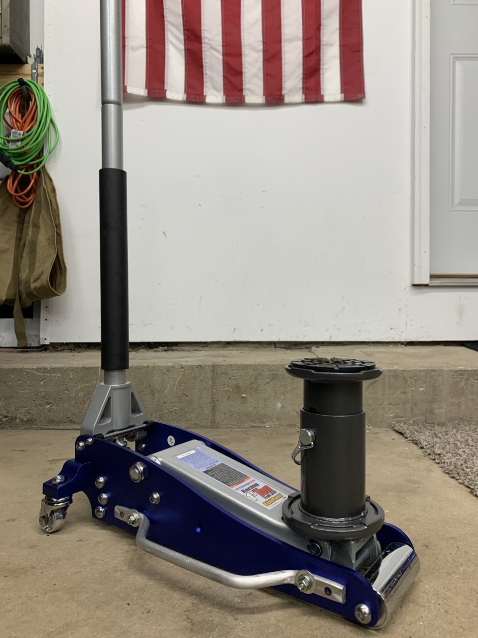

    mostly stock, grocery gettin' Prius
    Joined the club:
    C5ABD191-82B9-49A9-B866-CB42A3BED674.jpg 7E1E7B89-D4D0-4D23-9F4E-91CB9F75222E.jpg

    What did you do to mate the 1.5 ton to the proeagle pad thingy. I have all the parts, but the HF center doodad for the 1.5 ton is too small to mate with the proeagle pad.
    I started thinking about cutting the center of the HF pad out and grafting it into the proeagle pad lol
    geekhouse23[QUOTED] likes this.

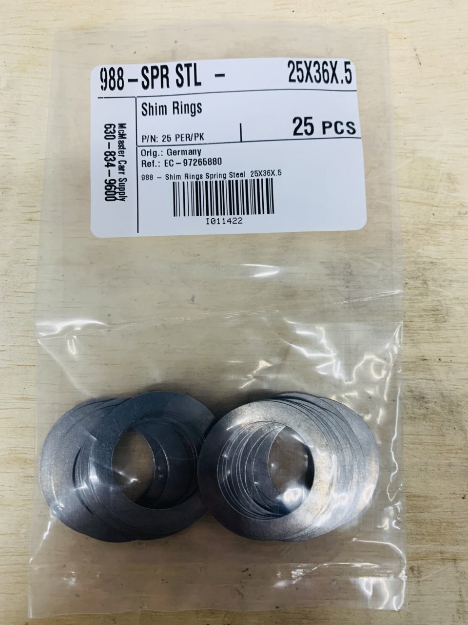

    @y=mx+b
    McMaster-Carr
    1074-1095 Spring Steel Ring Shim
    0.5mm Thick, 25mm ID
    98055A254
    deanosaurus and y=mx+b like this.

  19. Oct 14, 2021 at 11:17 AM
    #99
    geekhouse23
    geekhouse23 The "Liftman" - @DrFunker
    Jul 14, 2013
    #108251
    15,717
    2GMGMDCSB4WDTRDFTMFW!! TL;DR
    McMaster Carr ships FAST:
    essjay and y=mx+b like this.
