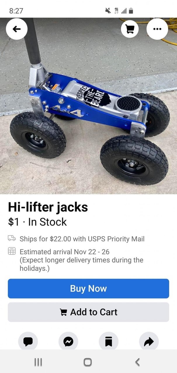

    Saw this on a Facebook page:

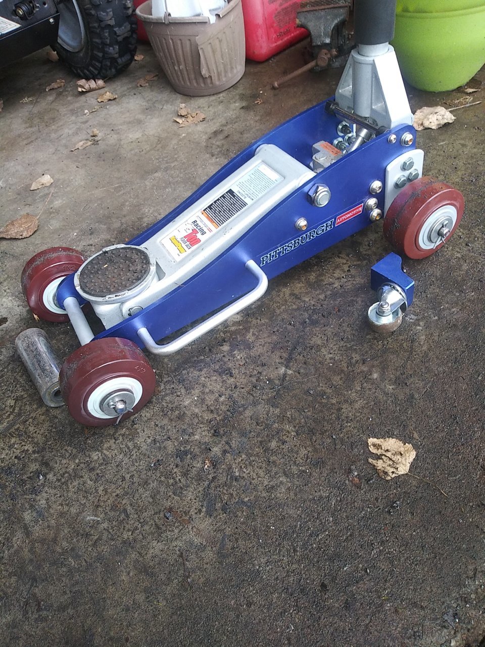

    Here's my Harbor Freight 1.5T with my homemade 4" wheel kit.20220102_132722.jpg

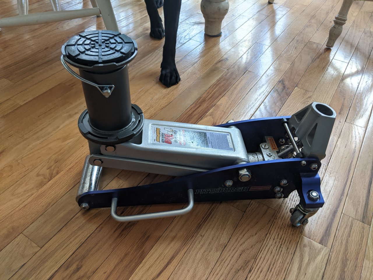

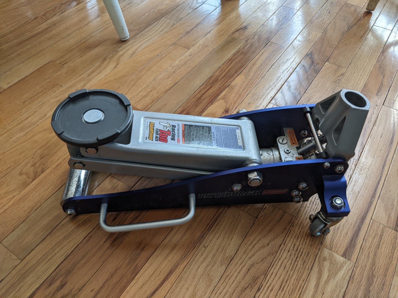

    Forgot to come back with these oopsie
    The shim rings go in between the Pro Eagle pad and the HF center pin. The HF center pin is smaller than what is intended for the Pro Eagle pad, so the shim rings fill the gap
    The shim rings ID is perfect, but the OD needs to be shaved a bit. I tried doing it the other way with a washer of proper OD and an ID that needed drilling, but that did not turn out well. Shaving down the OD was much easier. I used 3 shim rings total
    I used this disc sander setup I made for my lathe
    [​IMG] [​IMG]
    This is how much I needed to shave down the rings for proper fitment
    [​IMG] [​IMG]
    And here is the final assembly
    [​IMG] [​IMG]
