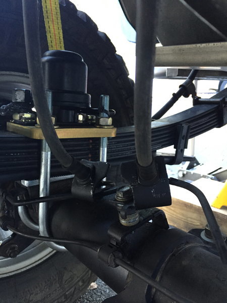

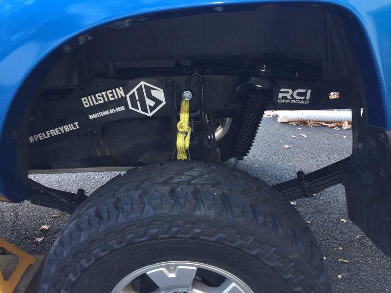

    Thanks for your help and guidance on my brake lines the other night. Very much appreciated. I tried again today and the damn flare nut wouldn't budge.
    So I did a makeshift limit strap (Nick's suggestion) and added spacers to the axle bracket in this AM so I could go wheeling this weekend.

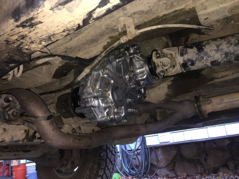

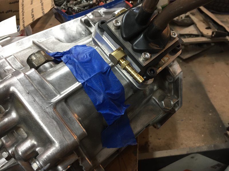

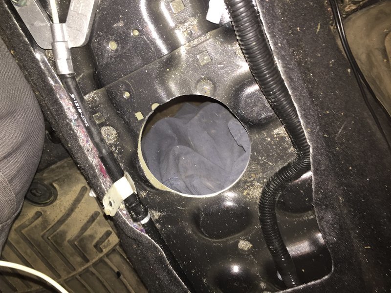

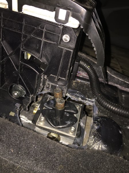

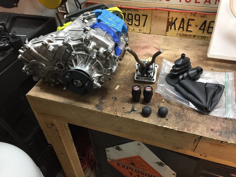

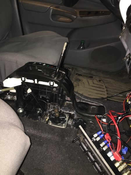

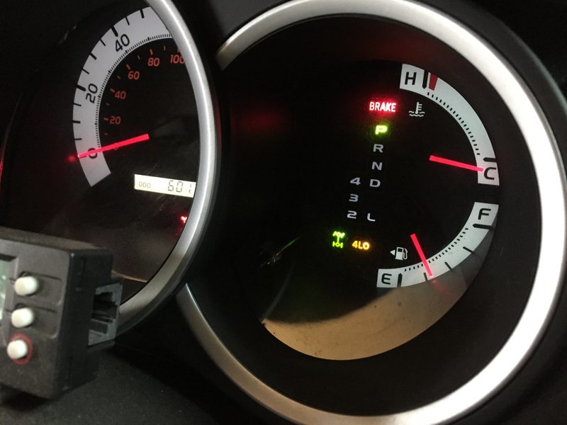

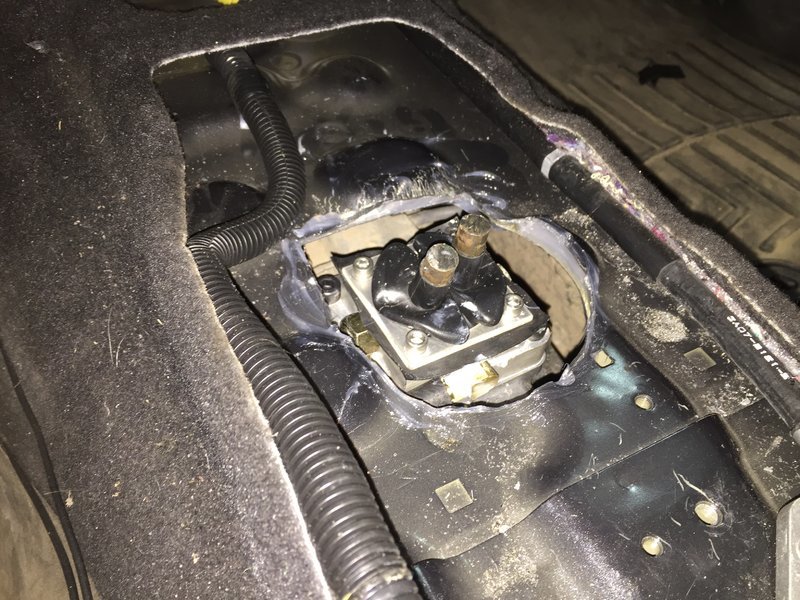

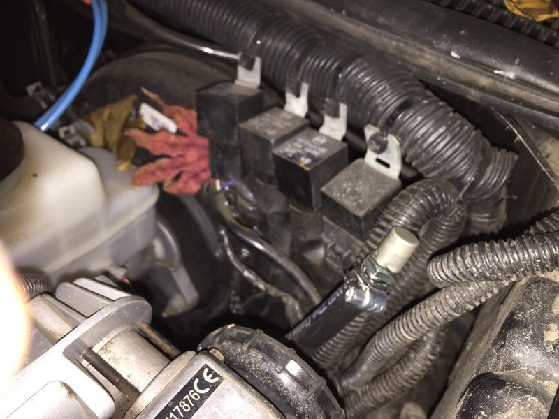

    Well, it's in.
    Had to put my stock Y pipe back on. I forgot the gaskets for the Pipe Bomb were different than stock
    The hole has to be good size. The T-case moves quite a bit. I started with a 4 1/8" hole saw and trimmed as needed with a body saw.

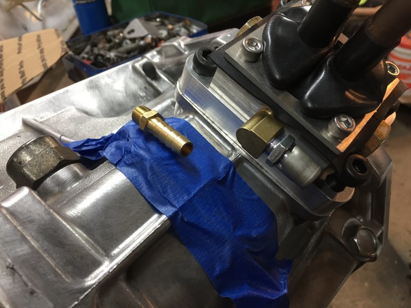

    The breather for the T-case is in the shifter base. I put a barbed fitting in it, ran 5/16 trans line up to the engine bay, and capped it with the supplied breather.

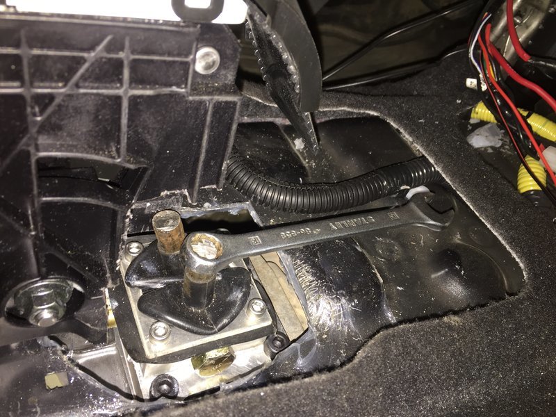

    Had to trim the shifter tower a good amount to clear the sticks.

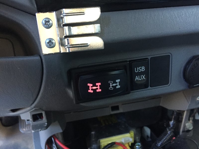

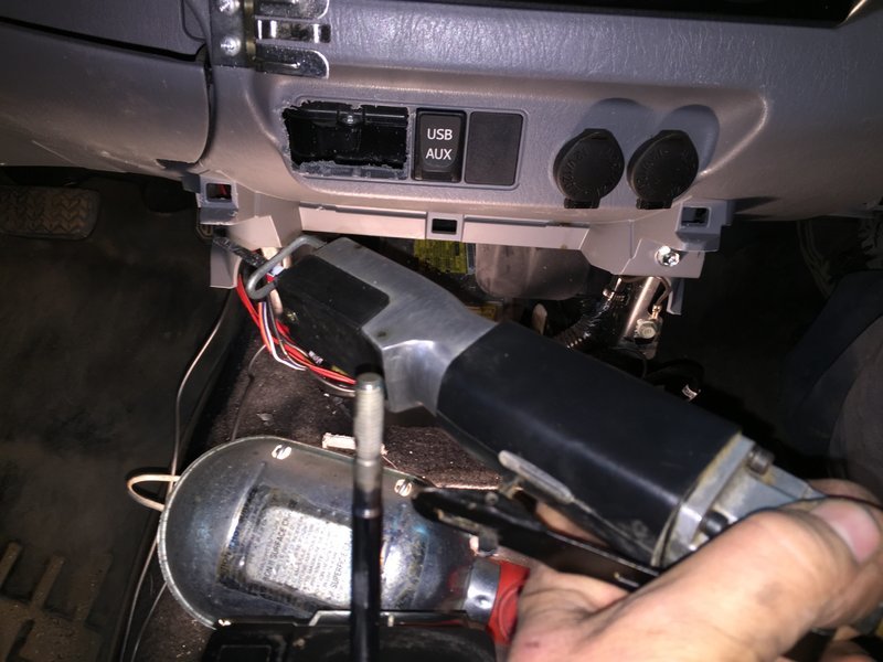

    Broke out the body saw again to turn these two switch blanks into a spot to put the ADD switch. I could've had both sides of the switch aluminated. Both sides are red though. I think it's better to just see red and know it's engaged without thinking about it. So, I only wired one light.

    Customer shifter until twin sticks are finished...
