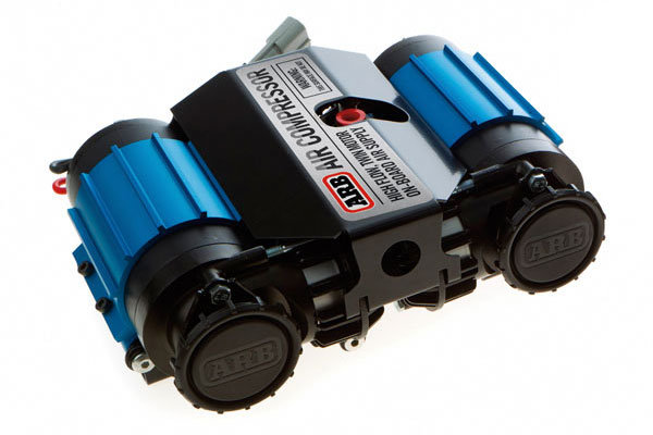

    '12 t|x pro
    you swapping it or adding it? adding it for tire air i assume? adding a tank for this project?

    I already have my lockers wired up to their small compressor. That's all working perfectly. I don't see any reason to mess with it right now. The twin will be for airing up and such. Right now I'm planning to add a tank. I need to do some research. The compressor was kind of an impulse buy when I saw the price.
    I do have all winter to screw with it though. I may end up running the lockers off of the new compressor as well.

    5 gallons seems an little big, no? If it'll fit, bigger is better I guess.
    I was looking at the locker manifold that ARB sells. I'm thinking of running the lockers off the manifold. Then running a line from the manifold to the under bed mounted tank. Then another line to a remote quick release.
    I have a couple of BIG ammo cans. I want to mount the compressor and manifold in one of the ammo cans mounted to the bed rails. I figure this'll keep the compressor and locker selonoids out of the weather.
    That just leaves a pressure switch. I believe the compressor has a switch built into it? If so, it should work with a tank too, right?
    I'd also like to put a water seperator in line somewhere.

    Personally, screw ARB and that overpriced manifold. A brass T and two $8 solenoids will do the trick.
    The pressure switch should be on the compressor, so adding a tank will not require an additional one.
    The pancake tank is not a bad idea if you have room Lloyd. And provided you are not tearing down a working compressor to do it.
