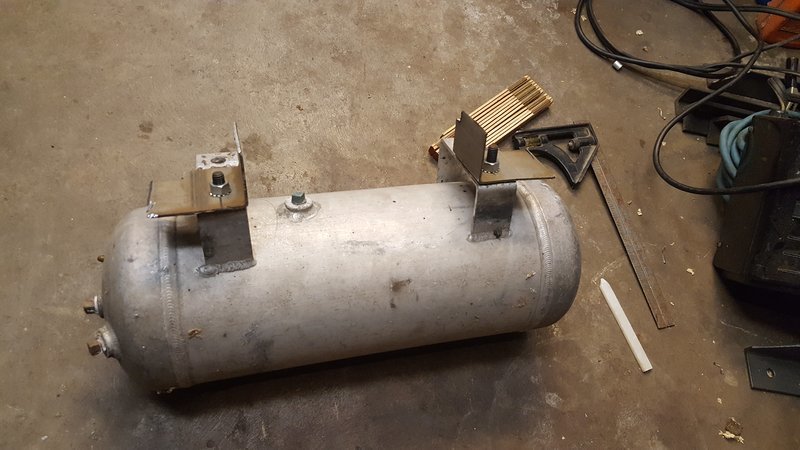

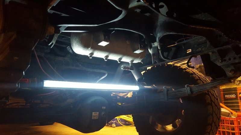

    Fabbed up some quick brackets and welded them to the front of the crossmember. Will put a ball valve in place of the quick disconnect to drain it, and will use three other ports for air in from compressor, air out to locker manifold, and air out to quick disconnect in the cubby. Might add a quick disconnect up front somewhere also. Perhaps once I revamp my rear bumper to be a HC, might hide a disconnect behind the license plate. Front one may go into a recess in front bumper. That way I can make up a shorter hose to air up. Have a unique set up for that planned also.

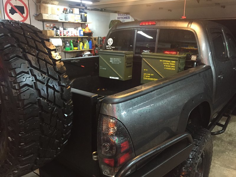

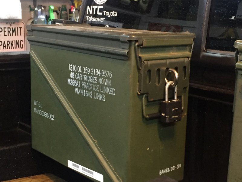

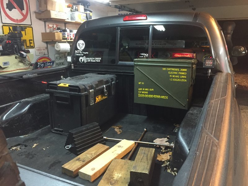

    One for storage. One to put the compressor in.

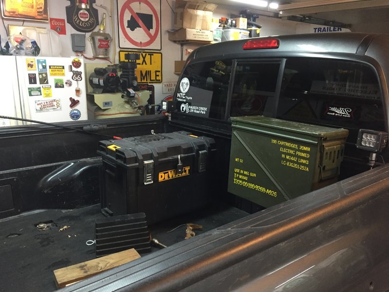

    Is this messing up the use of the underbed tire carrier?

    Yep. No room for a spare now. But my spare would not fit anyway.
