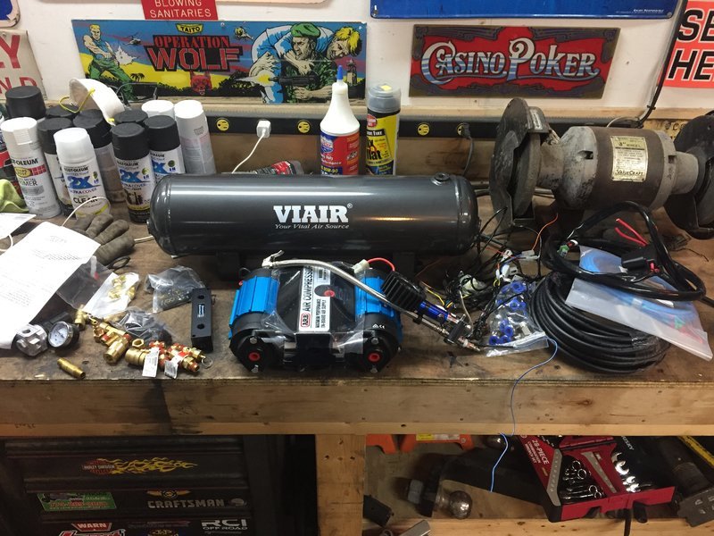

    Alright, here we go...

  17. Dec 5, 2016 at 7:20 PM
    #377
    stairgod
    stairgod NOOB
    Aug 16, 2015
    #161924
    7,965
    Jo n
    PA/NJ
    2011 MGM Trail Limo
    Locked Boosted 35s
    Steel tank? Booooooo
    But regulator and blow off valve :thumbsup:

    how do you run an air line from the compressor to the tank, for filling?

    Ha! I got the Viair because it's a little smaller in diameter. It will JUST fit under the ammo cans if I go that route. I can't decide where I want to mount everything. Thinking about putting everything in the cab now.
    I need to figure out, you probably already know, if it matters where in-line I put the manifold. I'm thinking it does not. I'd like to go compressor > water separator > manifold with locker selonoids > regulator > tank > quick connects front and rear.
    No reason to put the manifold after the tank, right?

    Well, something I hadn't thought of, seems I need braided line or copper off of the tank to either the manifold or tank. I guess you have to worry about plastic line melting right off the compressor.
    Makes sense though.
