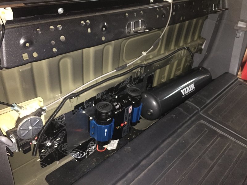

    what I was thinking, was to put a small tank in the rear, and have the compressor in the engine bay. So I can use the rear tank for filling stuff in the back of the truck.
    Its not like putting a small air hose into a T fitting, on the compressor? I have no idea what I am doing though. You guys will be my "lead from example"

    It doesn't matter where the tank is in relation to the compressor. It's all the same system. You just need to run the quick connects from the tank to wherever you you'd like them to be. I'm using all 3/8 push air line.

    Not sure what all that stuff is with the air hose, but 3/8 will cover your requirements. No need to go 1/2" IMO. I ordered all my fittings and line from eBay.
    You don't need the manifold if not using lockers. You can easily add it later. If you want to add another quick connect, you'll just need to T off the tank. The compressor only has one outlet. If you're going to run a tank and no manifold, everything will come off from the tank.

    I guess I'll just do it right and go compressor > tank > manifold > and so on.

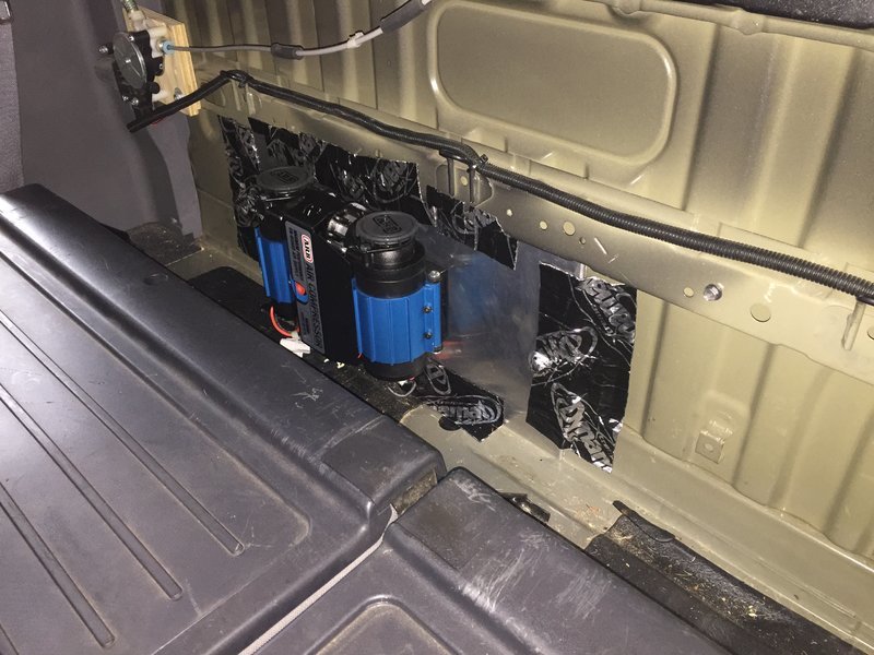

    Had a spare piece of aluminum, well actually a VP Racing fuel can holder that I cut up, laying around. So I made a simple panel type bracket thingy to mount the compressor to.
    I used the little tabs that're behind the storage compartments to bolt the aluminum panel to. It's only bolted in the center of the panel on both ends. I made six little rubber feet to go between the panel and the cab. Then used some extra Dynamat around the edges. It's overlapping the panel right onto the cab. It's very secure and should keep everything from rattling. That Dynamat is really adhesive. Especially when you hit it with a heat gun.
