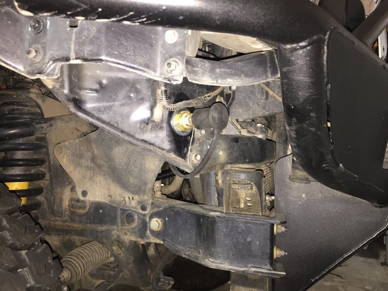

    @stairgod Are you running the ground all the way to battery or chassis? That's even bigger than 8 gauge. 6 maybe?

    Chassis more than likely.

    That's what I was planning to. Good to have a second opinion though.

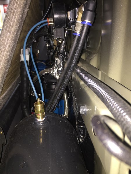

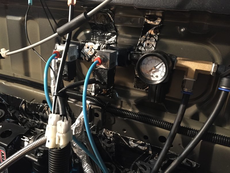

    Done. Just waiting on a couple of elbows from ARB that screw into the vents on the locker solenoids so I can vent them outside.

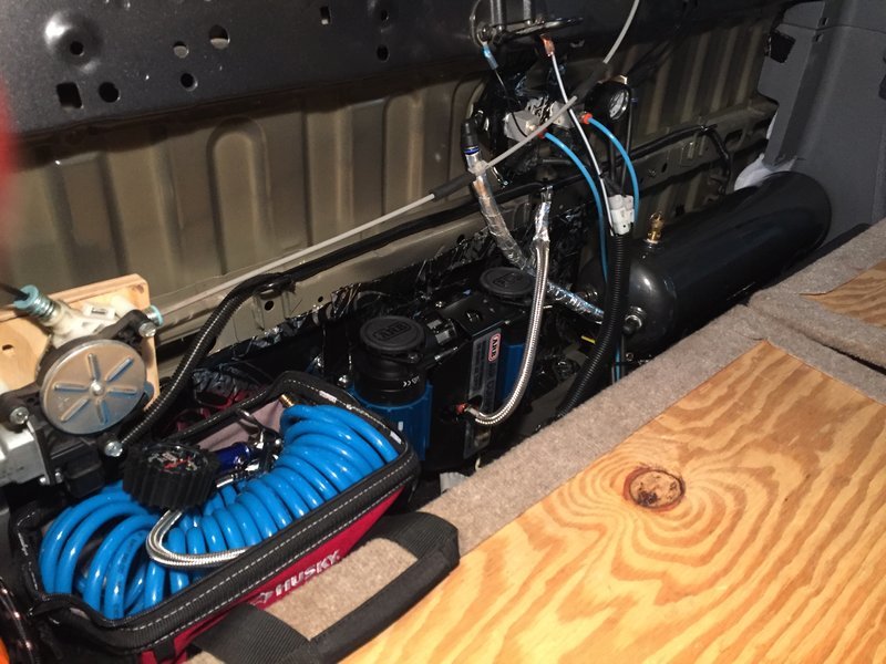

    Damn nice work as always Tim. Any concern about the compressor getting hot in there?
  19. Dec 12, 2016 at 6:43 AM
    #439
    HolyHandGrenade
    HolyHandGrenade [OP] NOOB
    Mar 25, 2013
    #100579
    11,801
    Tim
    Garage Most Likely
    DCFB (RIP)
    Some Stuff
    Thanks Mike. There's enough airflow back there I think. Each motor has its own cooling fan. I'm less worried about heat than I would be if it were in the engine compartment though.
    There's also a built in thermal cut off if it does get too hot.
    Worst case, if I do think it's getting too hot, I'll just drop my dog platform down if I use it for an extended period.

    What thread is on the vents for the solenoids?
