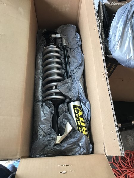

    @Wheelspinner has dibs on the UCAs if I sell those and if he still wants them. He was going to buy them before and I got all indecisive. And that's rare for me... right @Sub-Zero

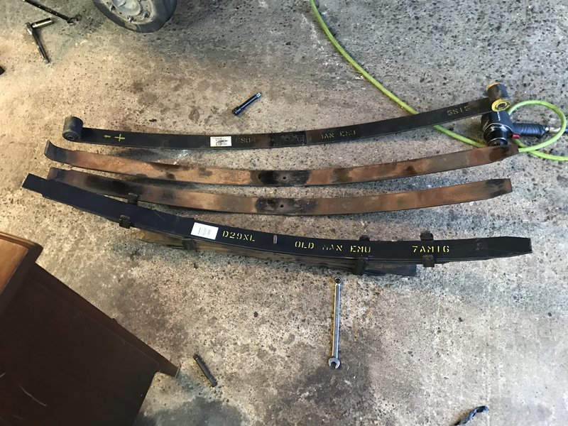

    so did you take out a leaf? or just add the d29xl ?

    Garage Most Likely
    DCFB (RIP)
    Some Stuff
    fatfurious2[QUOTED] likes this.
