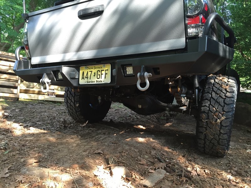

    Archive shackle flip installed

    Any tips for cutting for the hc rear. Just recieved my brute force the other day and cant wait to get it on.
  11. Aug 28, 2016 at 4:26 PM
    #91
    HolyHandGrenade
    HolyHandGrenade [OP] NOOB
    Mar 25, 2013
    #100579
    11,800
    Tim
    Garage Most Likely
    DCFB (RIP)
    Some Stuff
    Just measure from the top of the bed side to the bottom of the tail light. Match that measurement at the rear wheel. Tape, Mark, remeasure, and cut.
    I used a die grinder. If I did it again, I'd use an angle grinder. The bigger blade will get you through the metal and the flare at the same time.
    Also, I popped the plastic off the top of the bed rail. It moves and is hard to get an accurate measurement from. I also placed a block of wood on top of the bed side and measured off of it. This way I could measure straight down without the curve of the bedside throwing things off.

  15. Aug 31, 2016 at 6:30 PM
    #95
    HolyHandGrenade
    Mar 25, 2013
    #100579
    11,800
    Tim
    Garage Most Likely
    DCFB (RIP)
    Some Stuff
    This is all the write up I did, but here's the thread https://www.tacomaworld.com/threads/2005-2016-archive-garage-premium-shackle-flip-lift-kit.403630/ All kinds of info in there. Around page 18-20ish is where Eric (the OP and builder of the kit) changes the brackets to be Dakar friendly out of the box.
    I didn't measure, I never do..., but the rear is visibly higher. Eric @ARCHIVE said to expect about 3/4" with the 45* positioning. Seems about right to me.

    Damn - truck is looking very bad ass. When are you gonna put up the tire carrier? Did the rear bumper have cutouts for LED lights? I was impressed with @cynicalrider 's rear LED lights when he graciously turned them on for me when we arrived late night at theTakeover.

    Thank you Lloyd. The tire carrier was sold a while back.
    Light cutouts are an option. I actually ordered mine without them, but they were there when it arrived. I'm glad they were now though
