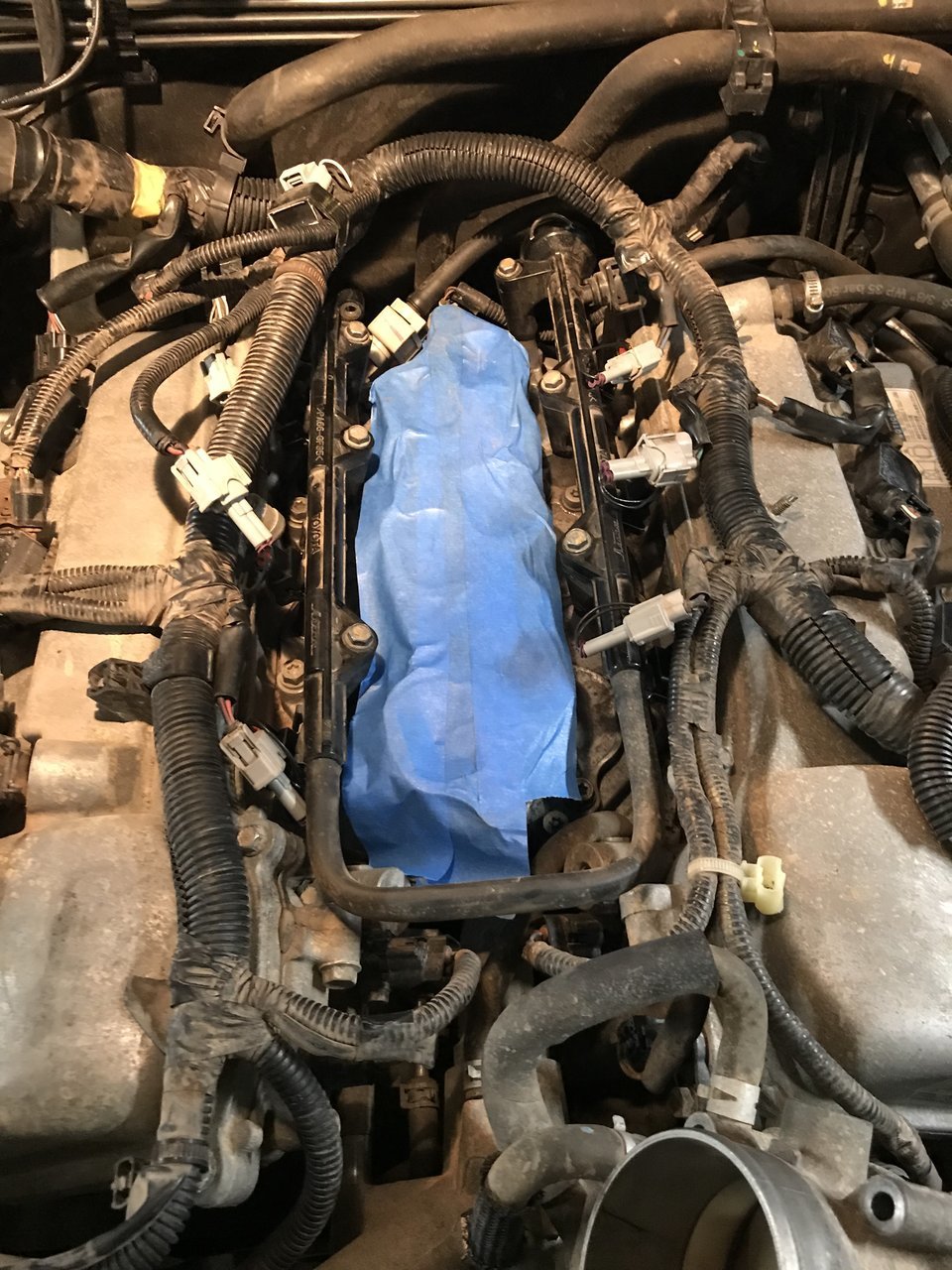

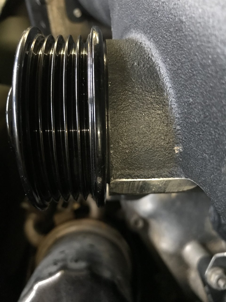

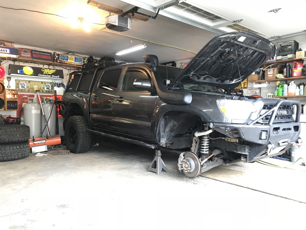

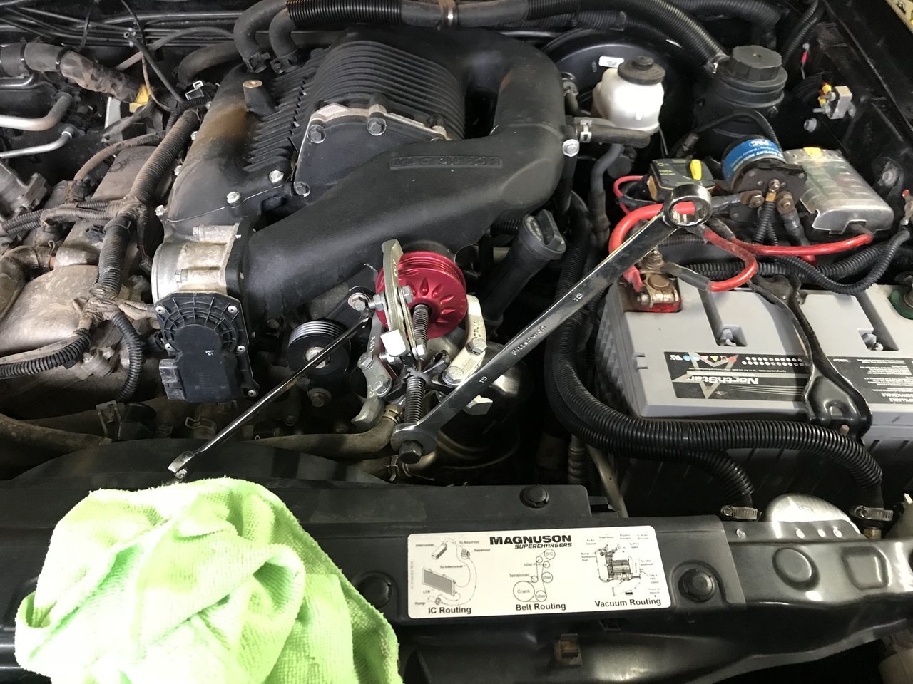

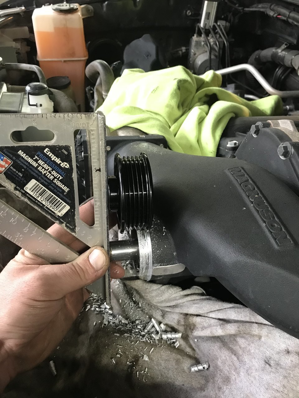

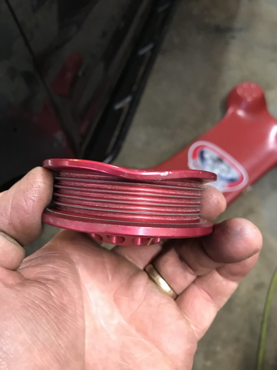

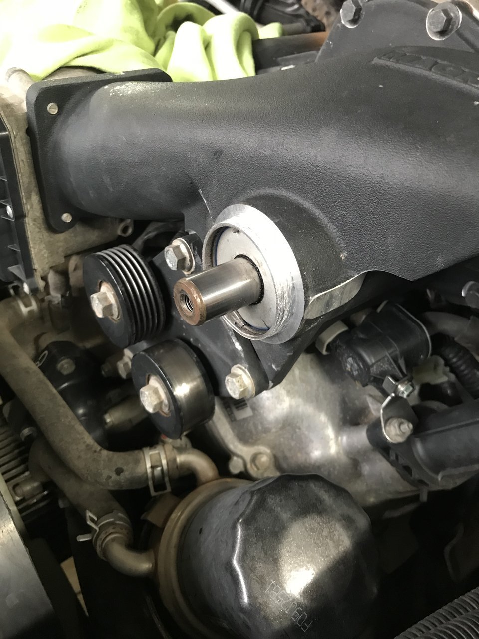

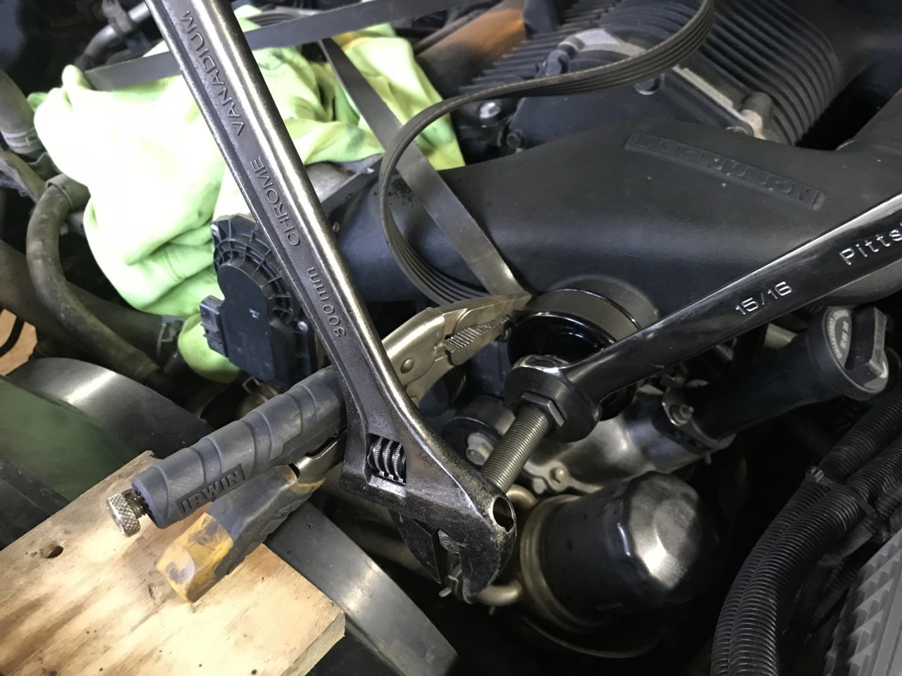

    2.825 pulley pulled, Snout cut back 10mm (good call @Roostfactor ), 2.55 pulley pressed on, 61 lb injectors & adapter harnesses installed.
    Spark plugs arrive Wed, intake Thu, so I’m waiting on parts to proceed.
    First, I pulled the front tires for a more reasonable working height.
