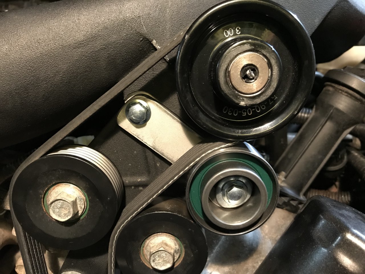

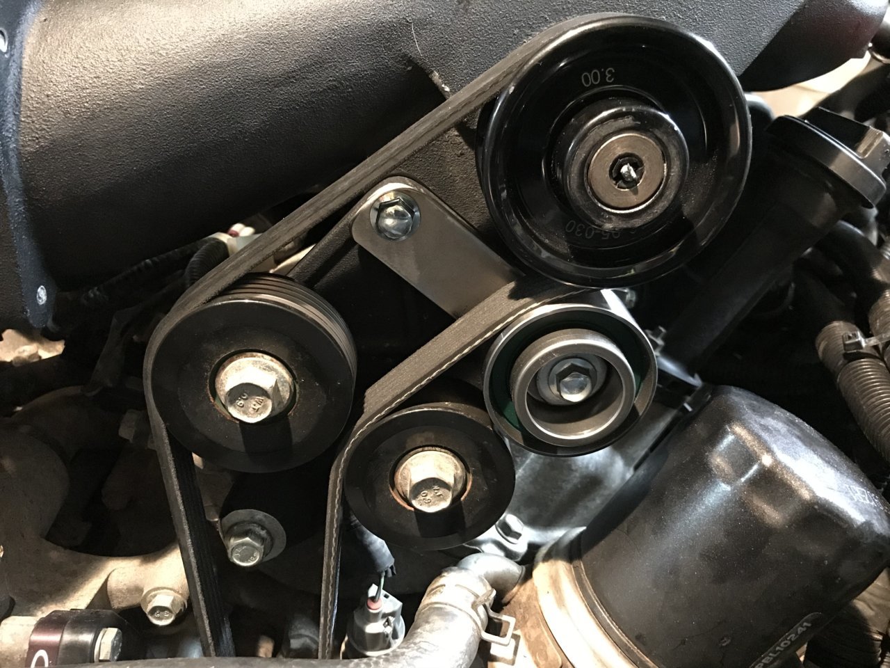

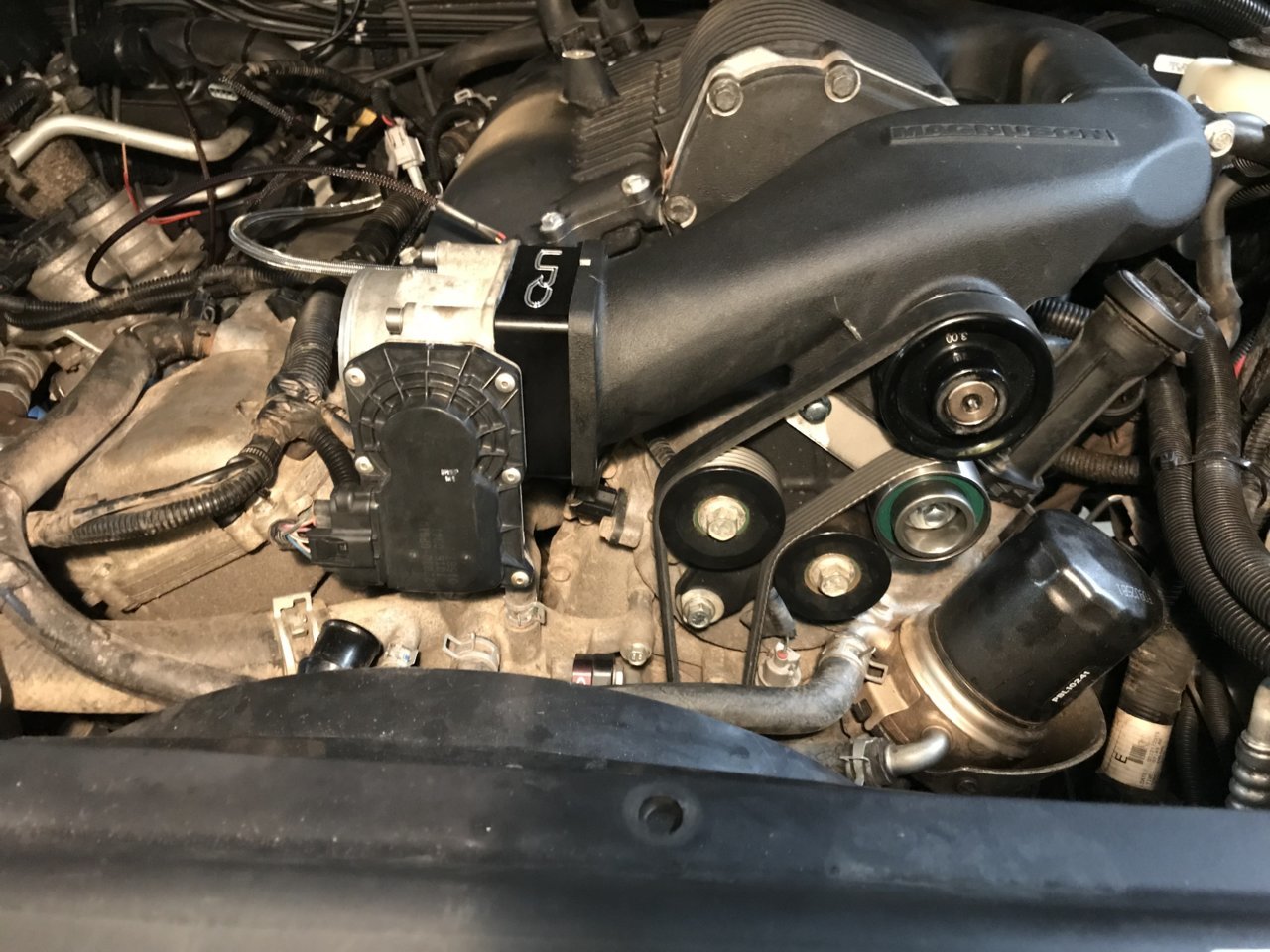

    OK, Blower back on, 7th injector bolted down, and @Roostfactor pulley wrap kit installed.
    I really like the pulley wrap kit. It bolts right on, is adjustable, an looks like it’ll do just what it’s meant to. What more could you ask for? Well done John :thumbsup:
    And thank you @loginfailed , for letting me have the one that was meant for you, so I could get it installed right away.
    Tomorrow night, I need to plug in the expansion harness, wire the 7th, and finish installing the intake. Then, a new tune with Scott Sat.

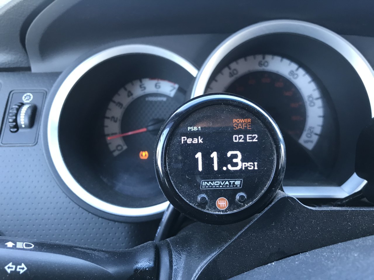

    So, that went well

    What was the pre-wrap number?
  19. Mar 31, 2018 at 10:48 AM
    #1139
    HolyHandGrenade
    HolyHandGrenade [OP] NOOB
    Mar 25, 2013
    #100579
    11,800
    Tim
    Garage Most Likely
    DCFB (RIP)
    Some Stuff
    I didn’t run it with the new pulley without the wrap.
    The 2.825 pulley was a consistent 8-8.5 PSI peak. It hit 9.8 once up in NH on a -17* F morning.
    That extra 3lbs or so makes a substantial difference. The truck actually feels fast-ish now.
    I like it.
