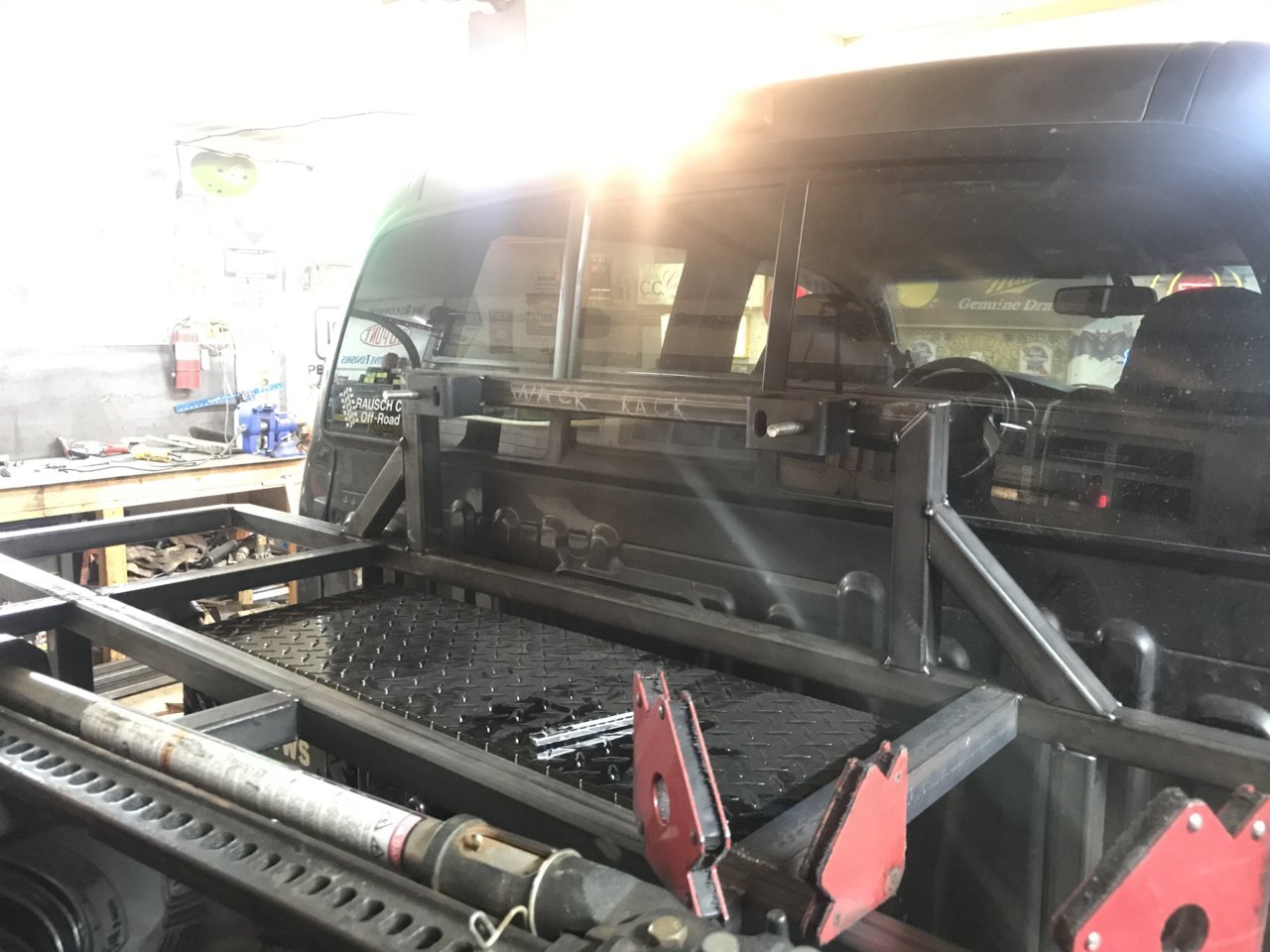

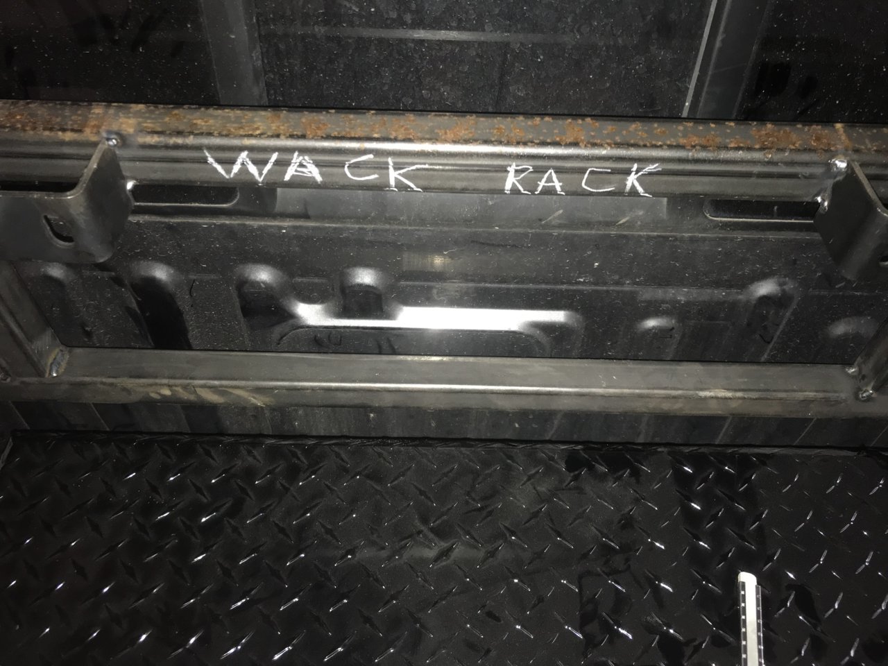

    Head board to mount High-Lift and shovel
    Shmellmopwho likes this.

    Removed for finish welding and hole drilling.,

    Primer, paint, bolted down.

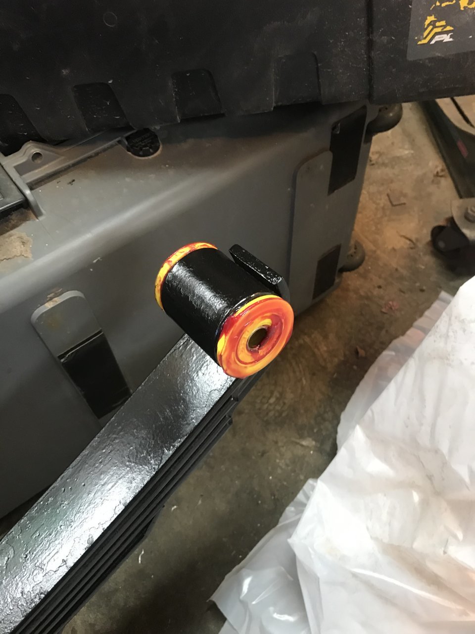

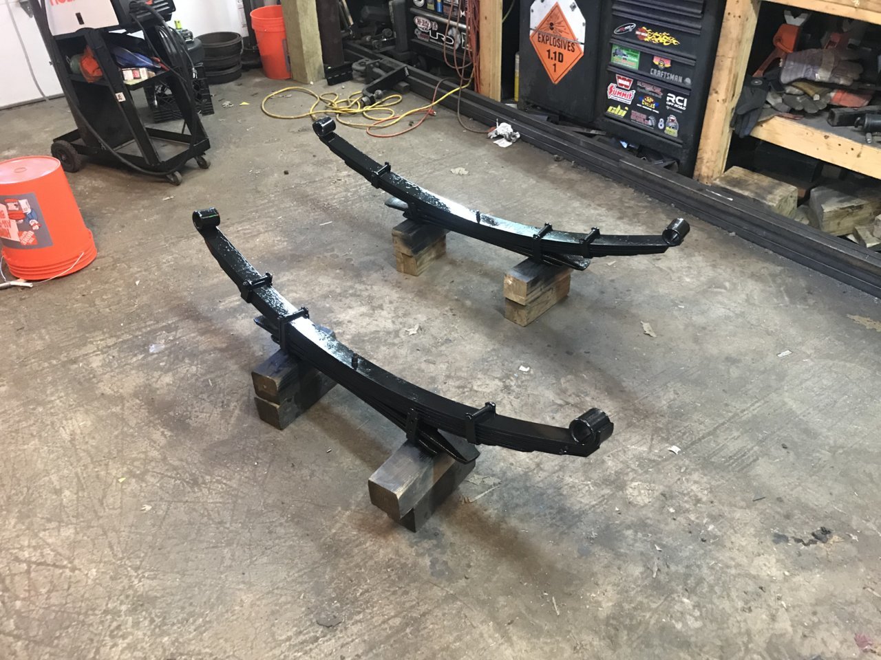

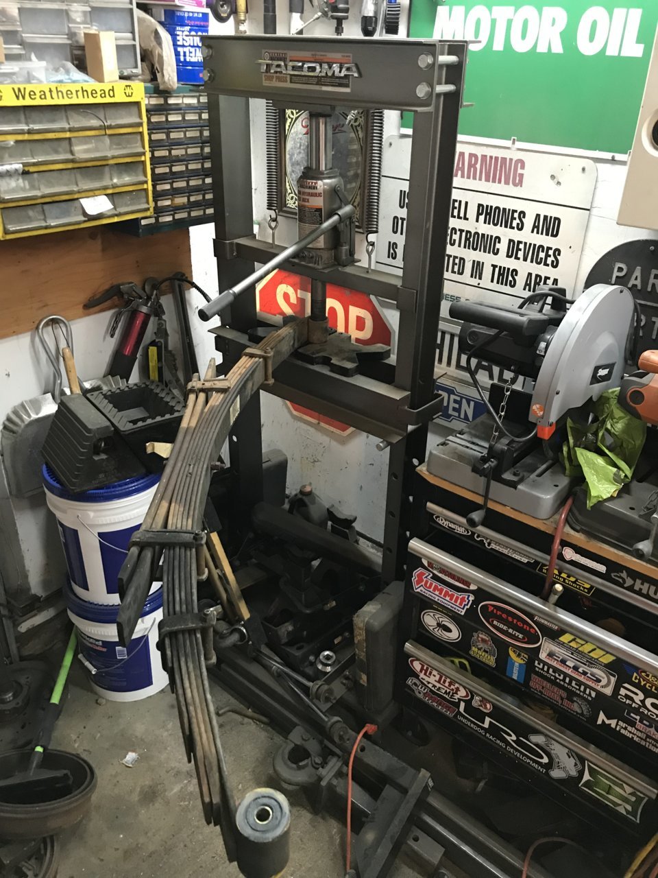

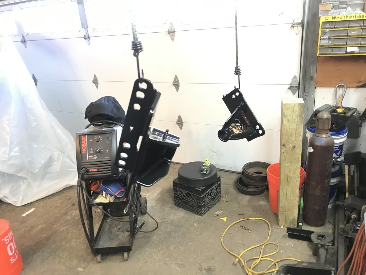

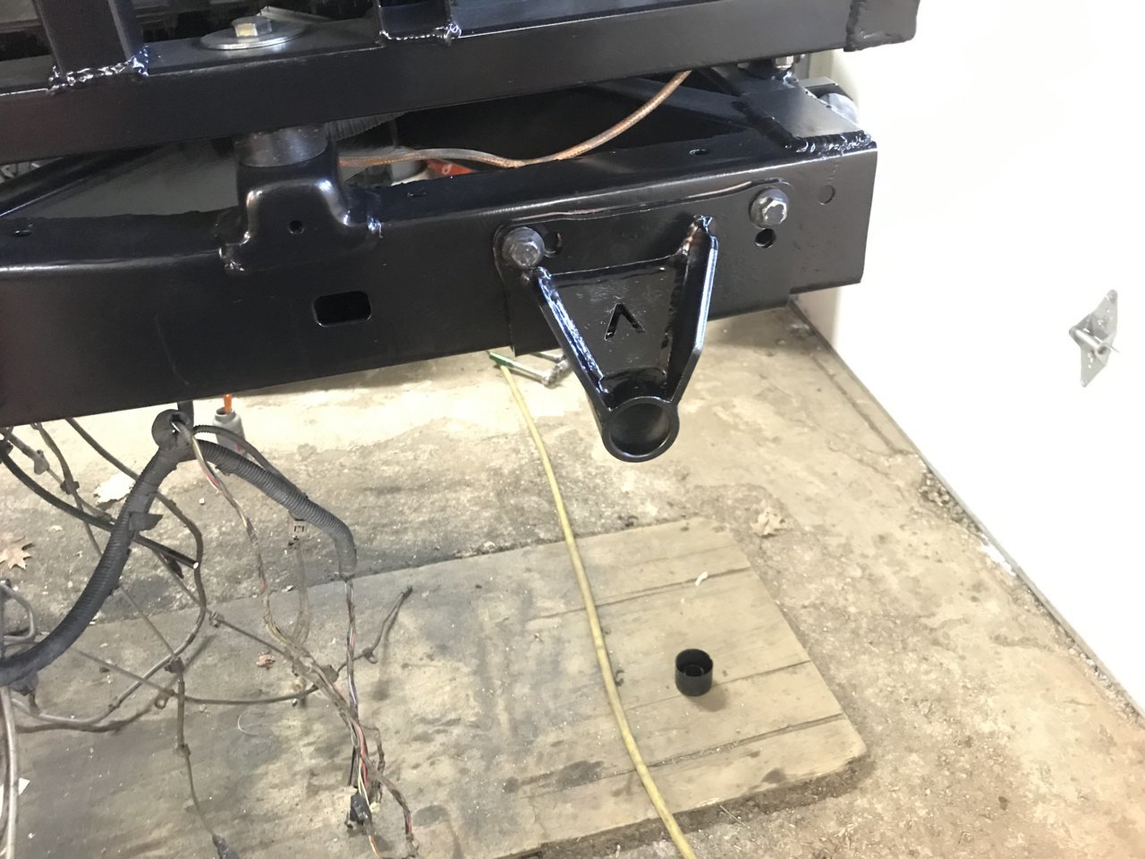

    I cleaned up and painted my Dakars and @ARCHIVE shackle flip today.
    I changed the rear Dakar bushings in October just before heading to Moab. I figured the front rubber bushings were shot as well, but I was out of time and didn’t have time to deal with pressing them out.
    I was right. They were toast. I pressed out the old rubber bushings yesterday and put new poly bushings up front too.
    I thought the shackle flip bushings were good, but discovered one was torn today. I texted Eric of Archive, and he’s shipping me replacement bushings tomorrow.

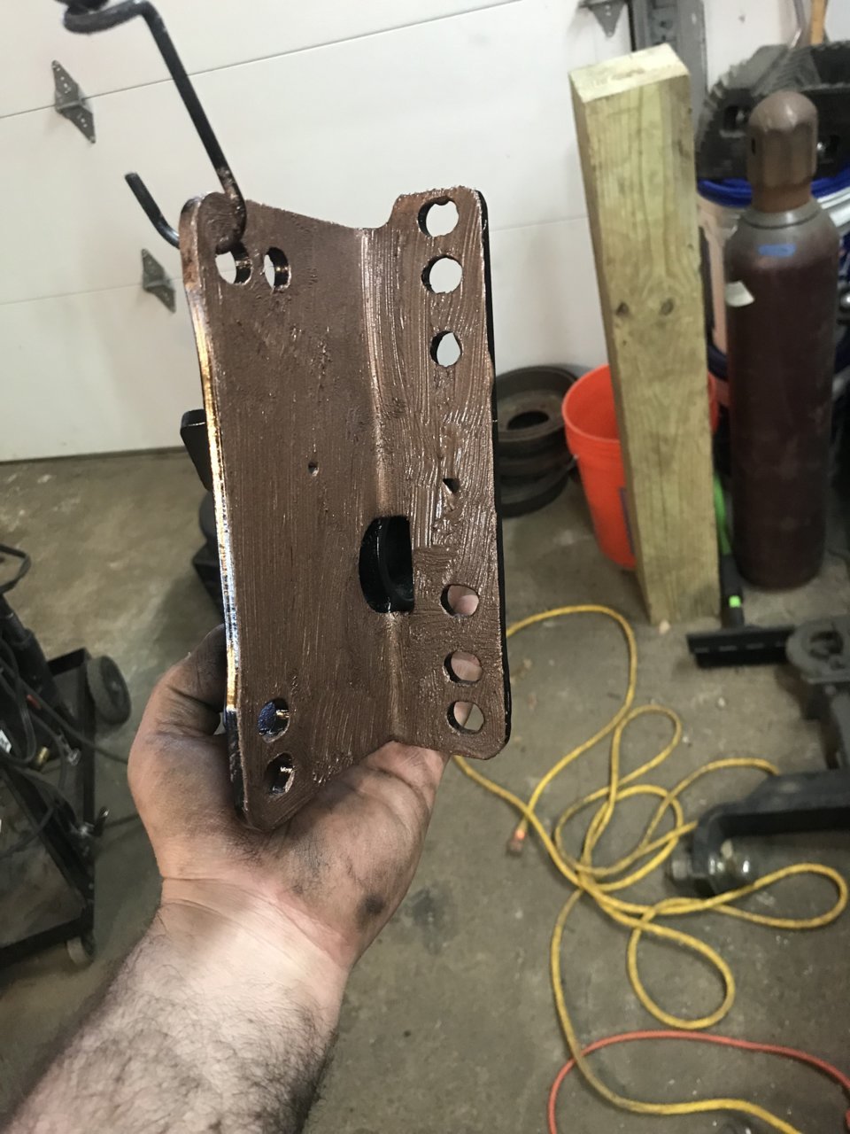

    I used @Chux ‘s idea and slathered the back side of the shackle flip brackets in anti-seize, to hopefully keep rust at bay.
