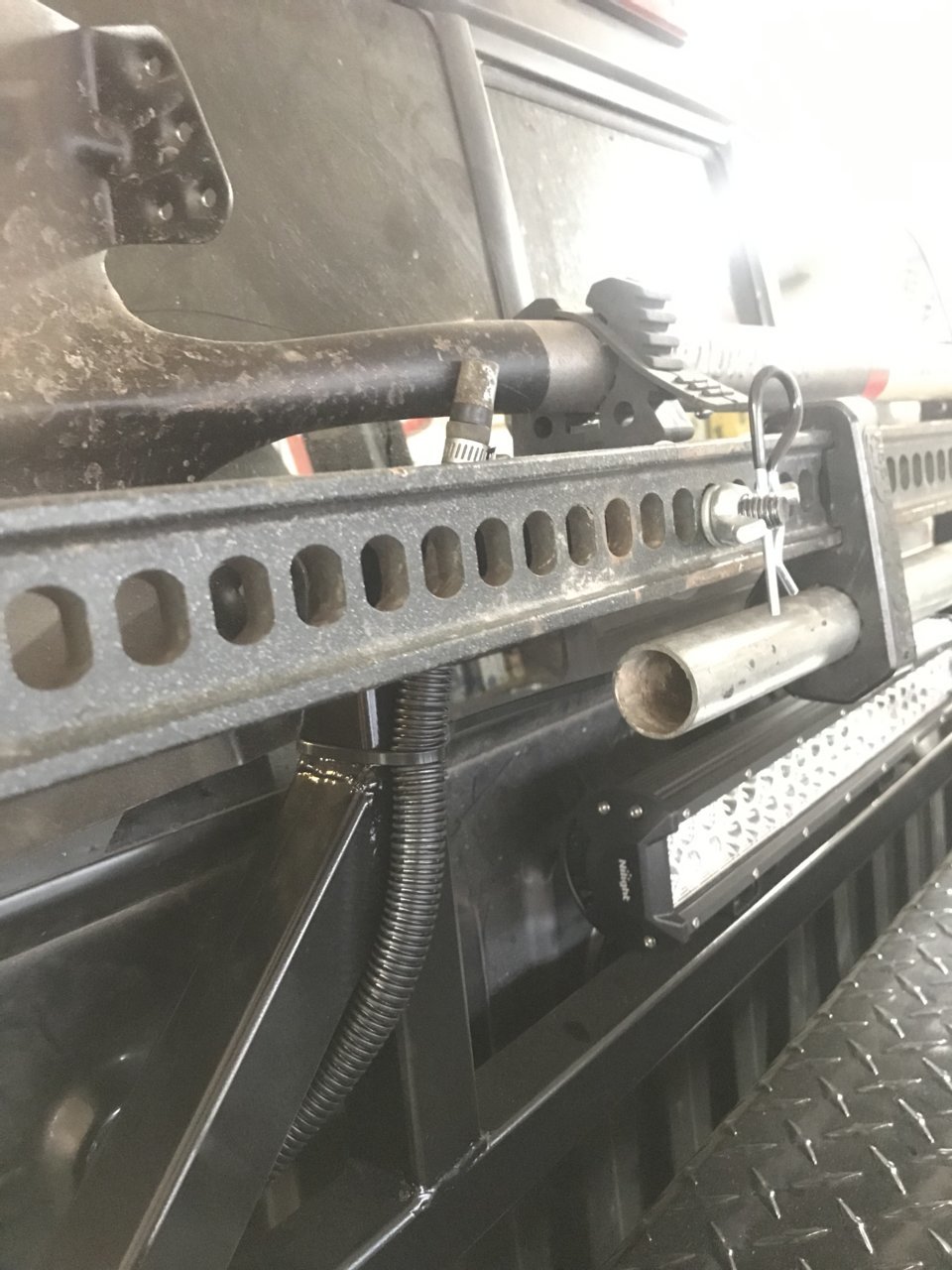

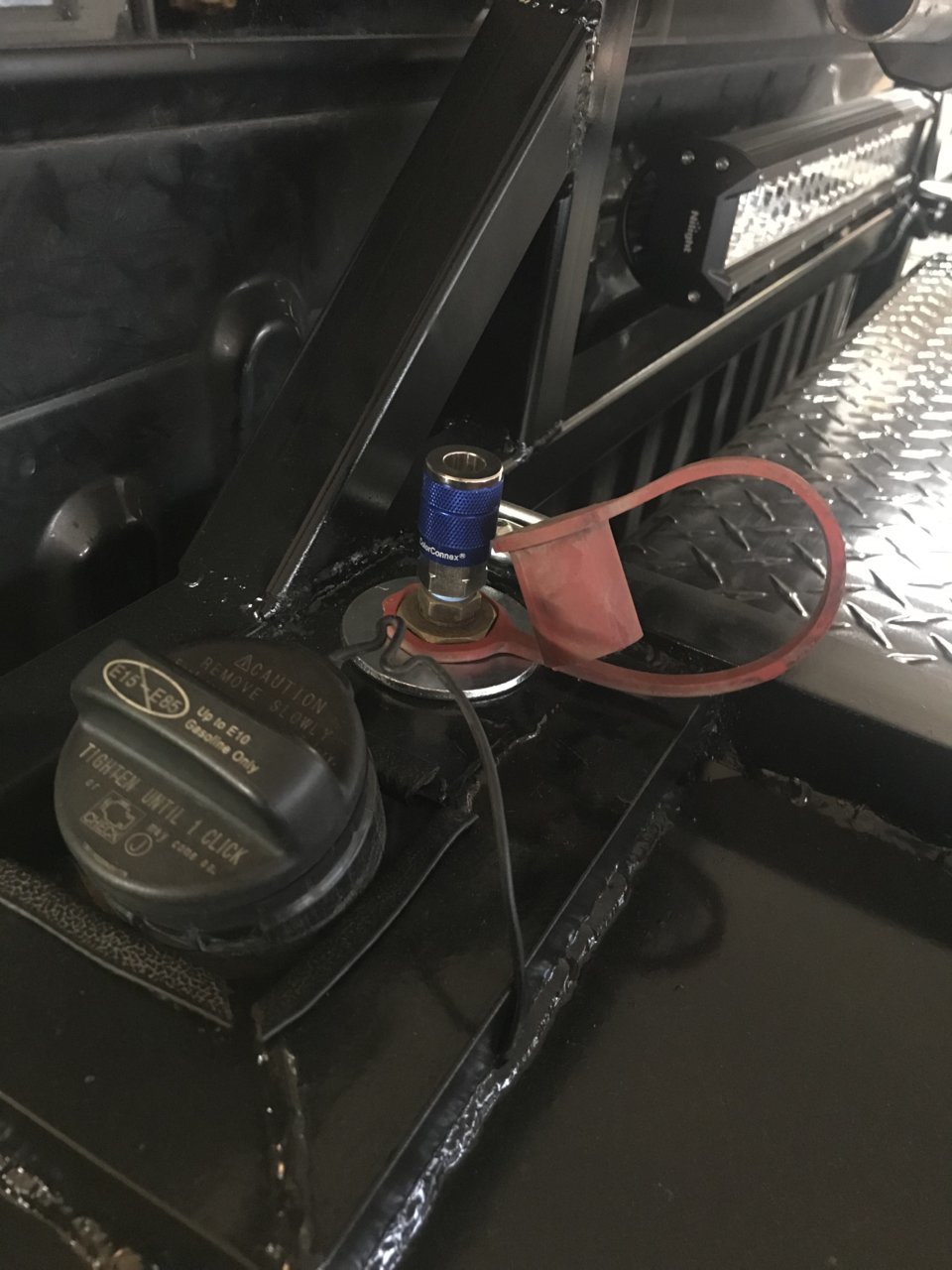

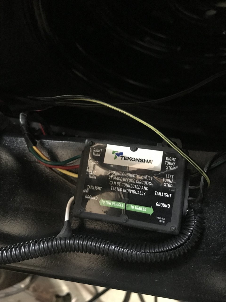

    The flatbed is 100% finished. I cleaned up the tail light wiring today. I went way back into the factory harnes and removed all the extra and duplicate wires.
    I wired up the LED bar and pods, and installed the OBA chuck.
    So, that’s another big project checked off the list.
    I had to get this converter box to change the three bulb tail light harness to a regular four wire trailer harness for the tail lights.
    Air chuck

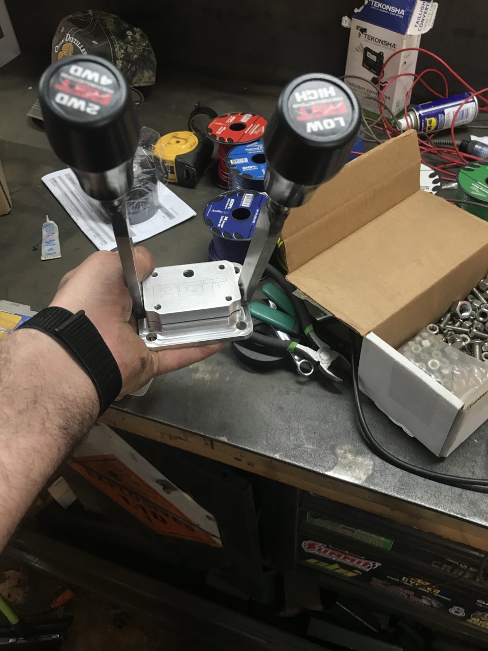

    I think I’ll tackle redoing the twin sticks next. Maybe the new master cylinder, or plumb the OX locker. (anything to put off tubbing the front...)
    These new RST sticks are MUCH nicer than the old Low Range Off-road sticks.
    It’s a shame I have to cut them up

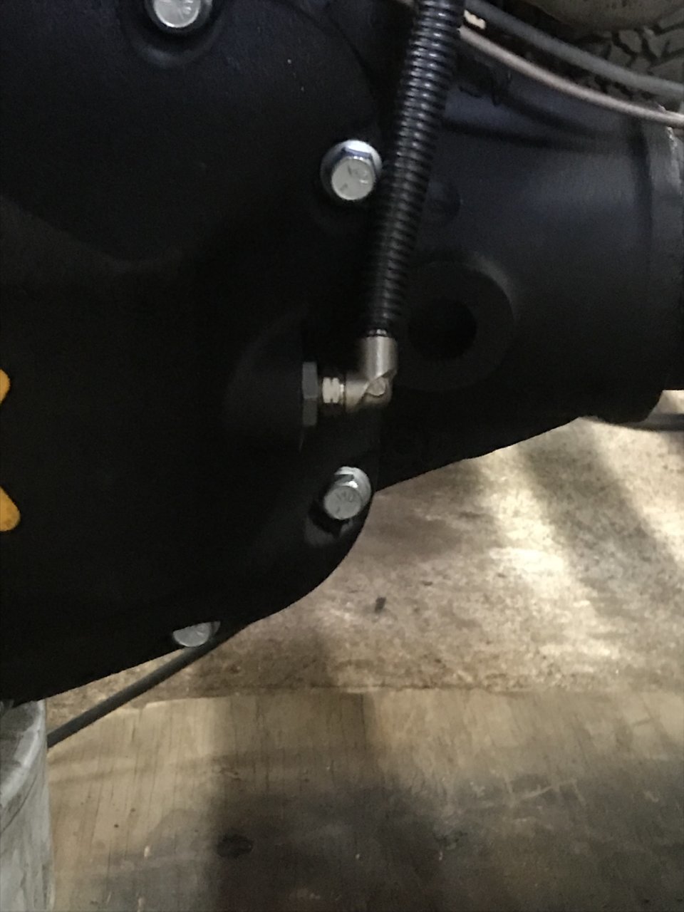

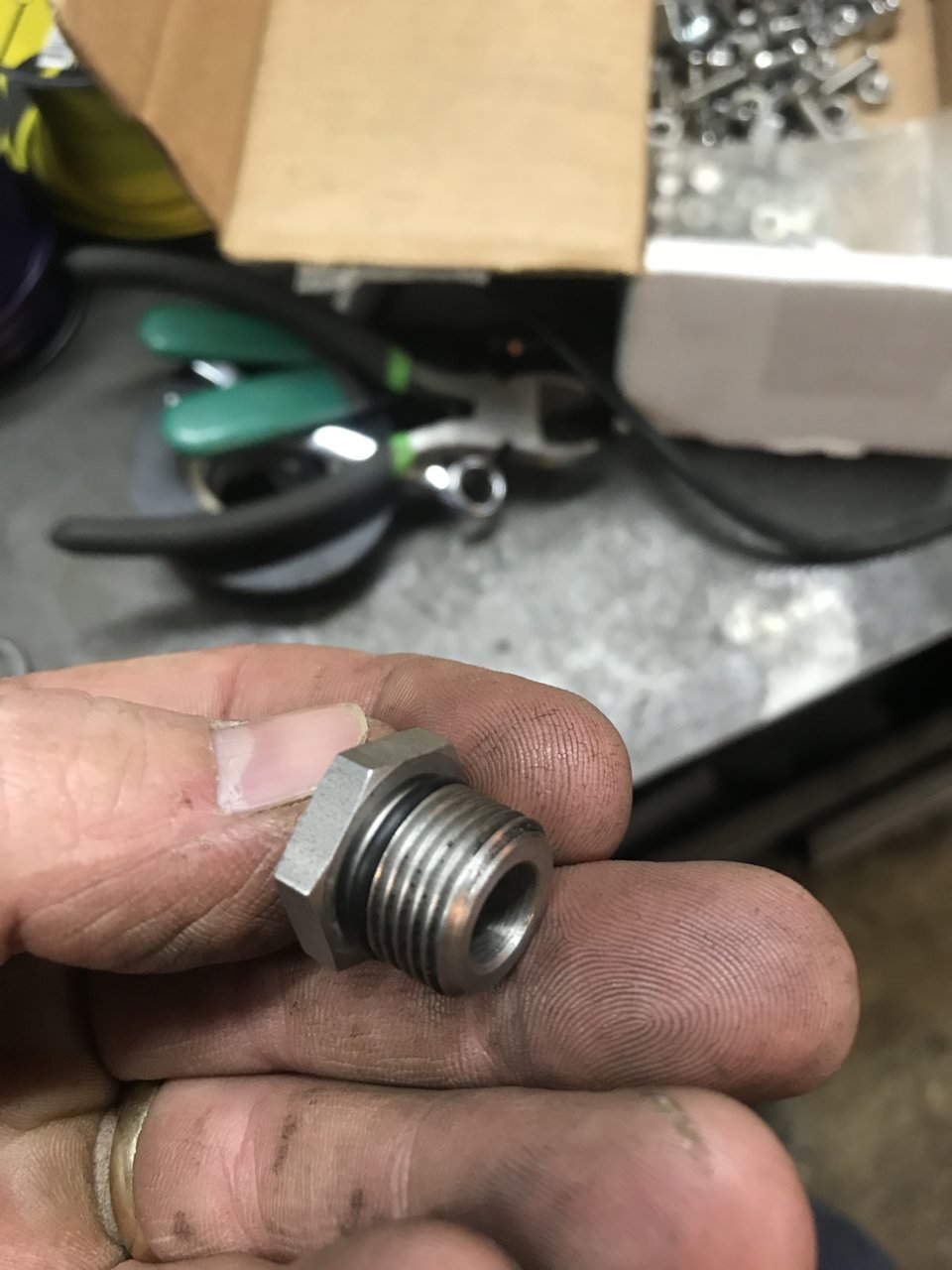

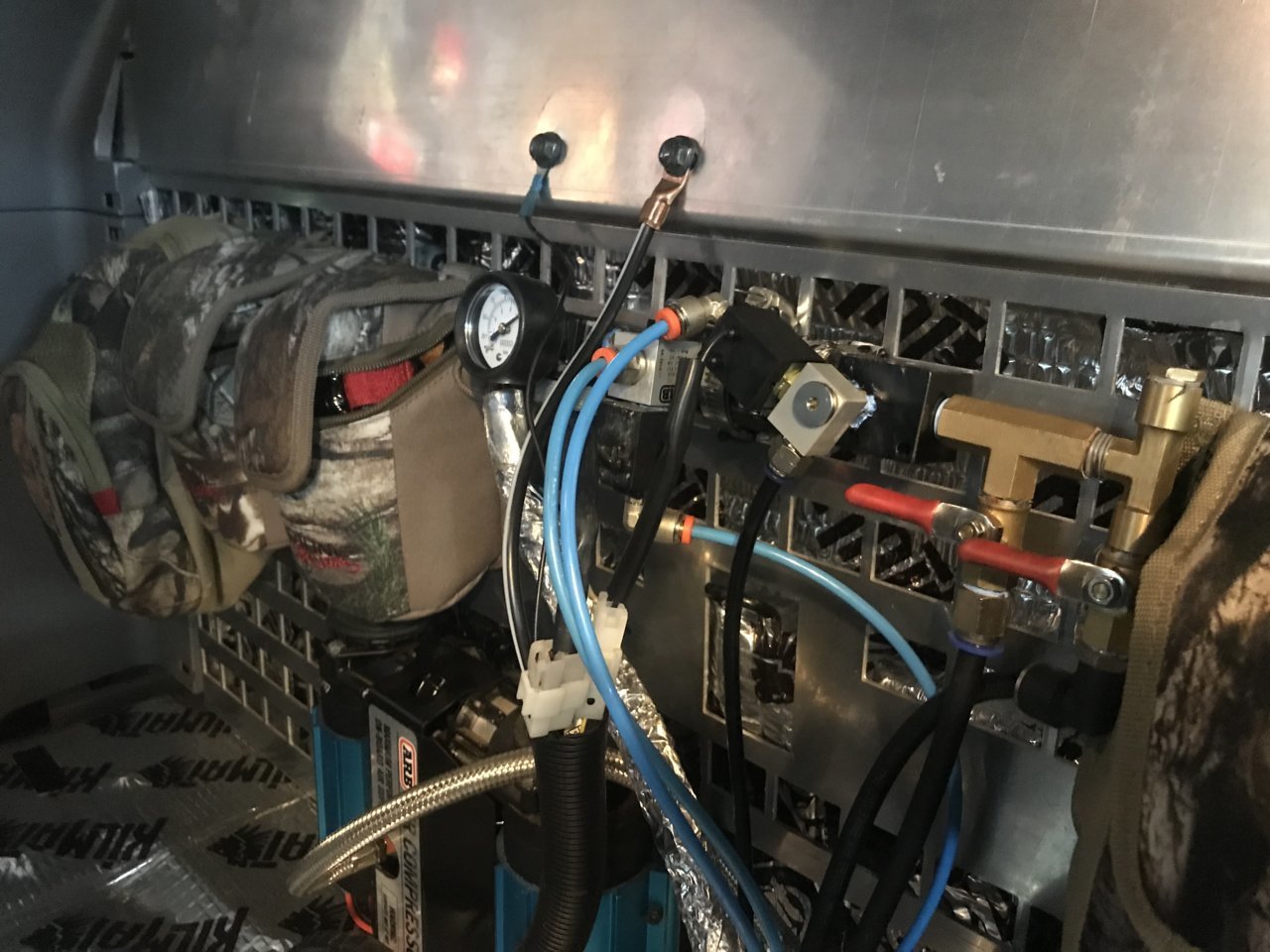

    On a good note. I did get a little more done today.
    I plumbed the OX locker today. It was really simple since I already had the ARB setup from before.
    ECGS sent a new ARB solenoid With the correct fittings for the bigger diameter air line that runs to the OX.
    As simple as removing the old solenoid, Installing the new one, re-attaching the vent line, and plugging in the new air line.
    Reducer that screws into the side of the diff cover and accepts the push lock fitting.
    All hooked up.
    I just ran the breather up and zip tied it to the Wack Rack
