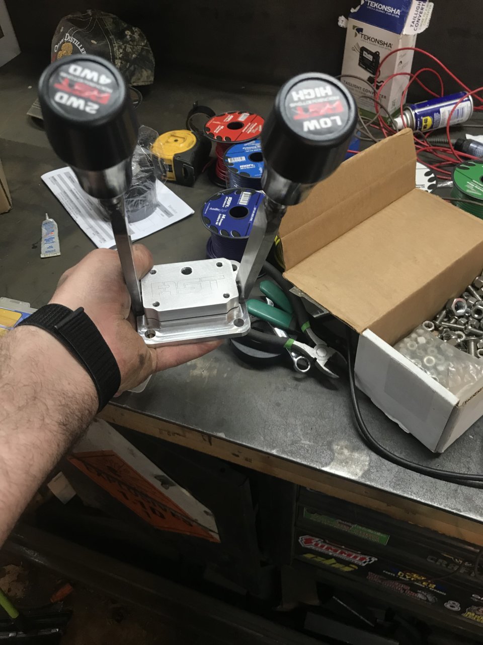

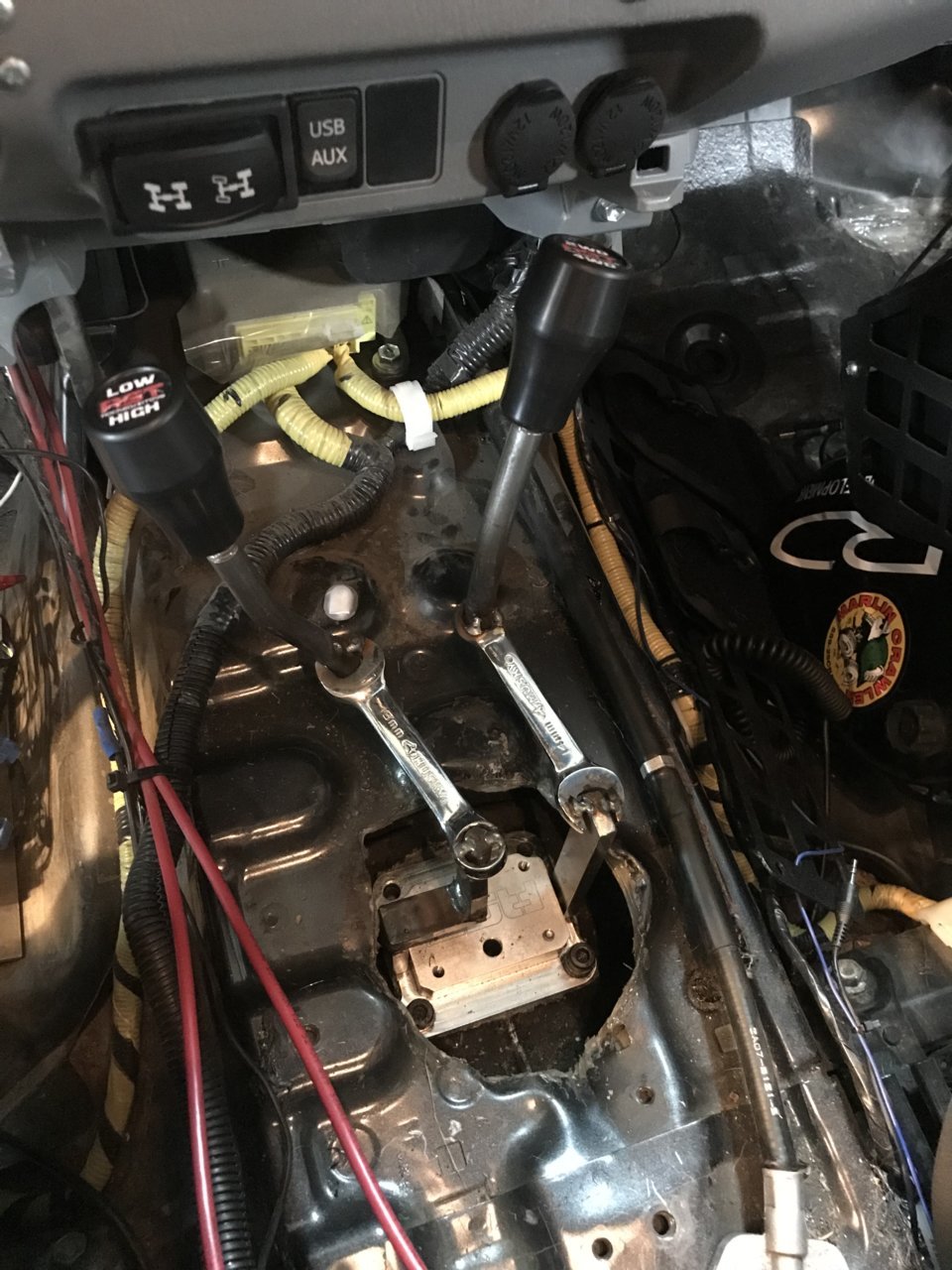

    Redid my twin sticks today. Was Tired of the crappy, leaky, ripped boot, Low Range sticks.
    RST came out with their own sticks. Much nicer superior design.
    The new sticks.

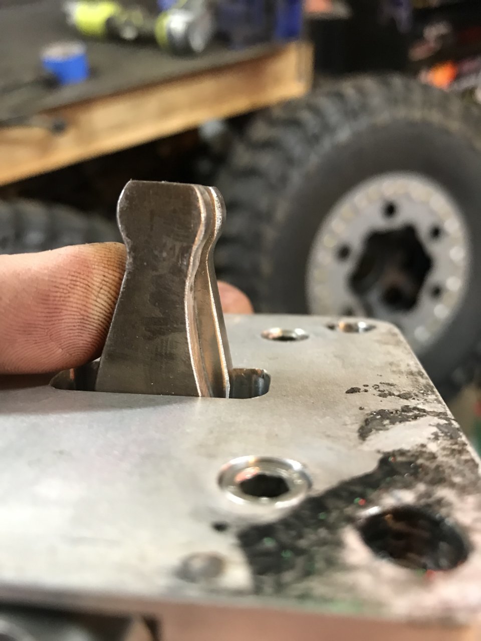

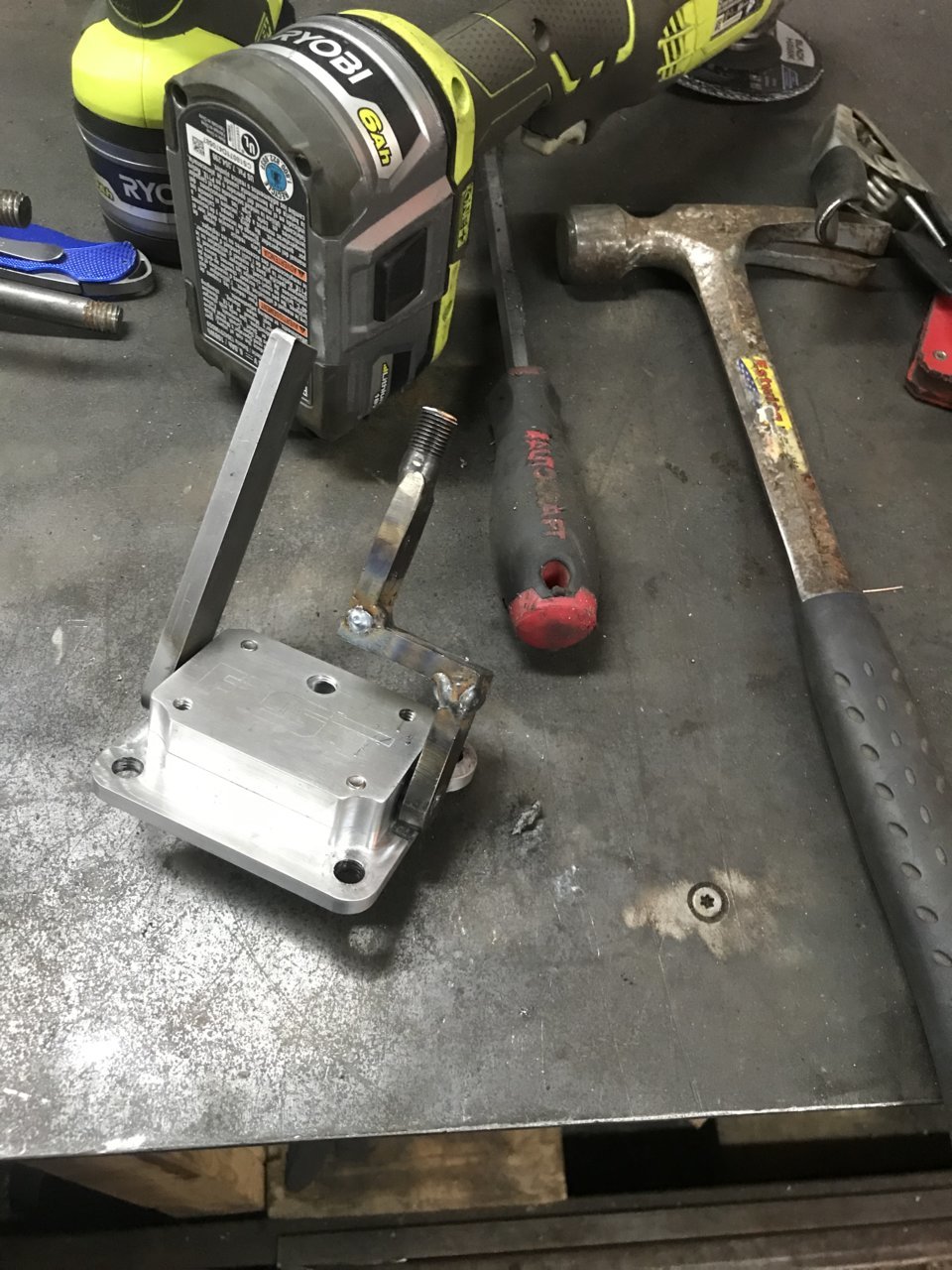

    Unfortunately, the H/L shifter would not shift into low range. I realized that the shift nub was too wide and binding up, stopping travel. You gotta love taking a grinder to a brand new $300 part...

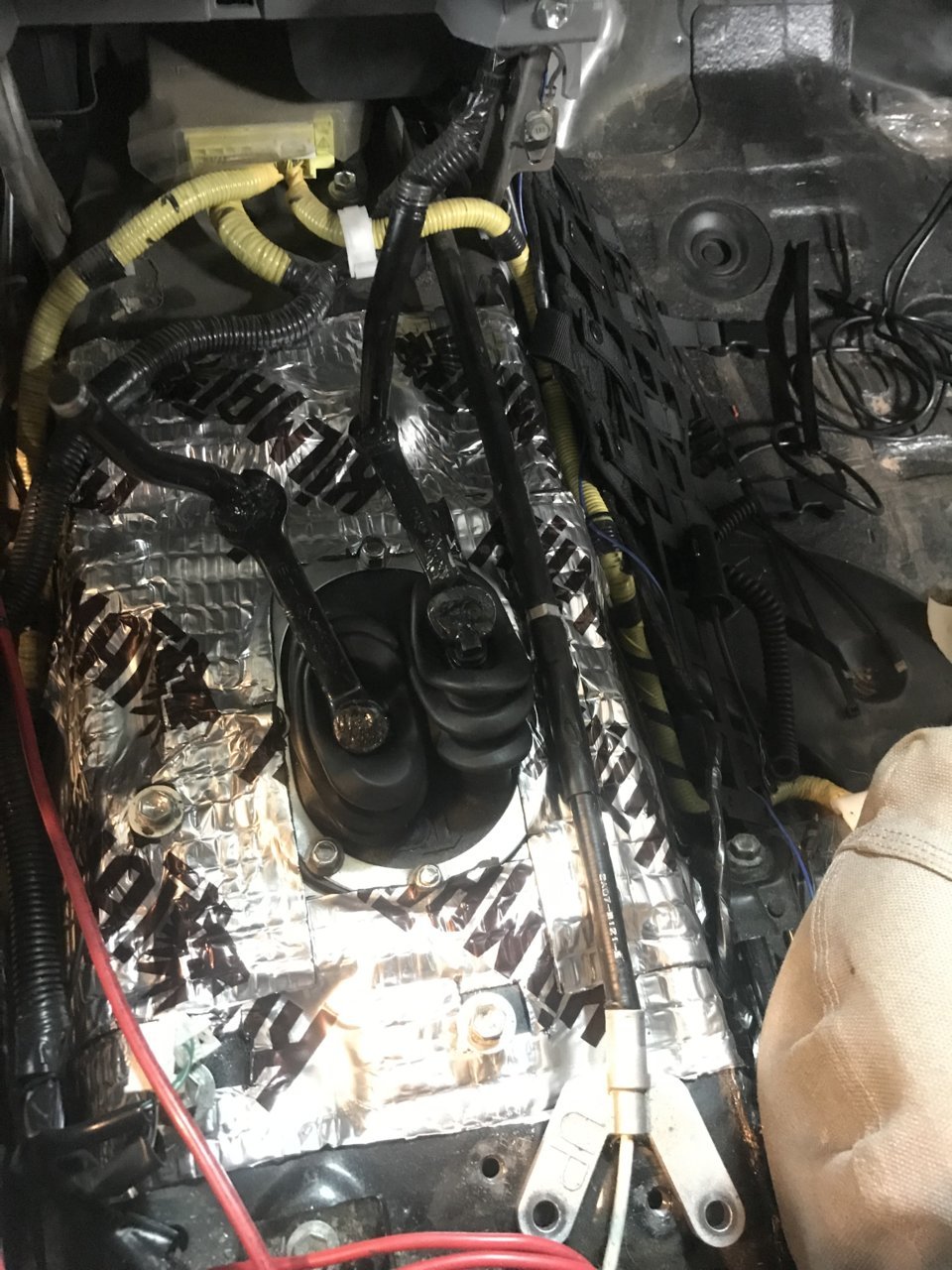

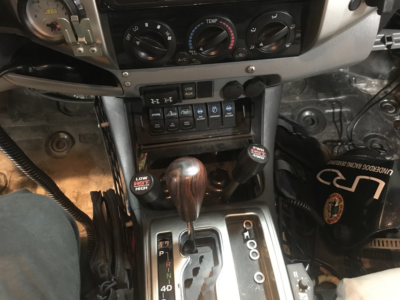

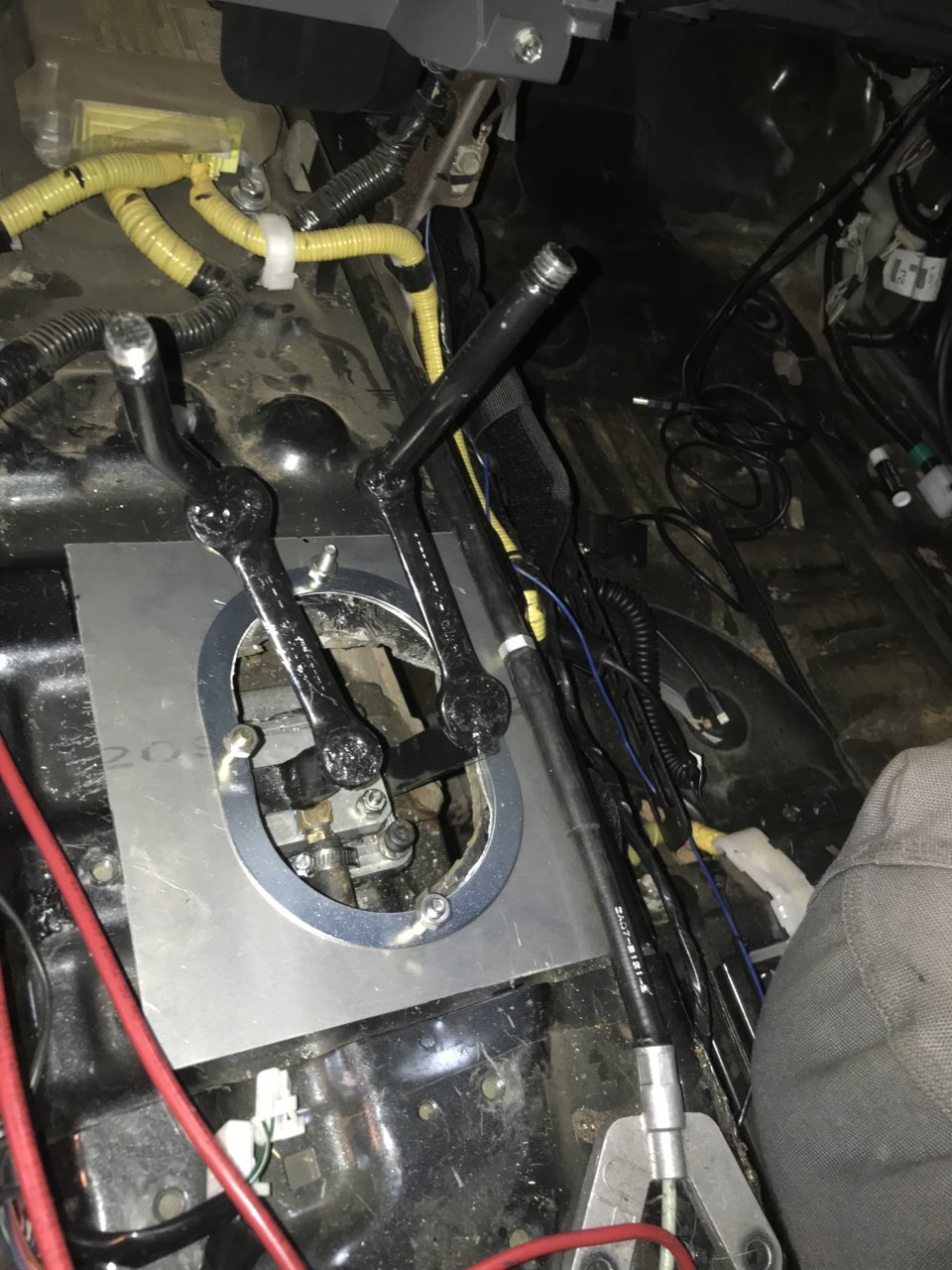

    I was thinking about moving the twin sticks over to the “coin slot” next to the auto shifter, but I liked them where they were. I put them back up front.

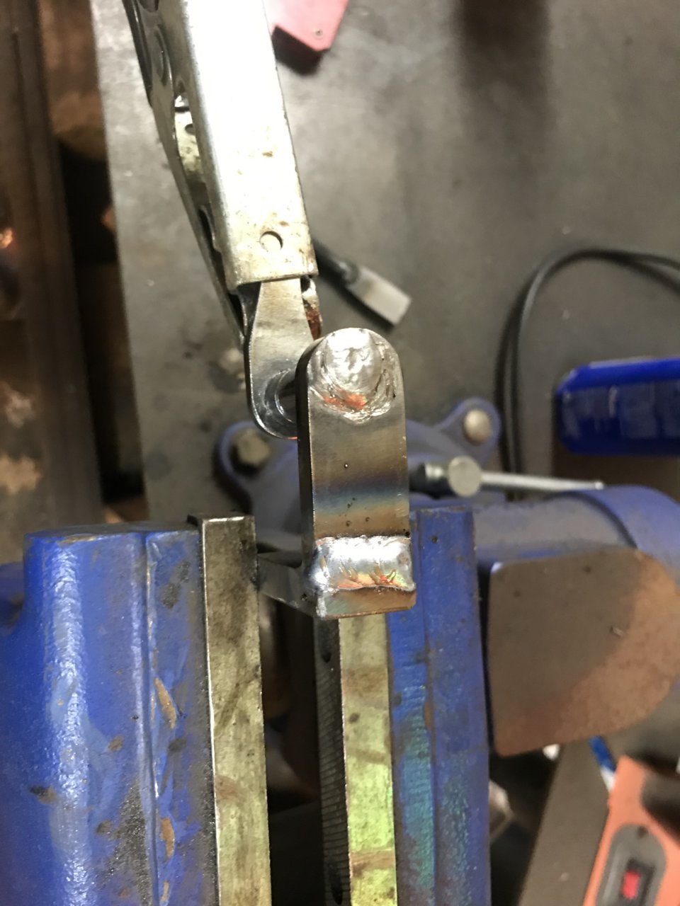

    I did place them better this time around. It helps when you’re doing the job yourself. The last time, I hadn’t started welding yet. I had to con the yard guy at work into doing it for me. It came out fine, but the shift knobs didn’t end up exactly where I wanted them. They were too close to the auto shifter to use the big RST shift knobs. I ended up giving them to @stairgod and using the smaller ones that come with the Low Range sticks.

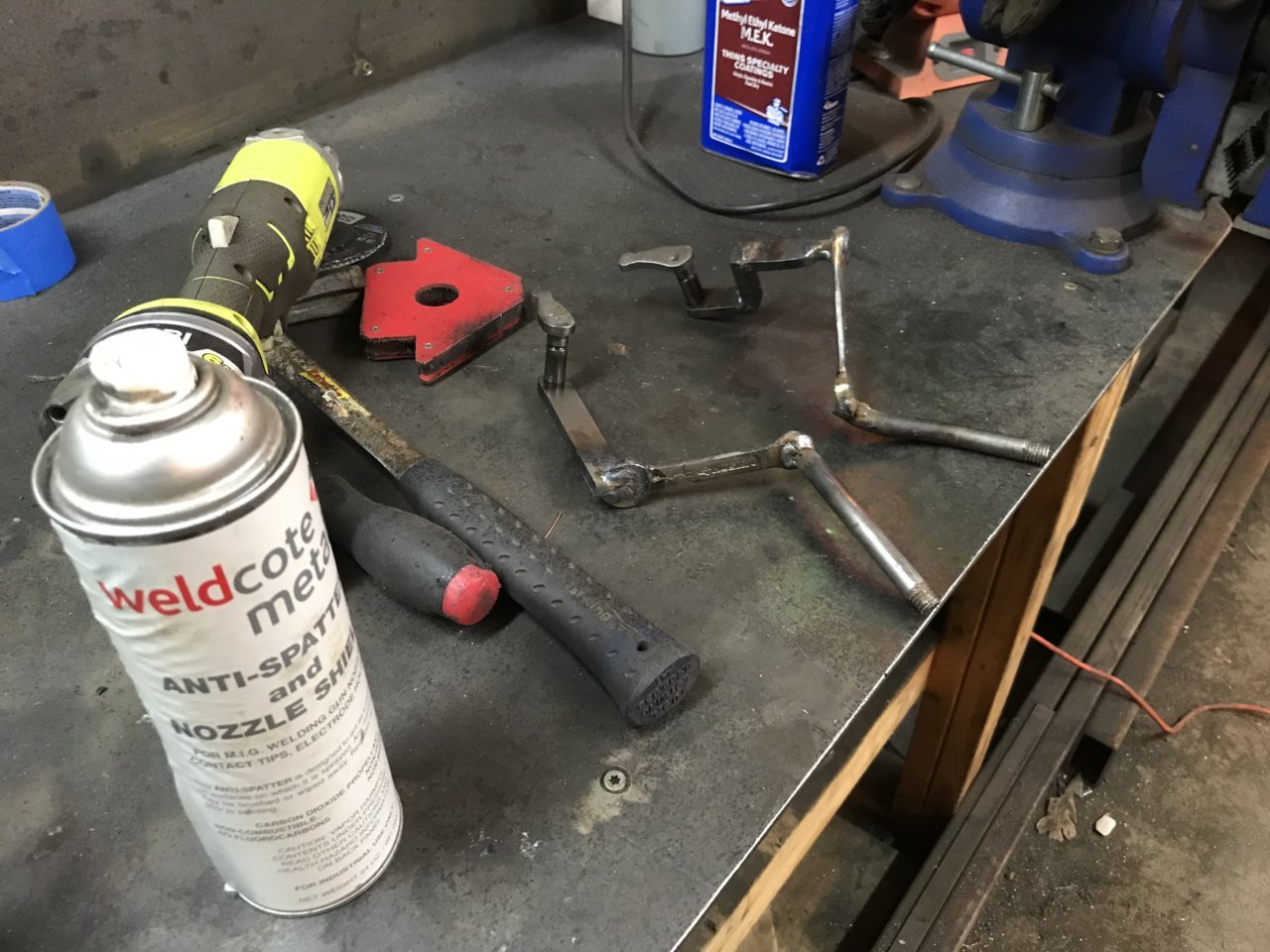

    Those old, leaky, annoying, Low Range sticks did come in handy. I cut the bent shift handles off and used them to get the new knobs where I needed them to be.
    These RST sticks aren’t any shorter throw than the old Low Range ones. I’m a little disappointed about that. (See video)

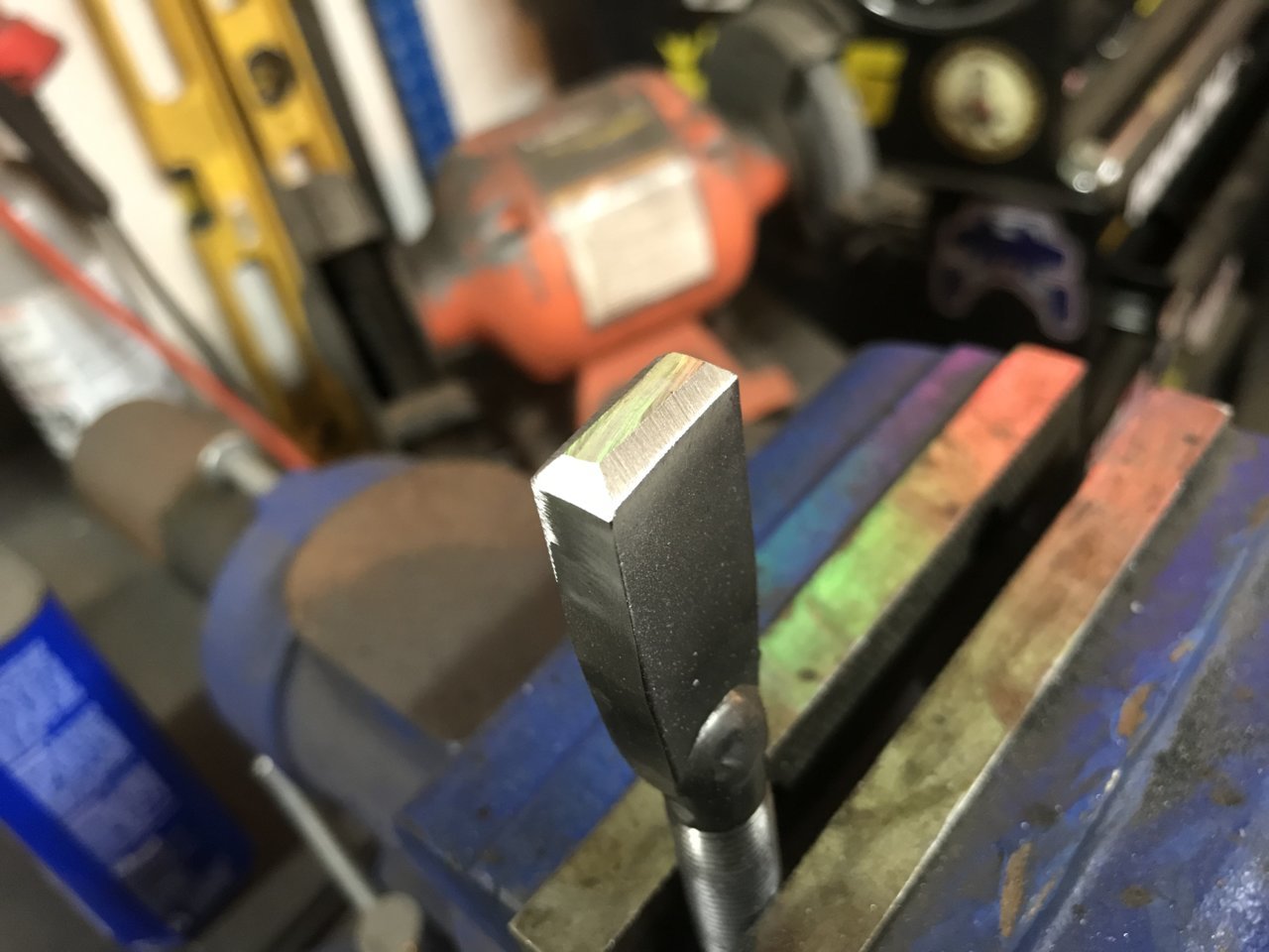

    I put a nice deep bevel on all the flat parts.
    Anti spatter to keep the moving parts from getting burnt up. Especially the O-ring grooves.

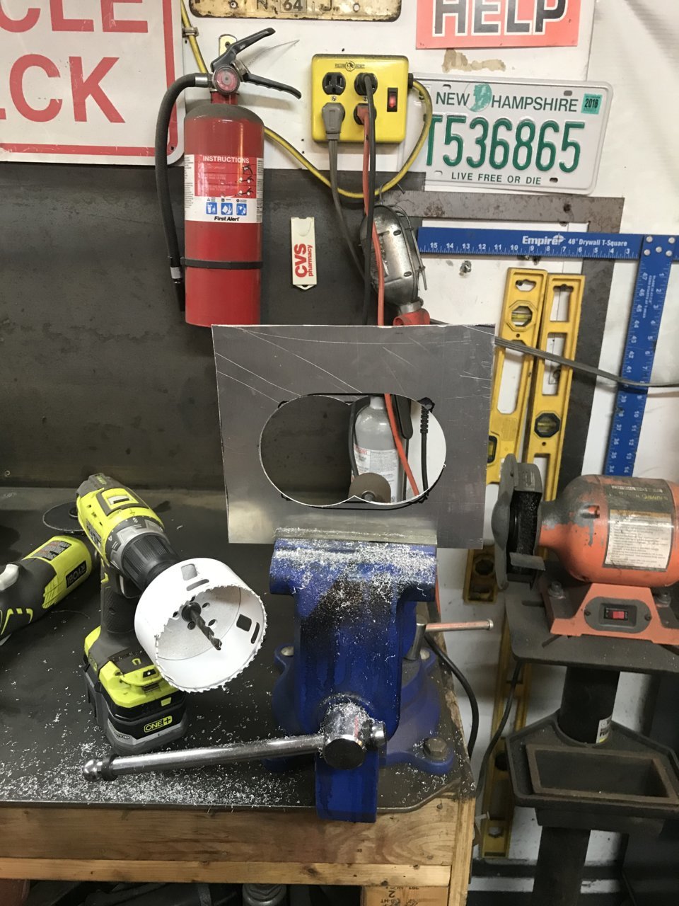

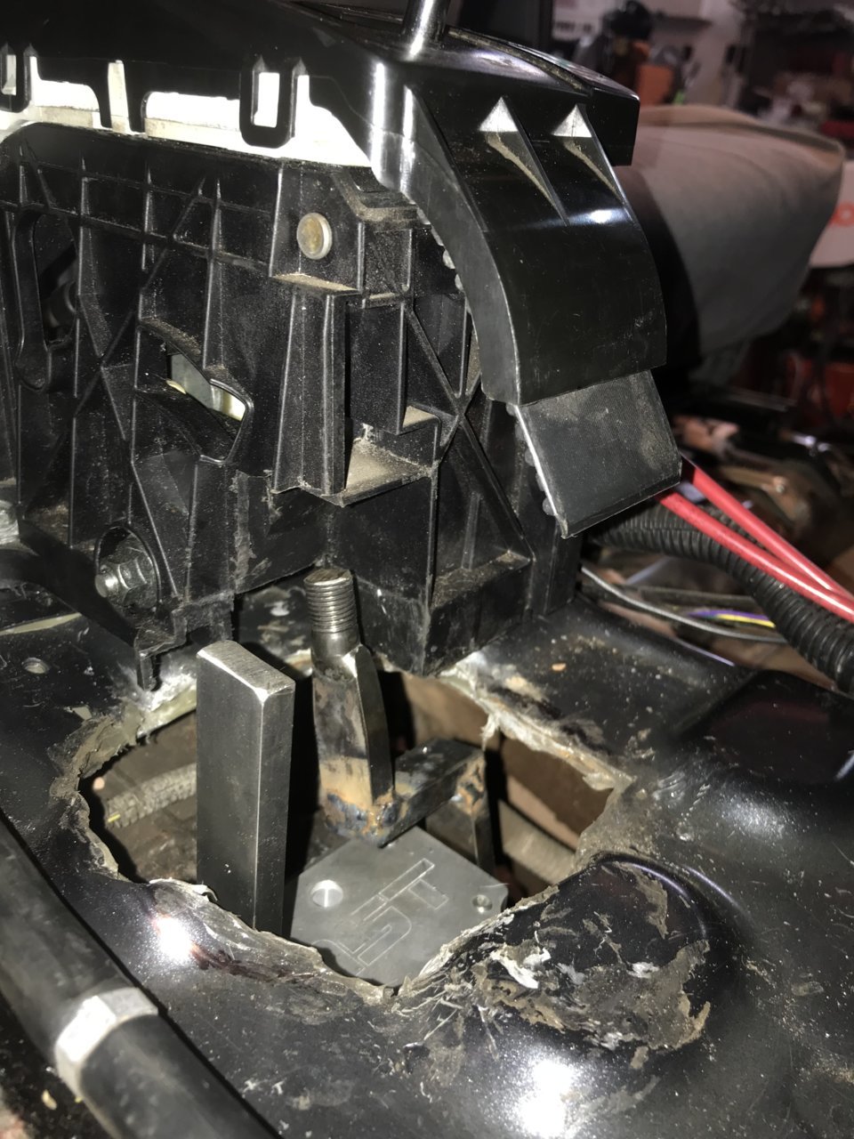

    I had to move the H/L stick inboard to clear the auto shifter tower. I had clearanced it heavily prior for the old sticks. I don’t think you can cut anymore away from the tower without hitting important parts...

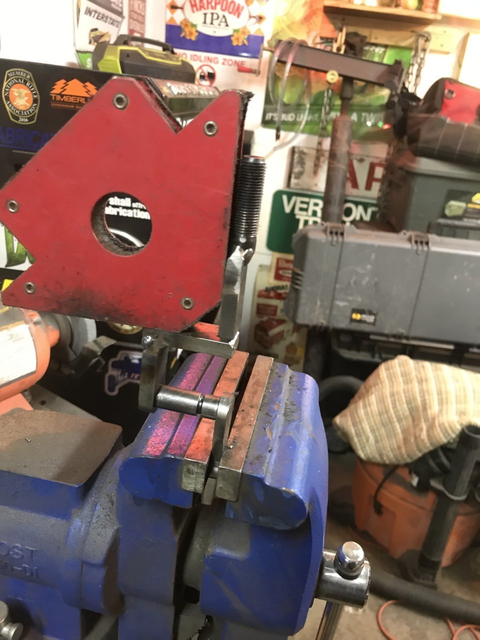

    Stubby wrenches are perfect extensions for this location. Just tacked here.
    Fully welded

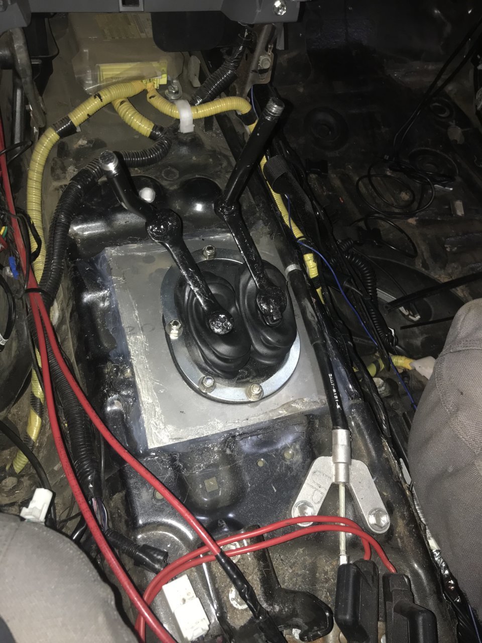

    As you can see here, the H/L sticks arc takes up all of the available space in the cubby. I had to clock the wrench, and place the curved stick in just the right spot to work. Luckily, I don’t have carpet in my truck, so I felt comfortable tacking the shifters together in place.
    https://youtu.be/WPv37cwYO6A
    It’s been a couple of hours now. I haven’t seen any smoke... I think it’s safe to call it a day and go inside. I’ll tackle final assembly and floor sealing tomorrow.
    NYCO, Chux, Grand dude and 4 others like this.

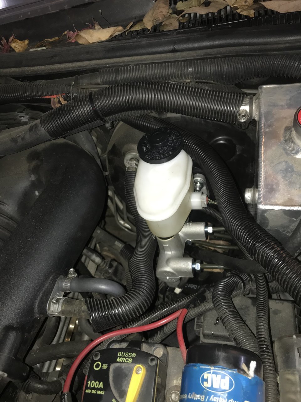

    Sequoia master Cylinder installed

    Just curious, how fun was swapping the master cylinder in? Have one waiting to go in the RC, when I get that far down the list.
    Currently in the middle of rebuilding the rear axle and it's rear wheel bearing time. About to fab up a tool, but figured maybe you or @stairgod may have whipped one up already?

    Thanks Mojo.

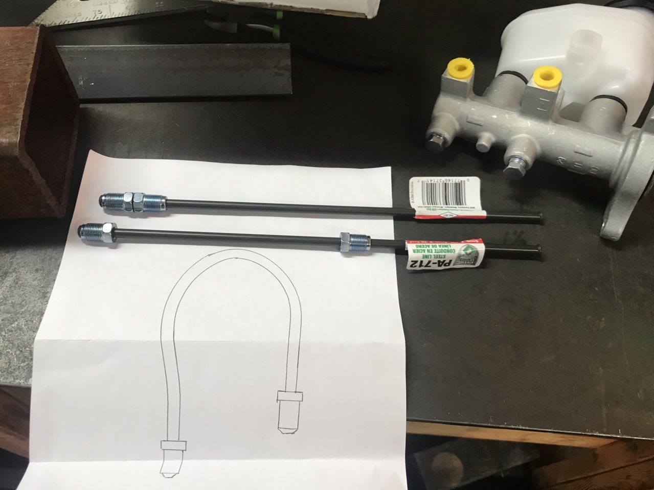

    The MC wasn’t too bad. The SOS kit comes with the firewall adapter plate, and the push rod adapter / extension.
    Worst part was bending the brake lines that attach the old lines to the MC.
    If you look on their site, it clearly shows pre-bent lines with the kit. This is what you get...

    wow thats somewhat irritating on the brake line part. at least they give you a diagram to follow
