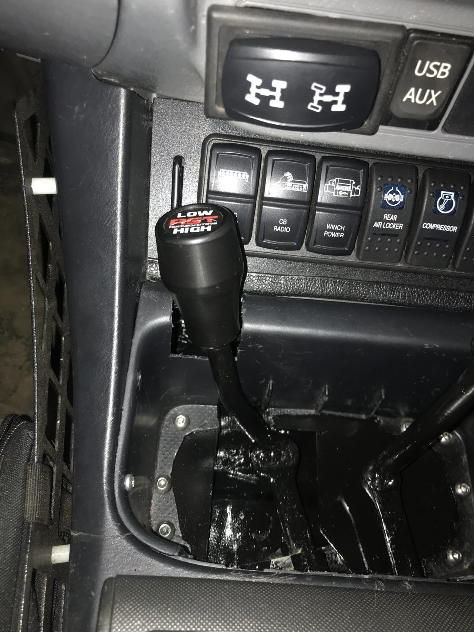

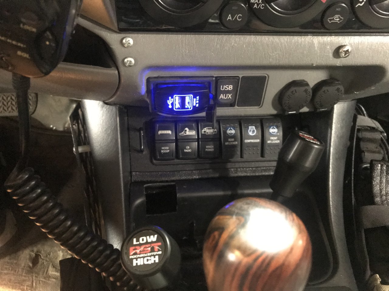

    Well... I have the flu. Work on the truck has stopped for a couple of days.
    This was all I could muster for today. You can see the rocker switch that used to control my ADD in the top of the first pic.
    It’s just been a dead switch filling a hole since I did the FJ tube (ADD delete). So I threw a double USB deal in there.

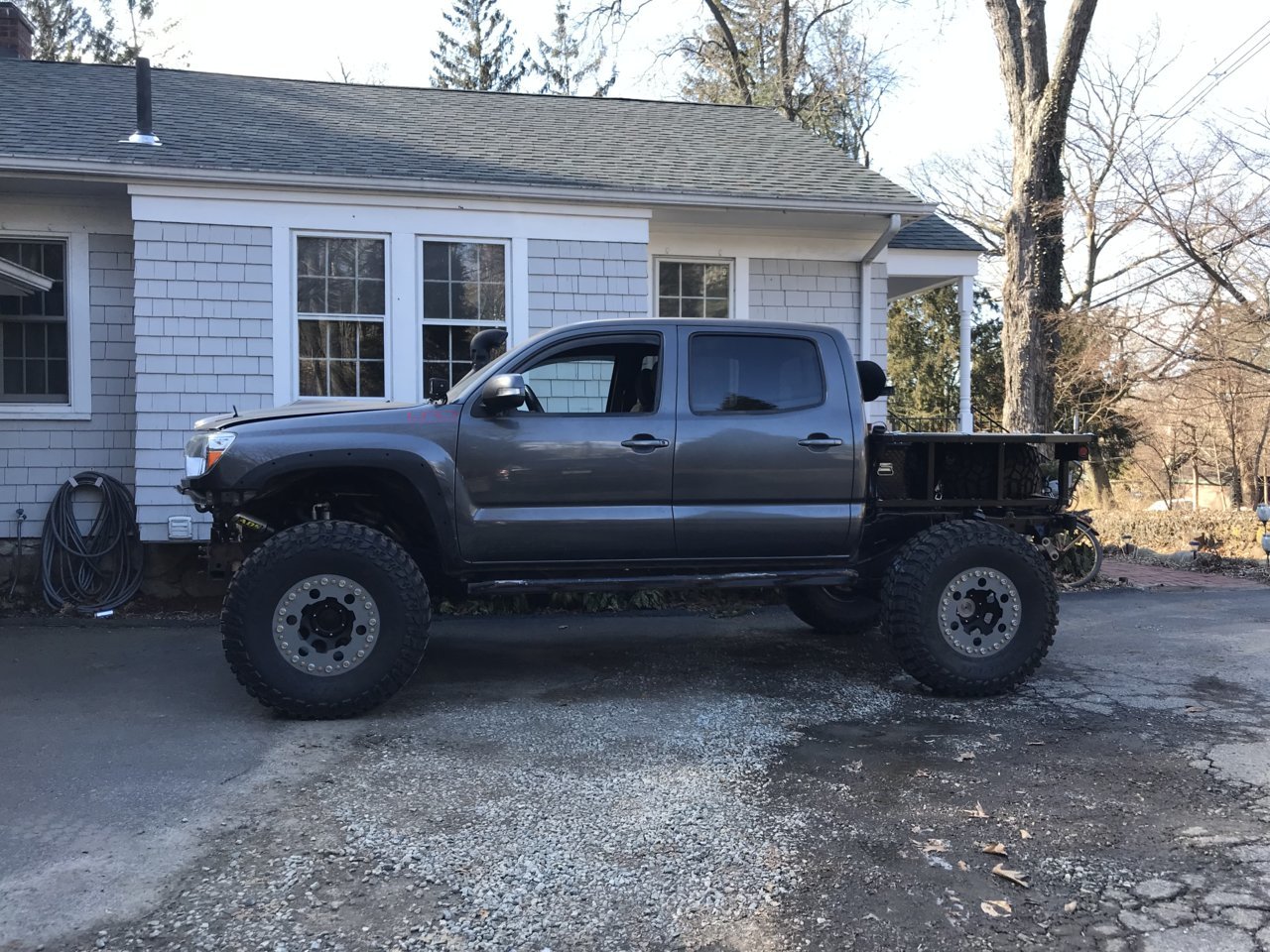

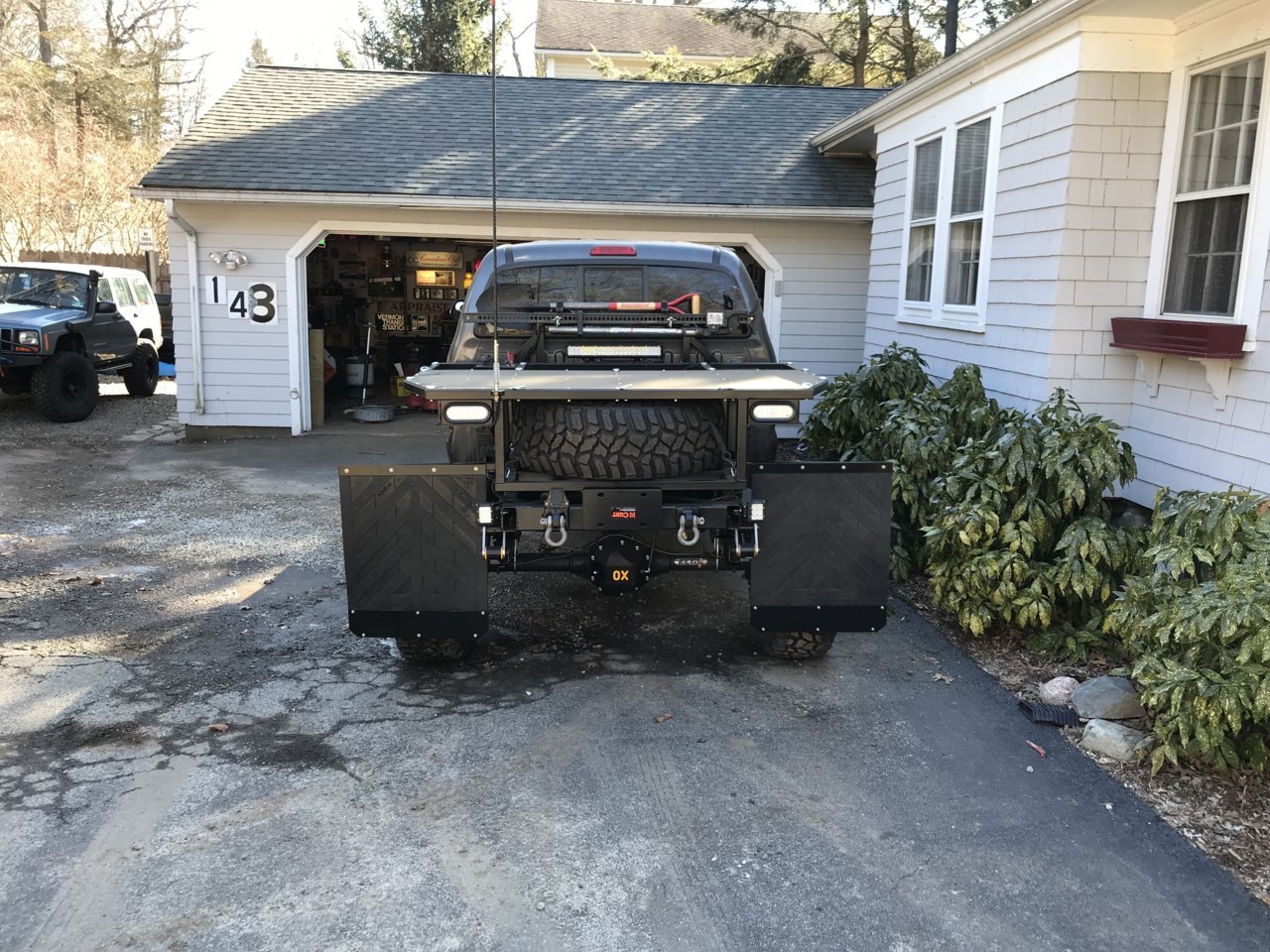

    Outside for the first time since Oct.
    And... it still fits

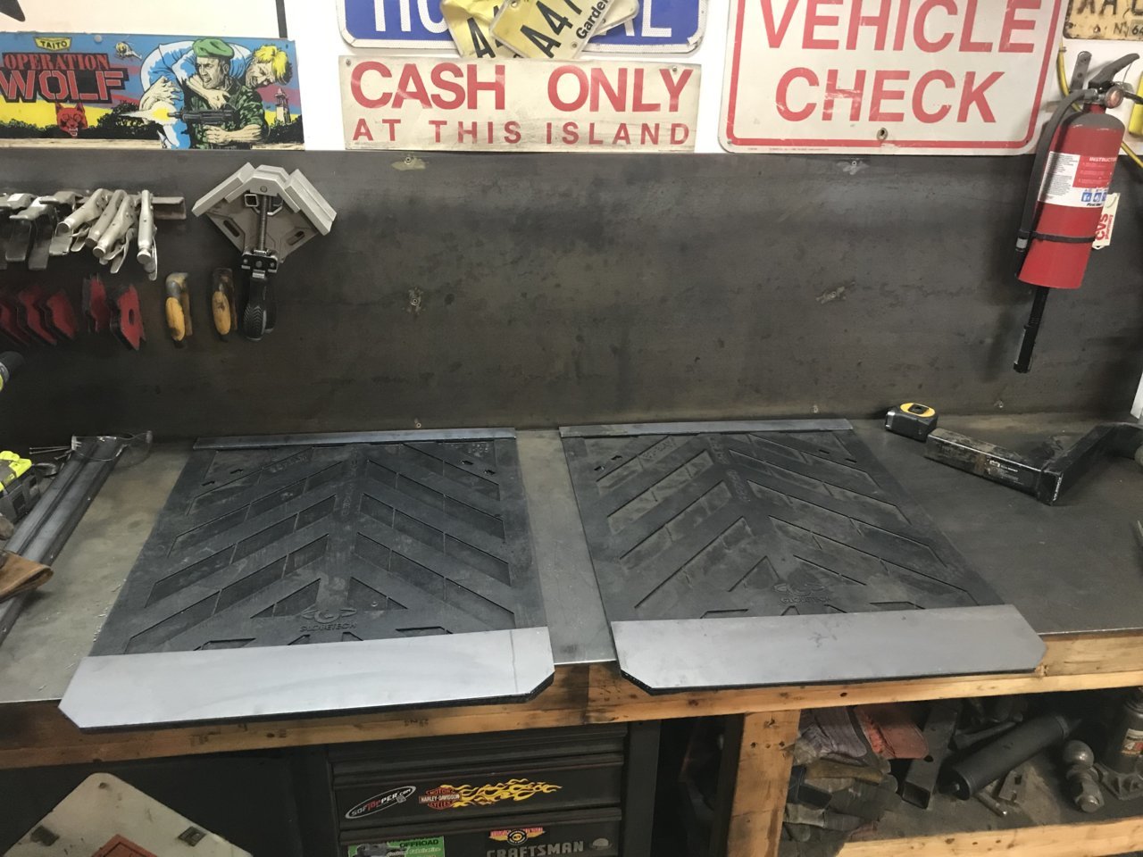

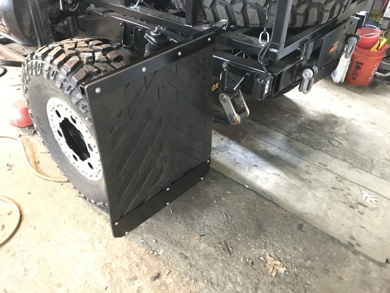

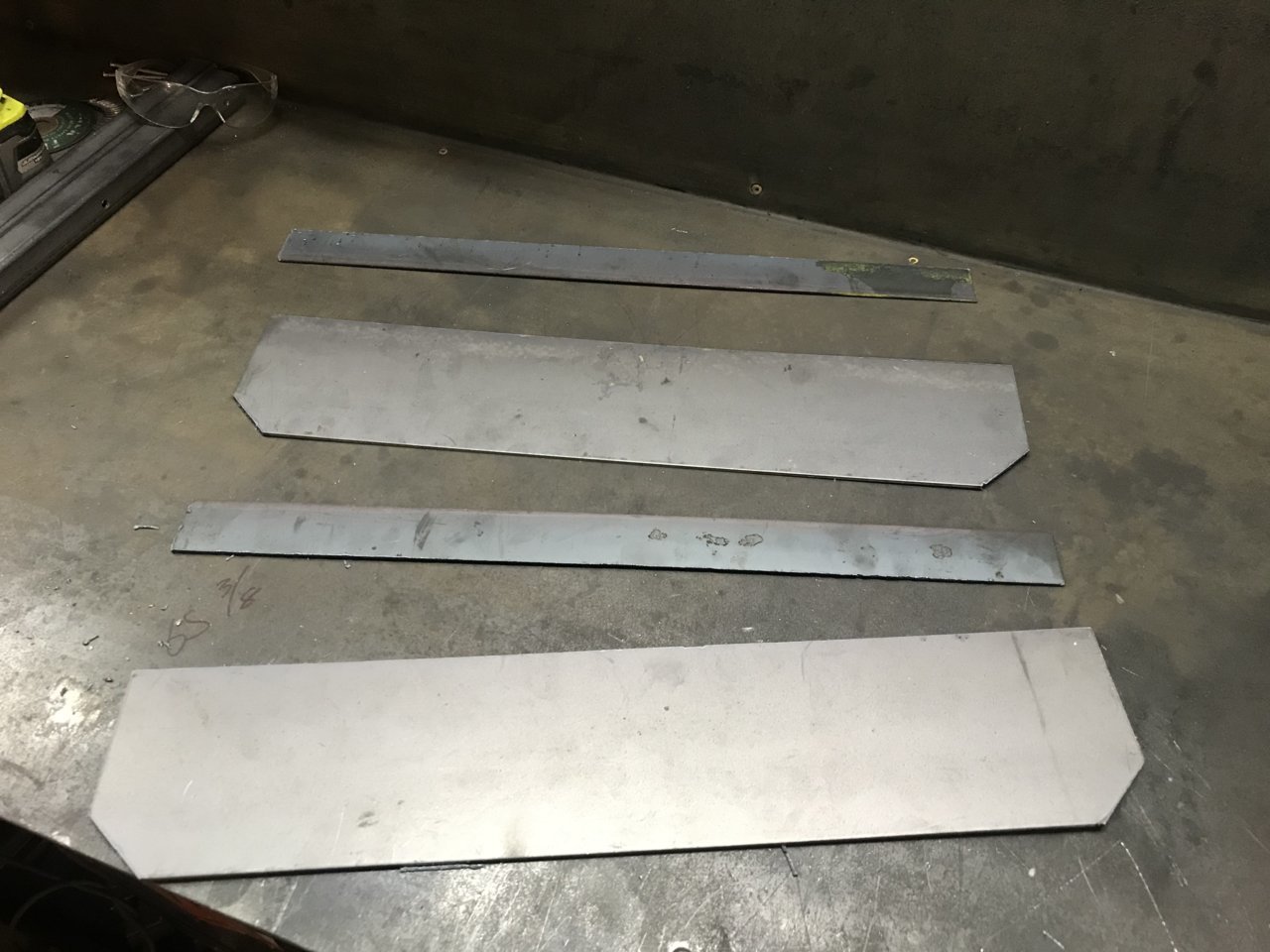

    I remade the removable mud flaps. The mounts are 1.5” square tube. I bought some 1.25” square tube to mount the flaps on.
    I also cut out some upper pinch plates and lower weights.
    I don’t love the look of the mud flaps TBH, but it is what it is. They don’t look as dumb in person. Jon, my friend? Has taken to calling them “Dumbo Flaps”.
    Although it doesn’t look like it if viewed from the center of the truck, the flaps are centered on the tires.

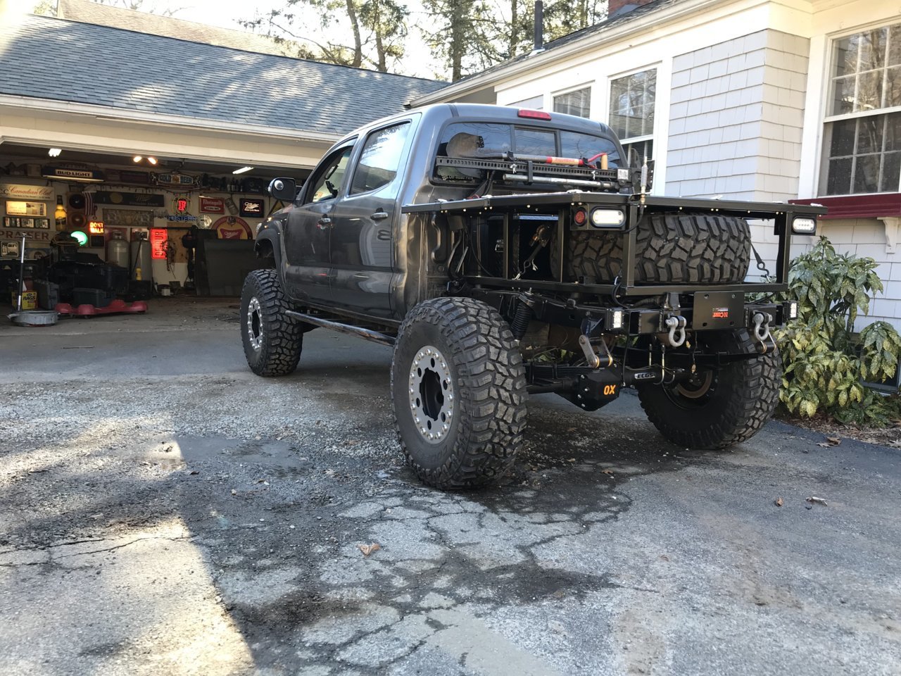

    Yeah, the flat bed was built for the trail. The flaps will get me there without attracting too much attention from the fuzz. Hopefully.
    Blackout14 likes this.
